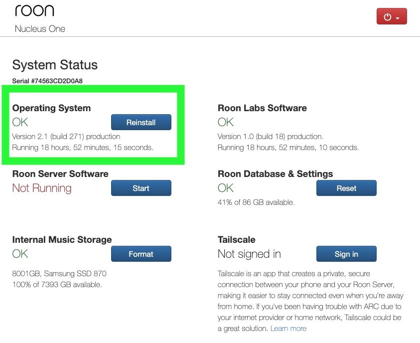

  1. Stop the Roon Server from the WebUI.
  2. Reinstall the Roon Server software.
  3. Rename the Database folder before restarting, so Roon creates a completely clean library.
If a brand new, clean library becomes corrupted again, this would strongly suggest an underlying hardware issue, most likely a failing drive.
Thank you Vadim, when you say “Reinstall the Roon Server software”, I assume you mean clicking the Reinstall button for the Roon OS:
Please confirm.

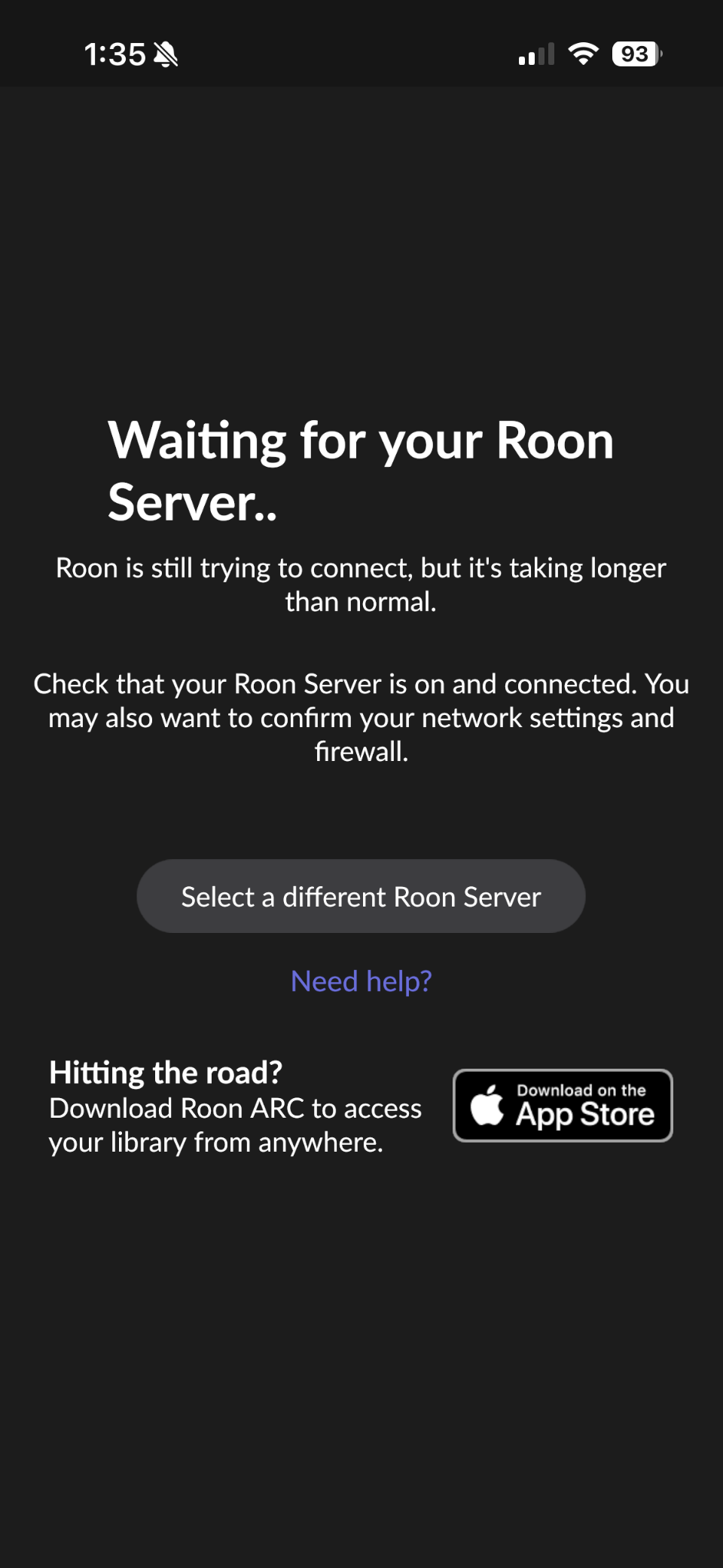

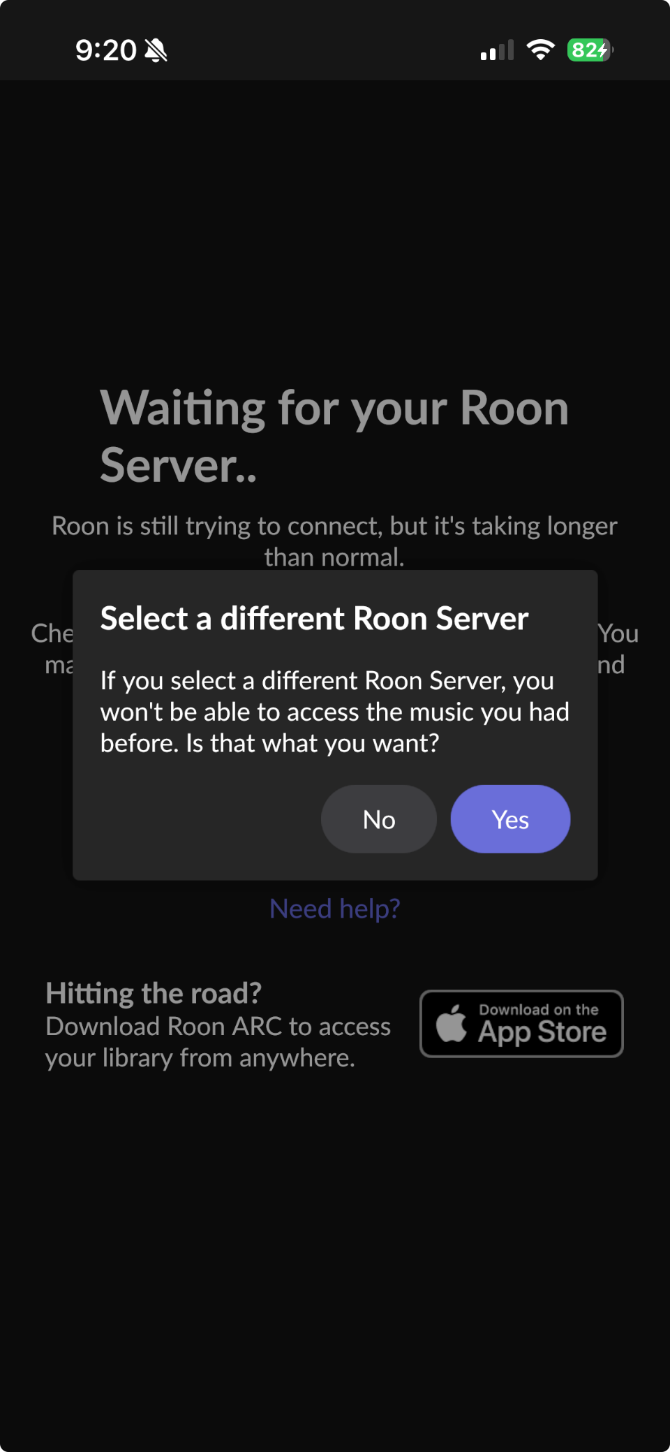

12 hours later… this is the message i get when i try to launch roon:
What happens when you touch the “Select a different Roon Server” button?

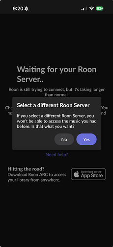

A dialogue box pops up:
I was working under the impression that stopping Roon Server, renaming the database, and then restarting Roon Server would create a clean database and then rebuild my library.
There was no mention of this scenario / need to connect to a “different” server.
So try touching the Yes button and then see what happens… If you’ve reinstalled the Roon operating system, the Roon client may still be looking for the “old” Roon Server…

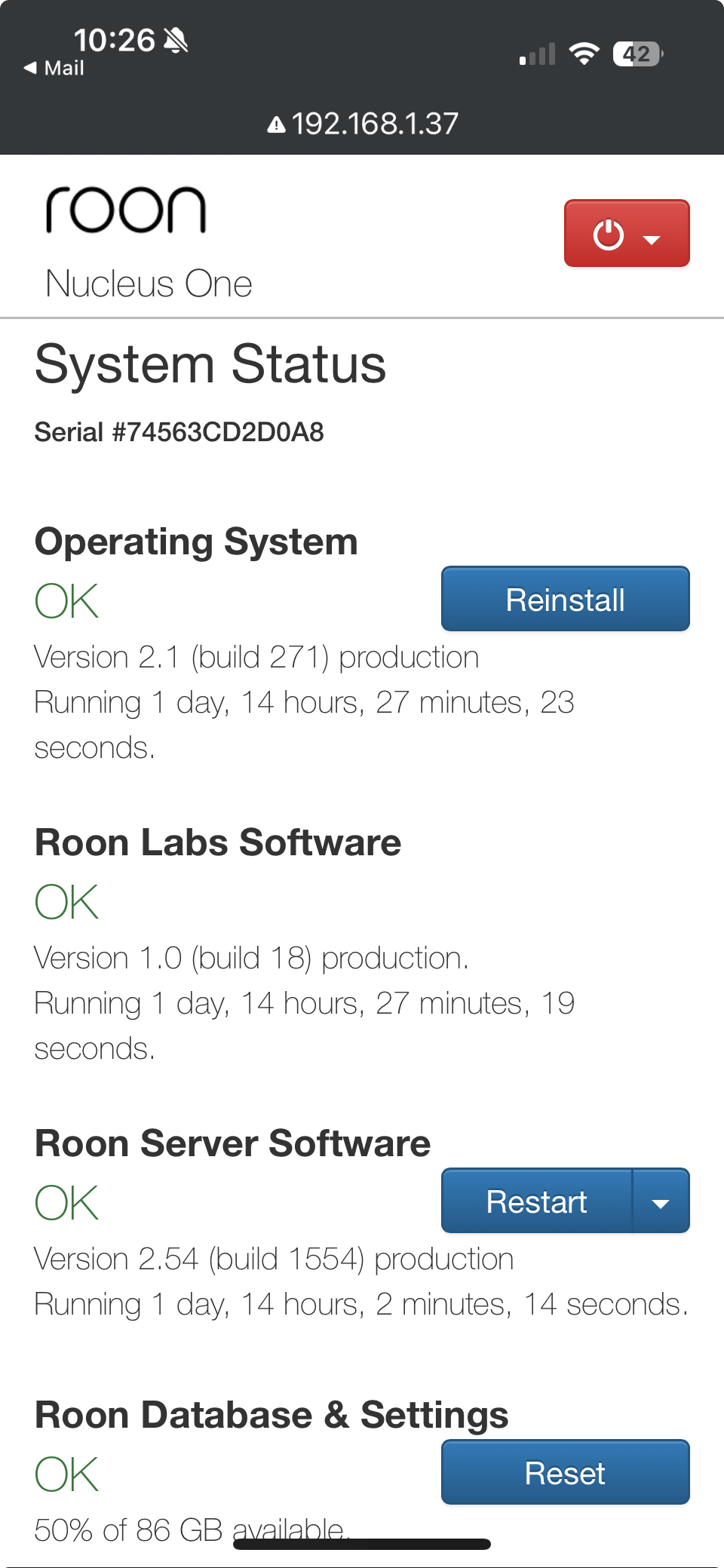

I would say before - I believe according to the time stamps shown below, I stopped the server, renamed the database and restarted the server 38 hours and 17 minutes ago:
Hi @Alan_Goldenberg,
Thanks for the screenshot - what’s odd is that when you refresh the Roon Server database, it usually resets the log set that follows the database. In your case, we’re not seeing a log refresh around the times given.
