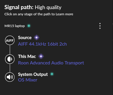

Can you please share a screenshot of the Signal Path within Roon for the digital chain with which you’re encountering this symptom?

I’m not using anything in MUSE - here’s the signal path (attached)

Screenshot 2025-03-05 at 10.29.39 AM
Hi Matt,
Fellow user here. That is what I would suggest to test things out. Also, you seem to be using the OS Mixer instead of CoreAudio out to the DAC. You might try using CoreAudio.
