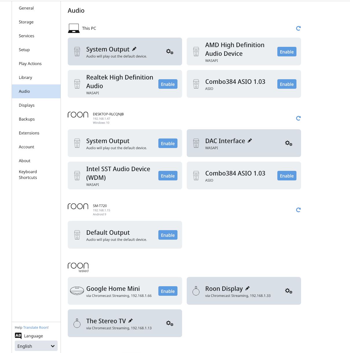

Core PC info in jpg format…
Core PC and Roon bridge PC are connected via Ethernet cable thru my Linksys EA8300 wifi router Have two displays on chromcasts. Remotes are samsung galaxy S8 phone, and galaxy tab S5E.
An intel fanless mini PC (windows 10) is running as roon bridge, using USB out of bridge to Amanero and TPA Buffalo ESS9038 DAC
