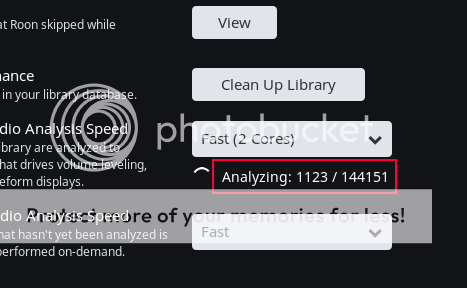

I am trialing roon at the moment and have pointed it at my music collection.
The initial scan of all the files went well, but I’ve noticed it had got stuck during ‘Backgroud audio analysis’ .
Here’s a pic: https://i1359.photobucket.com/albums/q782/gwpt/Roon-stuck_zpswszrb5on.png
Just wondering what to do, to ‘unstick’ it
Thanks
Guy
I’ve had this happen to me periodically, restarting the Roon core process generally takes care of it.

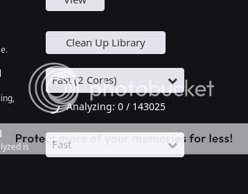

So, I rebooted my server about an hour ago, and it’s been stuck on 0/143025 ever since (I noticed that my old numbers 144151- 1123 = 143028, which is 3 more than what it seems to have started on, not sure what happen to the missing 3!)
See pic for current status: https://i1359.photobucket.com/albums/q782/gwpt/RoonStuck2_zps1p9opeeo.png
Are there logs somewhere, where I could see if it’s stuck on a specific file or something like that?
so, sadly, reboot didn’t seem to help :frowning:
