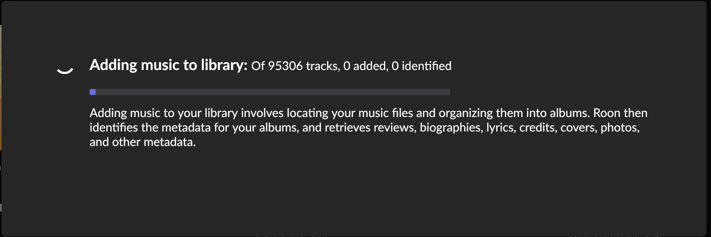

Roon stuck in "adding music to library" repeatedly over weeks (ref#GMDFRK)
Roon stuck in "adding music to library" - several times in the past couple of weeks

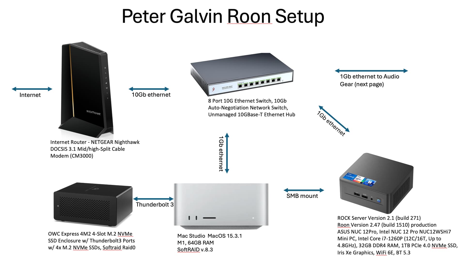

Wired ethernet w/ unmanaged switches
No changes in my environment except for the usual ripping CDs or purchasing tracks in itunes and those files being added to the file system that roon scans.
This scan stuck happened a while ago but seemed to be fixed until recently.
This time, been sitting in this status for at least 12 hours. No changes to the count.
The log file shows essentially nothing happening.
I’ve resolved it before by restarting roon on my ROCK server but that’s annoying / worried about corrupting my database (as has happened before) and having to start from scratch with ingest (and losing all my metadata changes etc).
Any solution besides restarting?

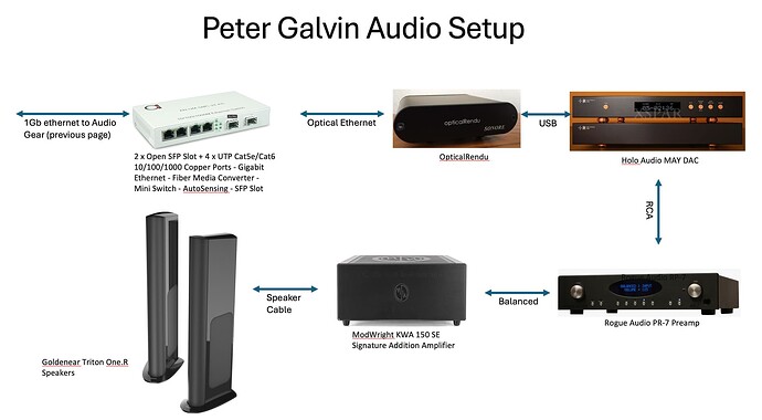

Attached are my audio setup details FYI.
