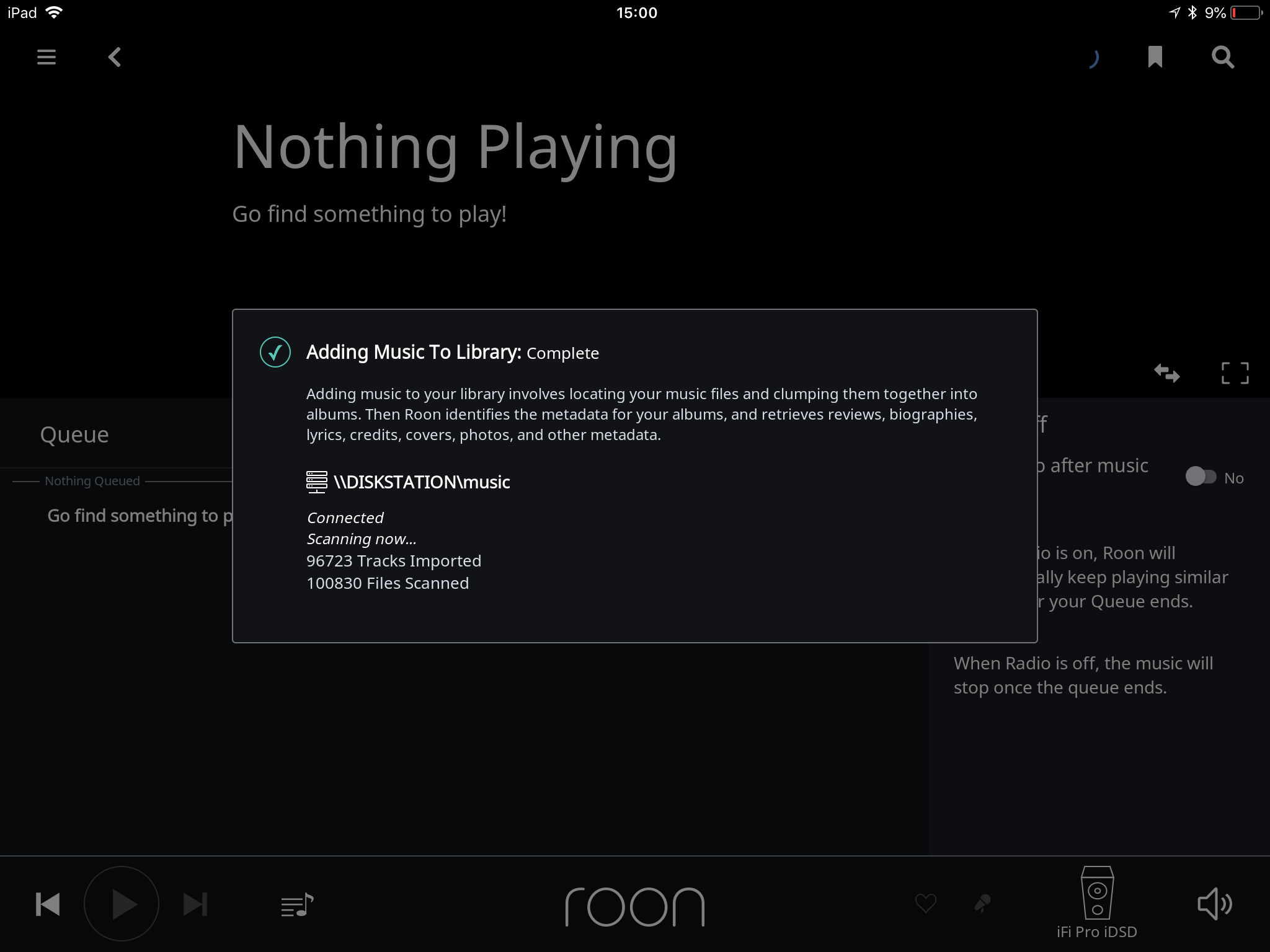

Hi, I noticed today that Roon seems to be stuck in an indexing loop. Or perhaps it is stuck on certain files that cannot be indexed, which I can’t identify. This hasn’t happened in a long time, and it appears to coincide with the latest core update.
I run the latest version of Roon on a Late 2012 Mac mini, in an AudioQuest Forest cabled network. My music is stored on a Synology DS412+ NAS, also running on the latest software.
The only other thing that has changed is that I’m reviewing an iFi Pro iDSD at the moment, which is totally galvanically separated on all digital inputs, but I can’t see how that affects indexing.

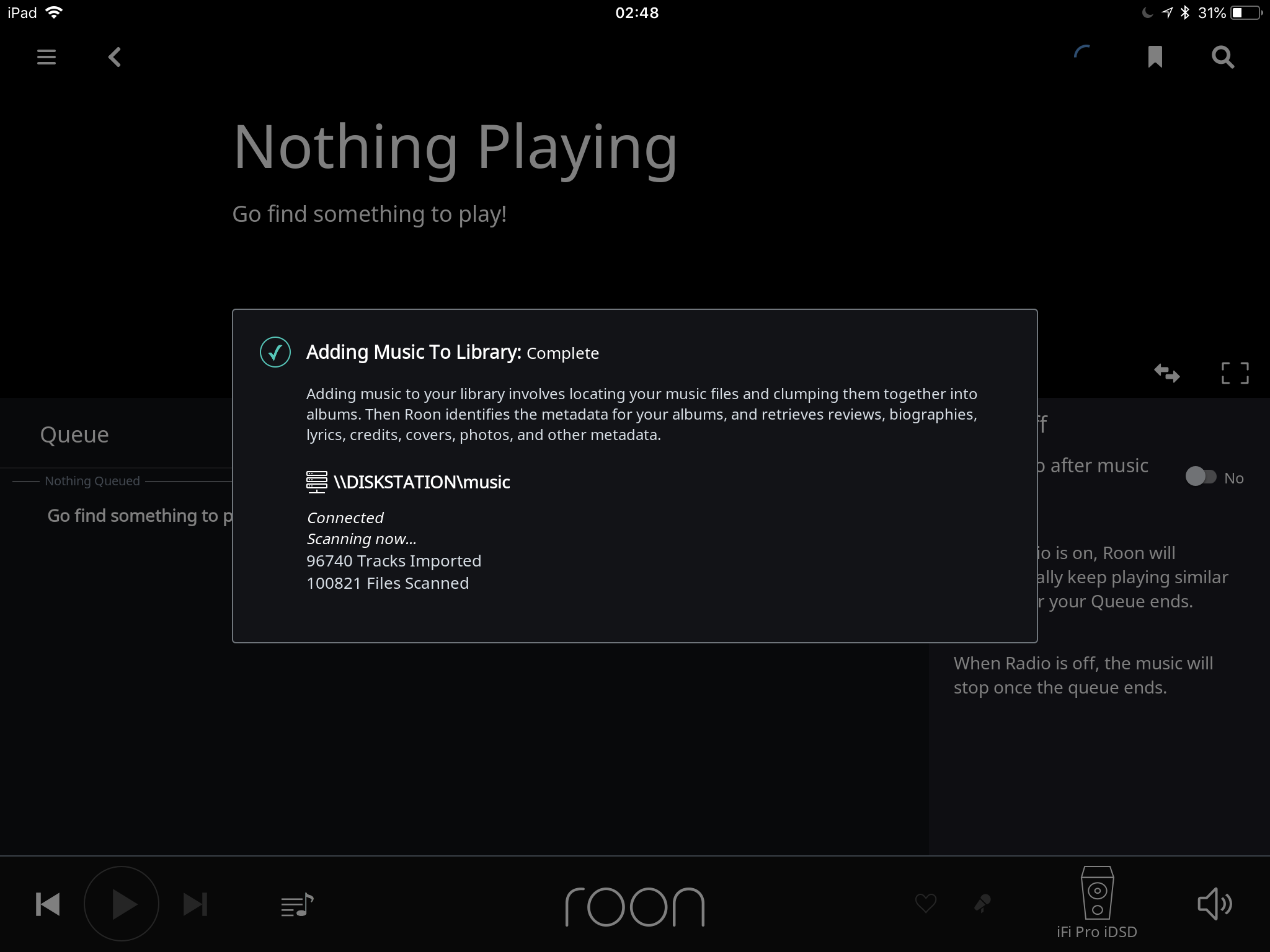

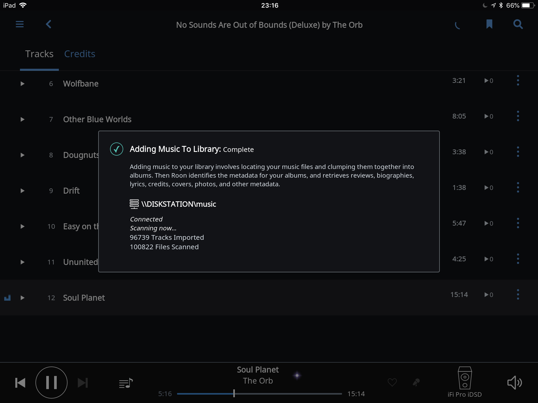

Update: there seems to be some (very slow) progress after all. Below are three screenshots that were made at approximately 8 hour intervals, that show different numbers for imported tracks and scanned files. If I had to make a guess, it looks like Roon is currently sweating on the indexing of some incredibly large ‘ghost’ files, but I wouldn’t know how to identify and get rid of them…

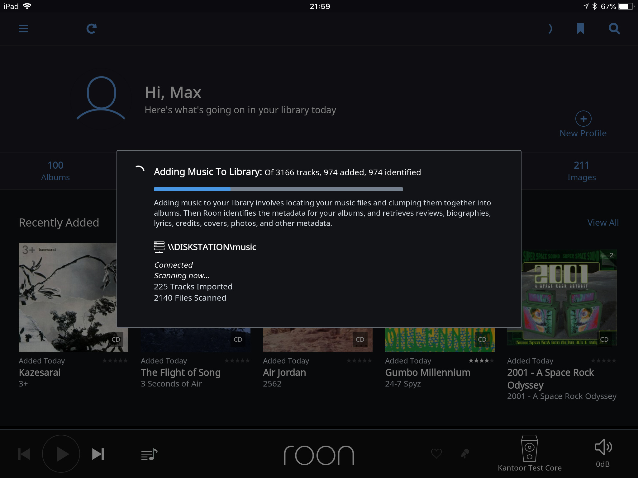

Indexing for the ‘Test Core’ on my MacBook Pro (with SSD and 8GB RAM). Tried some tracks that were indexed first and they played perfectly. Now we wait and see what happens when the index is ready…

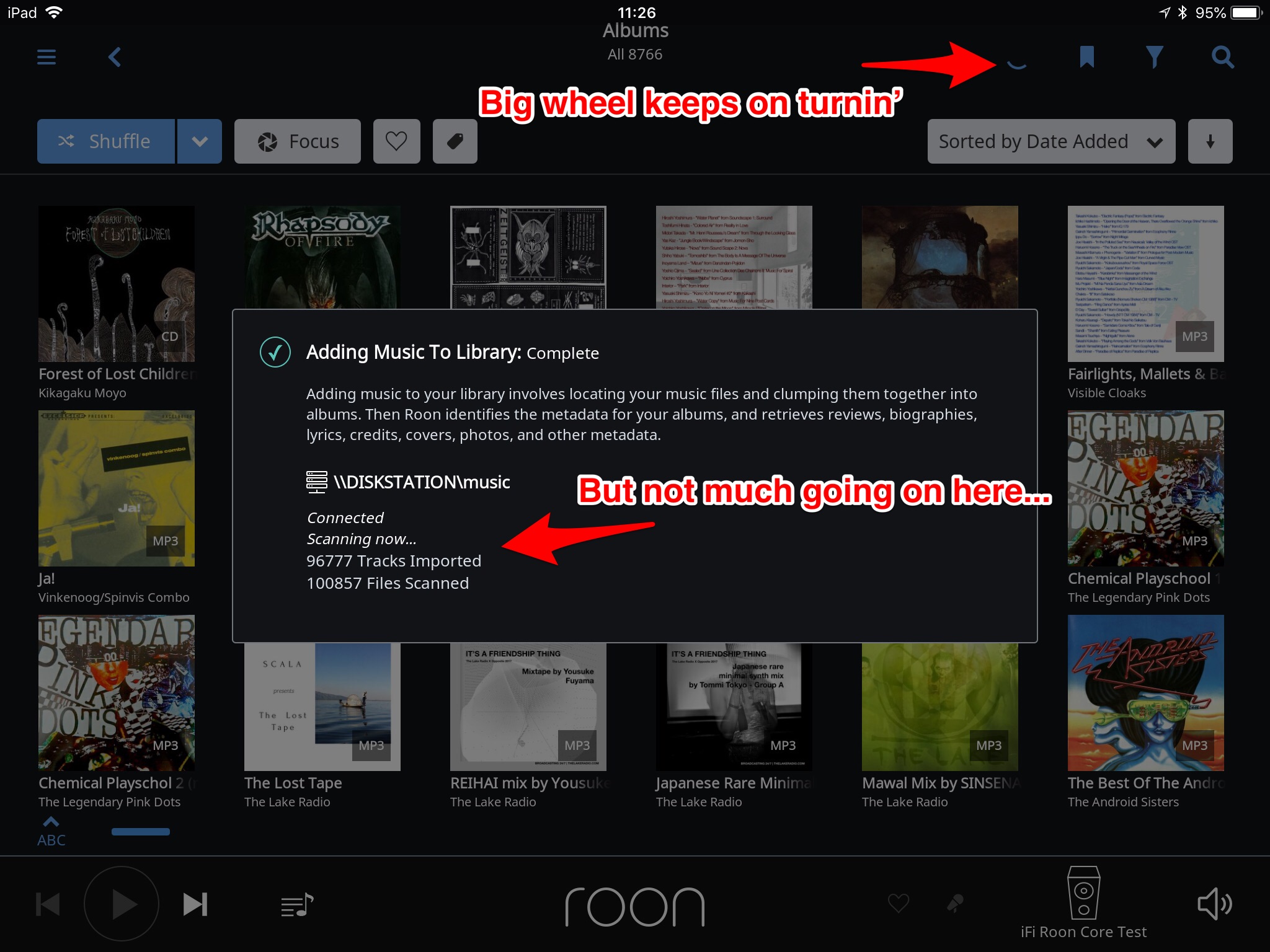

Bad news I’m afraid. The ‘new’ Core (Roon Server) install on my SSD’d MacBook Pro started off promising, but after adding new music and lettiing the next automated index commence, it appears to be stuck again.
This time it happens while the core is connected to a different DAC, so it looks like we can exclude the USB connection to any DAC as the reason for the NAS time-out.
