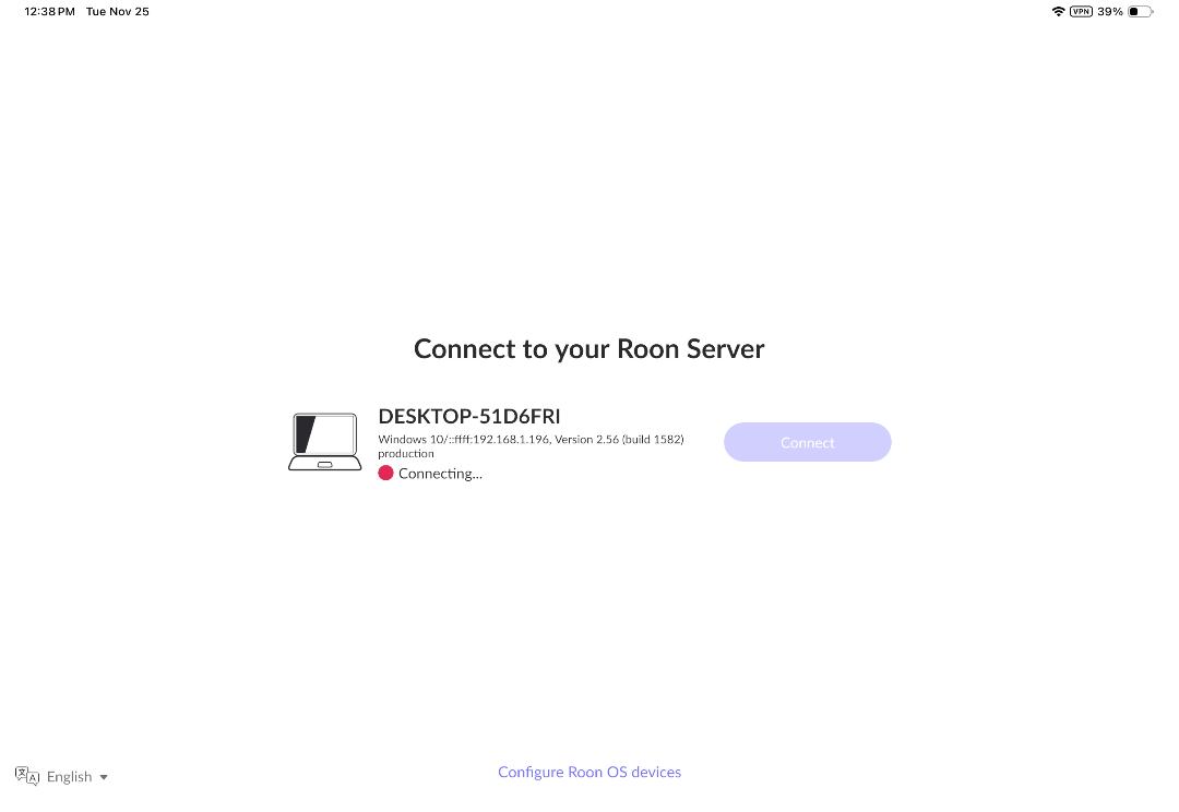

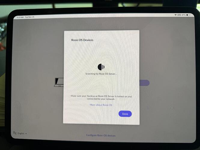

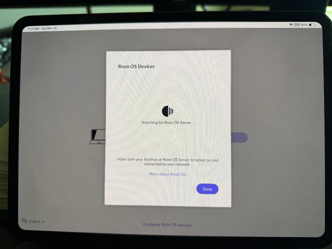

It is stuck on Connect to your Roon Server. If i hit the link to "Configure Roon OS device" there is a constant "Searching for Roon OS Server". "Make sure your Nucleus or Roon Server is turned on and connnected to network. It is connected and function on my desktop PC.
I have Google Fiber for Wifi and router. I have extenders but am not connected to them on the 2.4Ghz network. I am all 5Ghz
If you are running RoonServer on MacOS, you are not running a Roon OS device. So, you will never find a Roon OS server using the “Configure Roon OS devices” link. And that screen is correct for your environment.
Can you provide a screen shot prior?
I am not running a roon server on mac os. My roon server is on my desktop PC. I am just trying to access the roon server so i can use my Ipad to control music when in the music room. I added a pic to the chat of the message i am receiving. Dave
I guess I was confused and assumed your PC was running MacOS because you mentioned it in your post.
What is the OS of the PC you are running RoonServer ON?
RoonOS is not RoonServer. The “Configure Roon OS device” only returns servers which are running RoonOS, that would be a Nucleus, or a user built ROCK unit. It does not return any information if you are running Roonserver on any other OS, like MacOS, Windows, or Linux.
That is why I suggested posting a pic without that pop up. Because if you are not using a Nucleus or a built ROCK unit, that pop up is not relevant to your situation.
Can you just call me at [redacted] and walk me through how to connect my iPad so that I can view files, records and control my audio system via Roon?
I use my iPad to control my system to my Eversolo. Everything connects fine except the iPad.
I never got to fully use my 12 day trial because I cannot get this loaded to my iPAD.

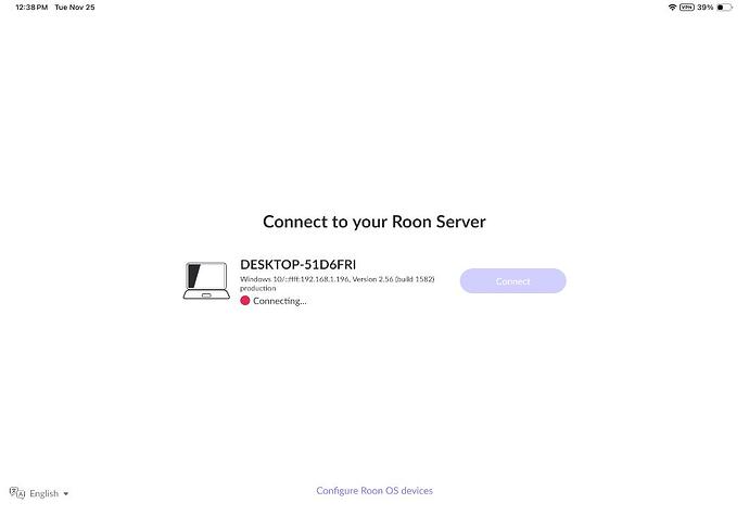

Attached is a pic of the “connect to your Roon Server” message that is stuck on connecting.

They are both on the same network.
Yeah, they are both on the 192.168.1.112(IPAD) and 1.196(PC).
I just can’t seem to figure out why all of my devices other than the iPad can connect to the Roon Server on my PC.
I don’t have a ROCK Server, or Nucleus. The PC streams well to my Eversolo/McIntosh as well as my HEOS/Marantz but not iPad.
I just want the iPad to be an interface so that I don’t have to come back to my office everytime I want to change songs… seems reasonable.
Thanks for the input.
The toggle is green on the Local Network within the settings/apps/roon
Did you check to make sure you’re Windows PC is set to Private network, and did you test the Windows firewall, by turning it off and seeing if the IPad connects?
