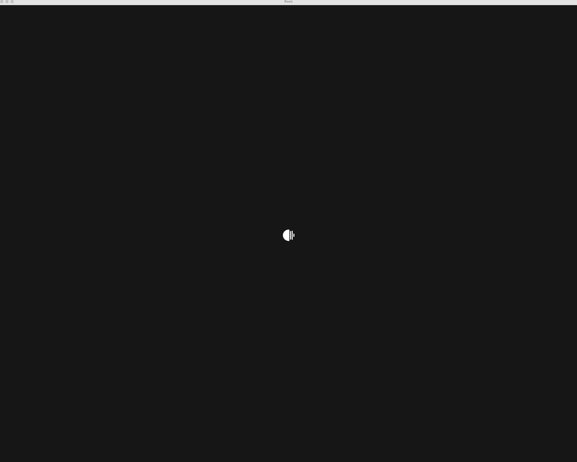

I'm using Roon on my MacStudio (Sequoia 15.1.1), but tonight - for no apparent reason - when I launch it the black start window remains with the Roon logo and after a few seconds the spinning wheel appears and I have to exit the software by forcing it to quit. I've already tried restarting my Mac, but the problem persists... any help?

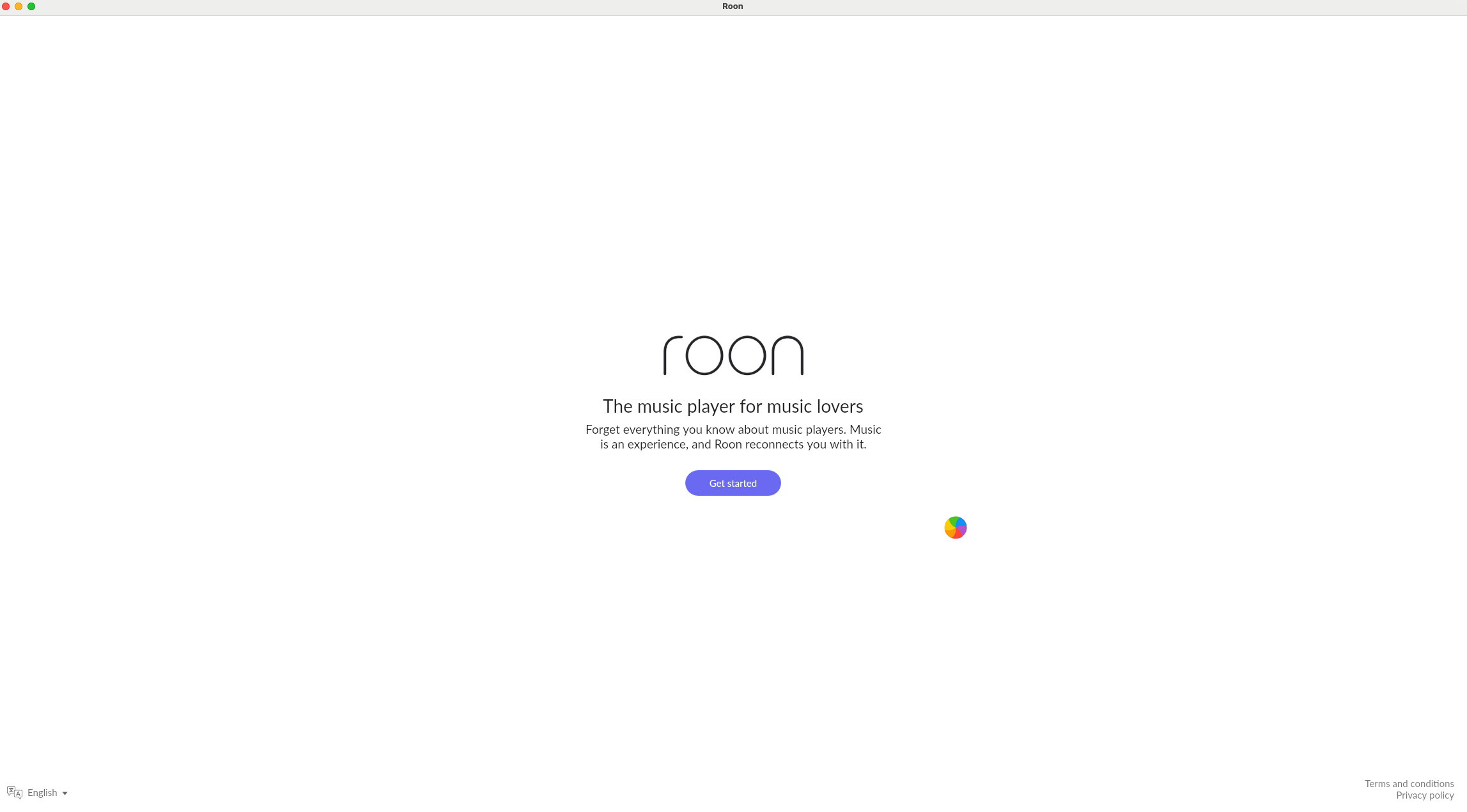

I then followed your instructions. After reinstalling Roon, if I launch it, this window appears:
…but after a few seconds the spinning wheel appears and the application remains blocked. Forcing me to force it out.
