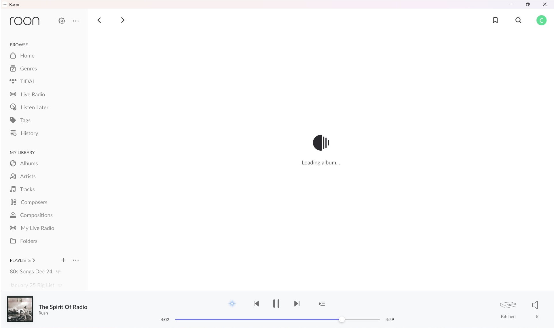

Roon stuck on "loading album..," when selecting an album recently edited. All other albums are fine. But after making edits I can't return to that album. I've restarted Nucleus One. I've restarted the app. I've restarted the computer I'm connected to. Nothing changes the "loading album..." status.
Nucleus One wired though Linksys 1gb switch. Eero mesh wireless to windows 11 laptop. As most of the library works fine I doubt this is a network issue.

It is not one specific album. It is multiple. It happens after I do edits. After making changes to albums this occurs when you return to the album. After an hour - can’t narrow down the timing yet - you can go back and get access. Then if you make another edit it hangs up again. I’ve added some songs recently that don’t have the correct album and song titles. Doing it at this pace will take me forever to complete.

I was able to complete my project after a tedious process. IF I pressed the back arrow in “Albums” I could go back to the tracks on the album without having to go through the “loading” process. It would allow me to edit the next track that way. This doesn’t solve the problem of “loading album” it just allowed me to get around the problem. If I go to the album now it still has the “loading album” problem but I can search for the songs and play them listed properly. If I restart the roon server sometimes that will clear up. Still hoping for some suggestions on how to clear this loading problem up.

Thanks so much for your patience and additional information! We were able to review the logs you sent over around the time you shared your screenshot, but didn’t see any indication of the loading issues you’re experiencing.

Ok. I’m sure I can recreate the problem easily enough. These are CD rips where Roon can’t identify the album. If Roon can identify the album everything works fine. But when it can’t I attempt to search for the album. Sometimes that works sometimes it doesn’t. When it fails I have to manually enter the song and title details. IF I can do this without having the album reload it works fine. But if I click on the album - without having the edits finished - that is when it goes into “loading…”. Usually if I restart the Roon software I can get back into the album to continue to edit but not always. Sometimes I have to leave it for a day or two, then restart the Roon software, then I can edit again. Seems weird I’d be the only one having this problem.
