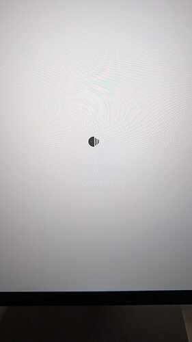

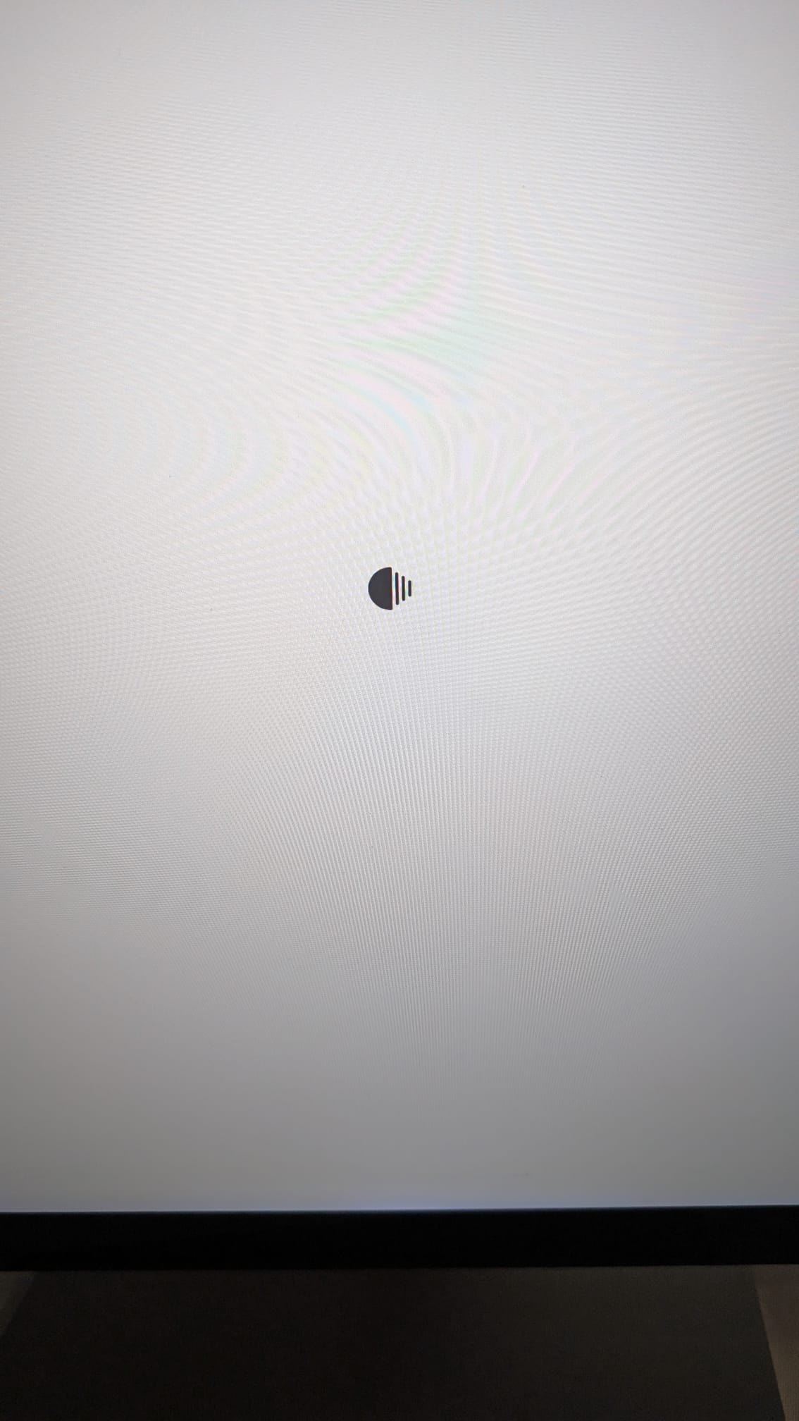

As I said, I downloaded the application from Roon’s website and installed it. But when I tried to open the application the screen shows only Roon’s logo with the lines on the right side moving. That’s it. Nothing happens. The program doesn’t open. WiFi is fine. It’s working for everything else.
This is the screen I get when I open the application

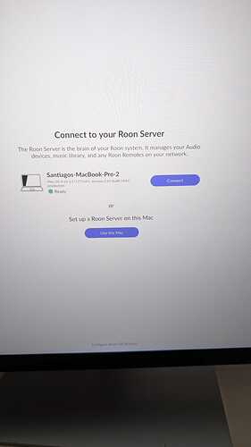

This is the screen I get after I select Connect
