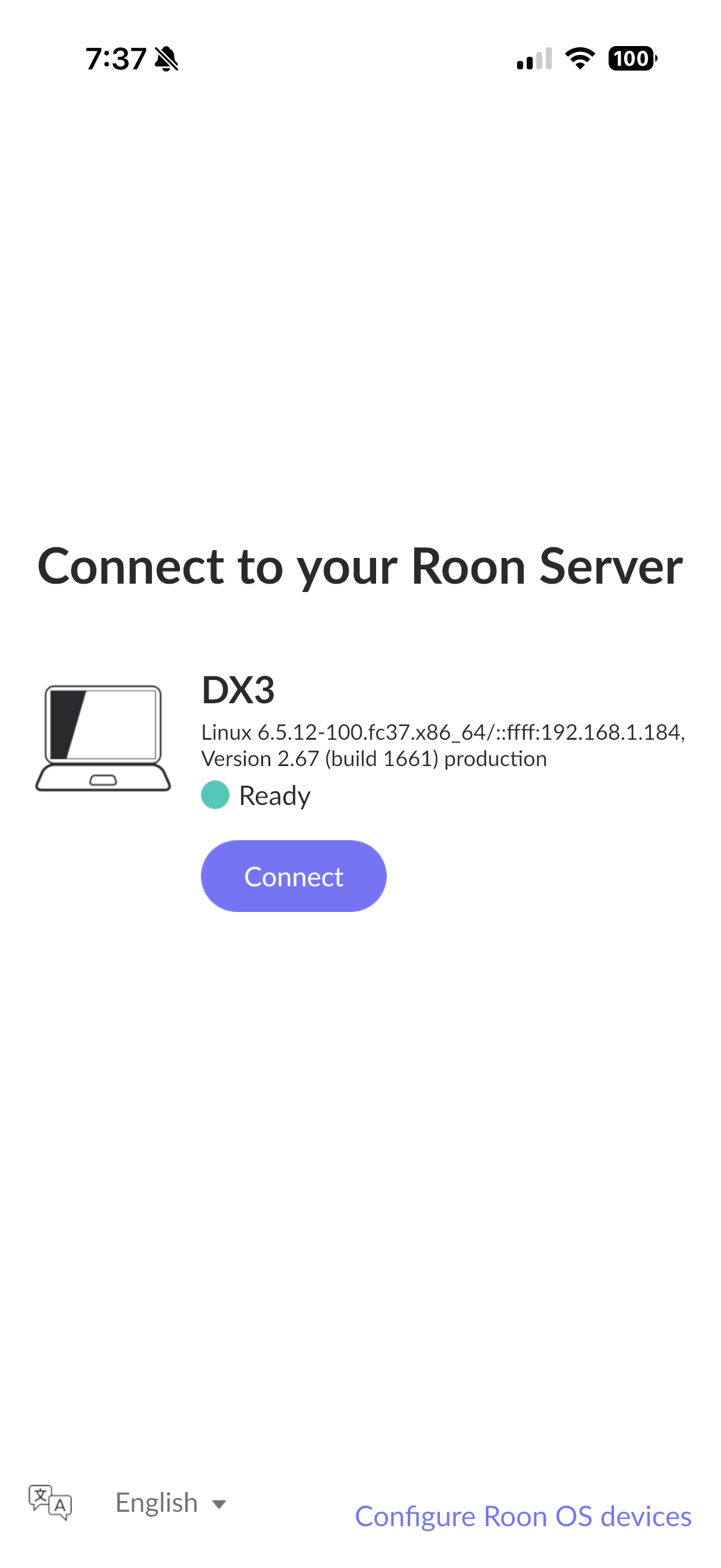

Hi @ludlowknowles,
From a previous post your Roon Server was running on an Antipodes DX.

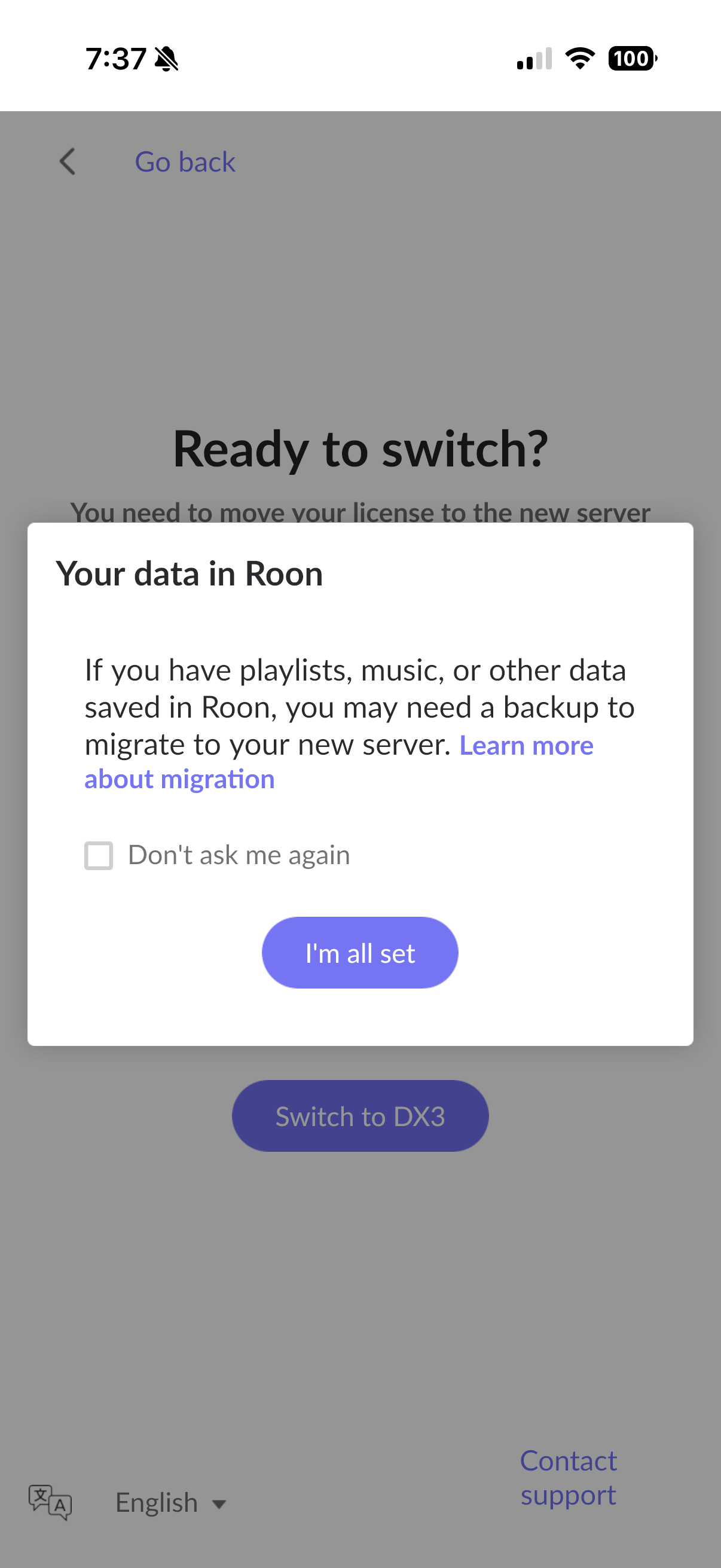

The screen shot you posted is offering an option to switch to a DX3 (which I assume is your name for the Antipodes DX).
Have you attempted to do so?
As pointed out before, you don’t need to use this screen, when for example your Nucleus is the active device. Therefore, back out, i.e., < Go back.
It would be really helpful if you confirmed which device you want to use as your Roon Server.
Since you have a single licence, manage the active device under Settings → General, and don’t use the Configure Roon OS devices link.

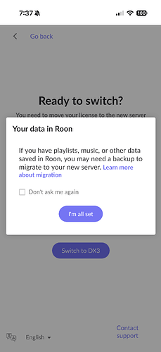

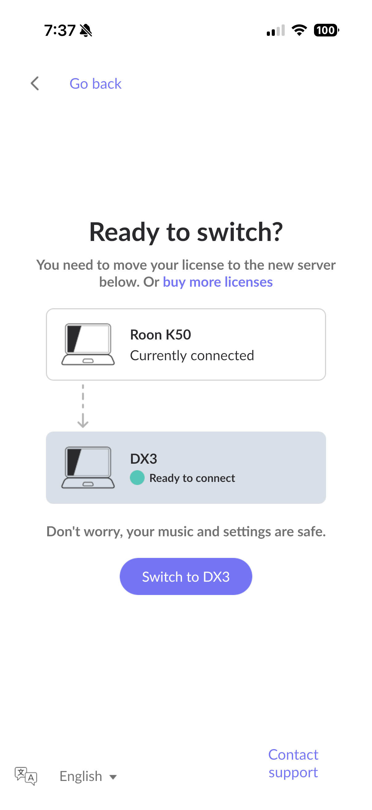

Hello @ludlowknowles ,
Thanks for reaching out. According to diagnostics on our end, it doesn’t looke like there are any Roon Servers currently associated with your account.
Are you trying to switch to the DX3 as your main Roon Server? If so, you can go ahead and click the Switch to DX3 button you see there.
Let us know how this goes!

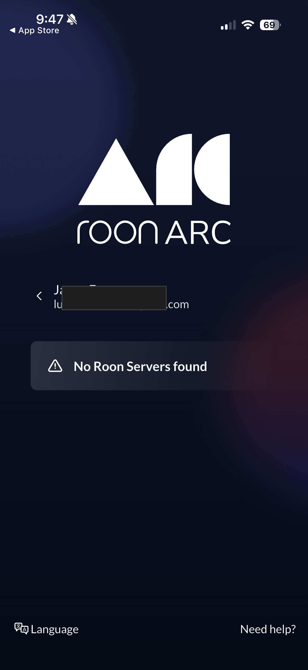

I connected to the DX3 server but there is another option called KAL50. What is that and why am I asked each time I open roon if I want to connect to DX3 or remain on KAL50? What is that? Also I am unable to use ROONARC it says NO ROON SERVERS FOUND. It has not worked since 4/27/26 HELP. Unfortuantly this system for contacting you is too complicated and I am only able to put 1 screenshot per reply so it is taking far too long to resovle the issues.
Do you have an Antipodes KALA 50 and an Antipodes DX?
Which device should run your Roon Server?
Regarding screenshots, you may post more than one image. Please follow this guide.
Roon ARC won’t work until you have an active Roon Server. Therefore, park this issue until the first is resolved.

Hi Thank you! I have a dx server that was sent to Antipodes. It had to be updated bc they told me it would not work after the ROON update on 04/27/26. So I don’t know how to anwwer bc they changed the entire motherboard and now it says both DX3 and Kala50 each time I try to connect. My playlists were all lost in this. And I also cannot use ROONARC. For now i am connected to DX3 and the library (minus playlists) is there. I just want to connect ROONARC and be done. Why won’t ROONARC connect?
This has been a horrible experience. I am not a programmer. Your system for replying and getting help is too complicated.
I’ve removed your last screenshot (of Roon ARC) in your previous post - it was showing your email address. It’s not a good idea to post private information on a public forum.
Hold tight - tech support will do their best to help you through this.

You appear to have three potentially unrelated issues:
  1. You have an Antipodes Kala 50 server currently active on your network that does not reflect actual hardware in your environment. When Antipodes swapped the motherboard, the new board registered as a new machine in Roon (different hardware/machine ID), while your old DX3 registration still lingers in your account.
You can resolve this by selecting the “Switch to DX3” option. However, we first need to sort out what happened to your library when the motherboard was switched, as this is causing issue #2 below.

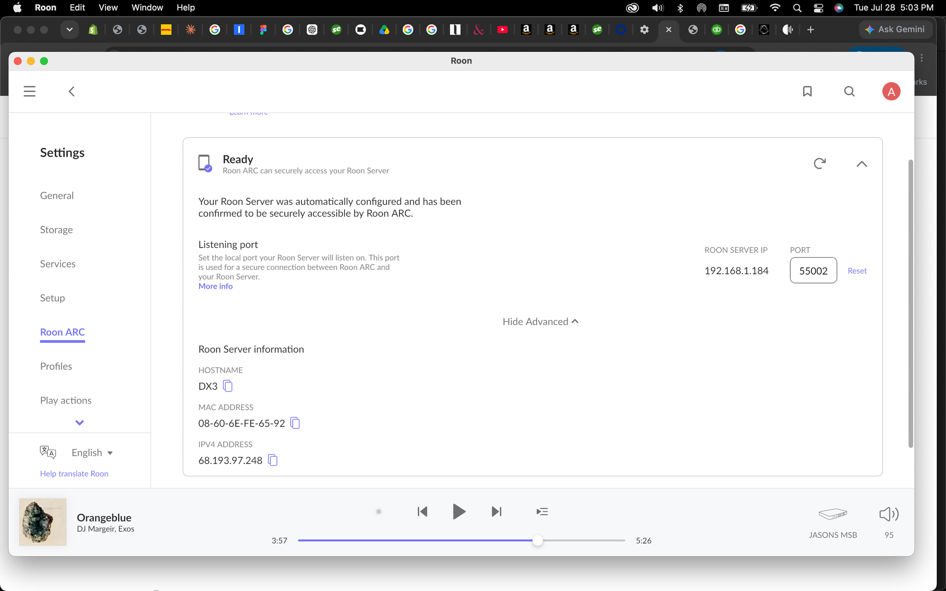

  2. Lastly, Roon ARC will require port forwarding or Tailscale in order to work with Roon. What do you see in Settings → ARC? The specific diagnostic message there will dictate the appropriate solution. The most likely cause is that you have two active routers on your network, or that there are multiple subnetworks in your local network.
Is your RoonServer machine (the DX3) connected to the access point you’ve mentioned in your other threads, or to your main router?

Inside settings>Arc
Hi @ludlowknowles,
Thank you, that screenshot is actually good news. Let’s take your issues one at a time in plain terms.
1. Why you keep seeing “DX3” and “KAL50”
You’re right that you only have one physical server. When Antipodes replaced the motherboard, Roon registered the new board as a new machine, while the old registration still shows in the picker, so “DX3” (the new board) and “KAL50” (the old one) are really the same box before and after the repair. That’s why Roon keeps asking which to use.
To settle it: on that selection screen, choose DX3 and let it fully start. Going forward, manage your active server under Settings → General and avoid the “Configure Roon OS devices” link, which is what re-surfaces the old entry. The KAL50 entry is just a stale listing, once DX3 is consistently your active server, you can ignore it, and it won’t affect playback or ARC.
2. Roon ARC, this is already working
Good news here: your Settings → ARC screen shows “Ready — securely accessible by Roon ARC,” so your server is set up correctly and reachable from the internet. The earlier “No Roon Servers found” message was a side effect of issue #1, ARC can’t connect while there’s no active server, and yours was caught between the DX3 and KAL50 registrations.
Now that DX3 is active, please fully close and reopen the Roon ARC app on your phone, and make sure you’re signed into ARC with the same Roon account. It should find DX3 and connect. If it still doesn’t, sign out of ARC and back in, and let us know.

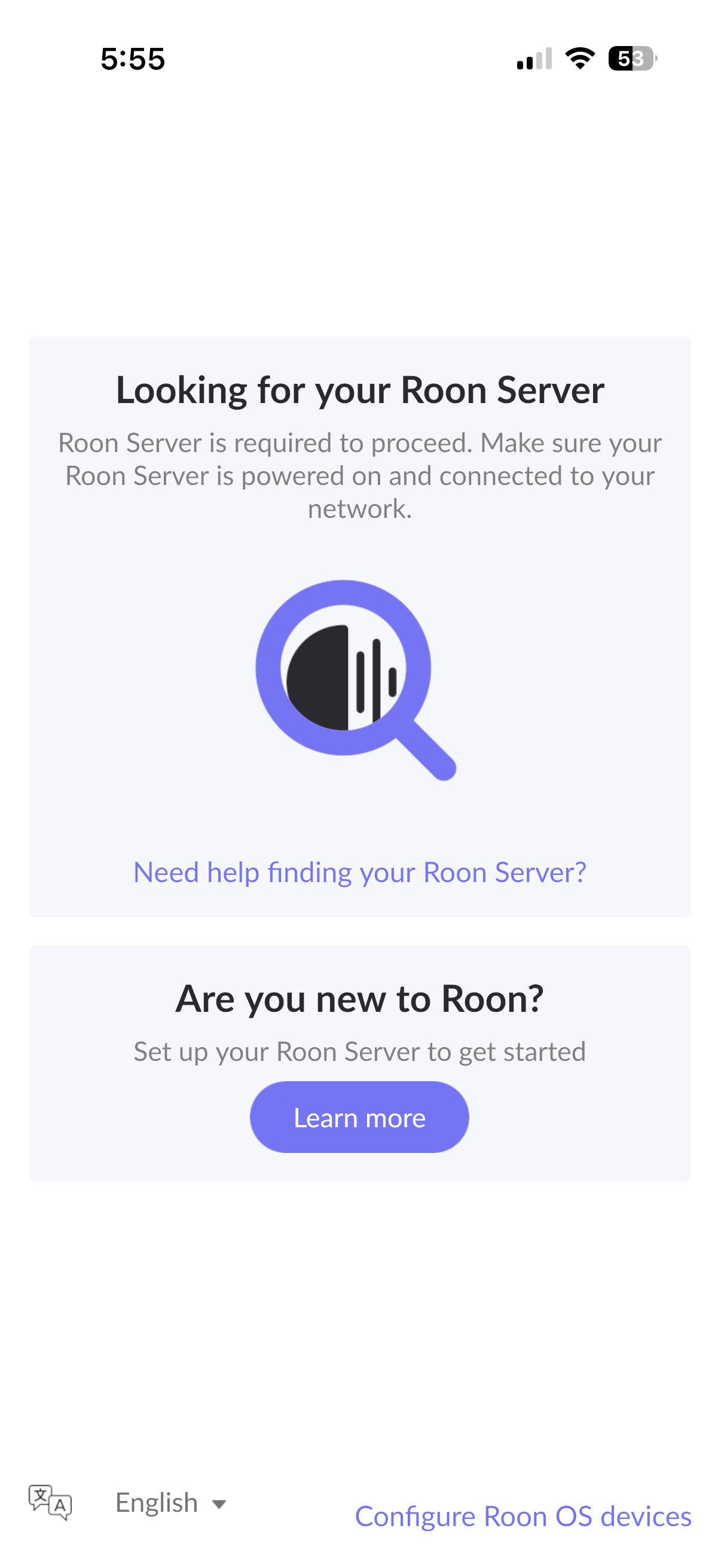

Hello I can connect Roon to DX3. The playlists are lost as Antipodes did not save any of the data.

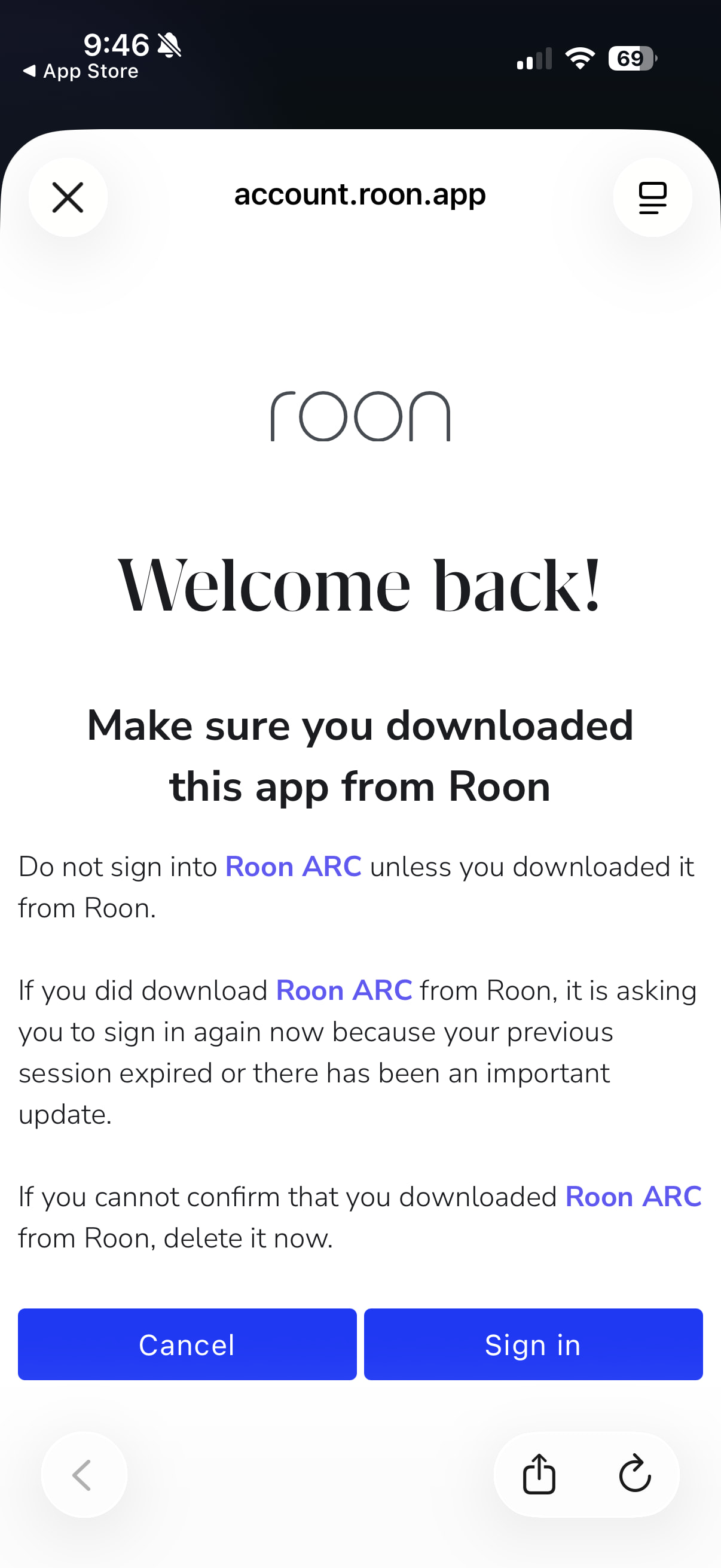

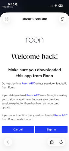

The remainign problem is with RoonArc. It is the same as always. I have deleted it 20 times, reinstalled and it is always the same issue. Please see the attached. This would be much faster if I could just speak with someone this is taking too long to resolve.
