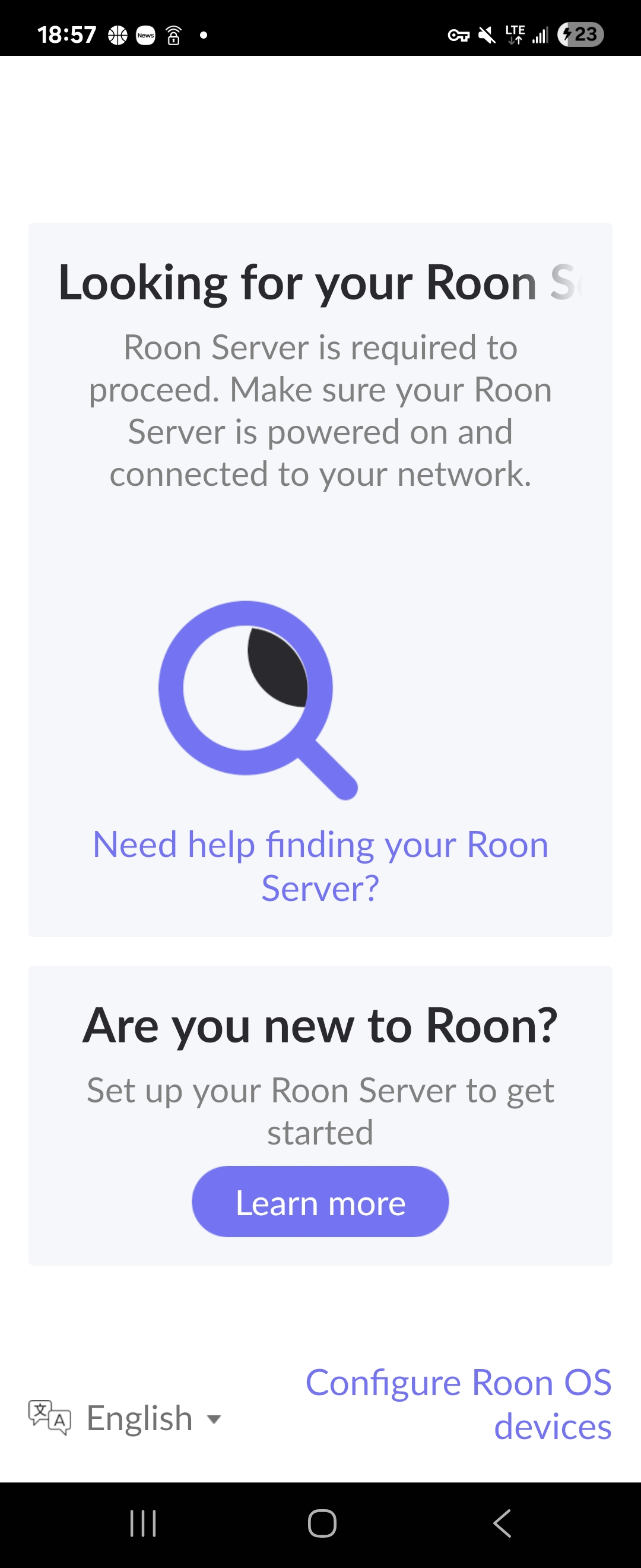

It only ever says it is scanning and taking longer than usual to connect
I have an Antipodes DSGT music server.it is connected to my router which is from Roger's communication. I have a simaudio moon ace integrated amp.

The screenshot you’ve shared seems to indicate that RoonServer’s device discovery announcements aren’t reaching the phone.
Account diagnostics indicate that an Android phone associated with your account was recently active. However, the associated RoonServer hasn’t actually been online for four days, according to the latest logs to reach our servers.
For due diligence, I’d first ensure that RoonServer hasn’t closed in the background or that the Antipodes machine hasn’t inadvertently powered off.
Double-check that Roon is safelisted in any firewalls or third-party network security.
The Rogers router might offer you access to multicast-related settings in the router settings administration page under an “Advanced” tab or similar. Ensure that multicast forwarding is toggled on. If you’re relying on WiFi, then also double-check that any settings related to Band Steering are turned off.
In summary, it’s most likely the case that there’s a simple cause for this problem and we’ll quickly uncover it if we work systematically to remove variables. Please first try restarting the RoonServer machine and ensuring that it’s active on the network outside of Roon.
