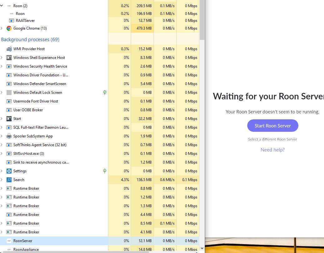

Since my sunscription renewed, my roon does not open. It just sits on the screen saying it is looking for a roon server and never gets past that. I looked at my task manager and it shows roon server. I still have windows 10 pro on this PC.

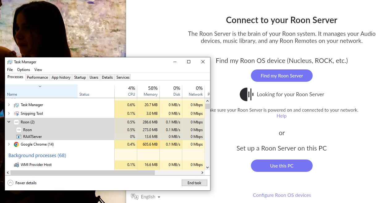

Actually, your Task Manager screenshot is only showing Roon and RAATServer running - your Roon Server is not shown. It should be listed in the Background processes section if it is running.
Where did you have your Roon Server - on a Nucleus or ROCK/NUC, or were you using the Roon Server installed on this PC?

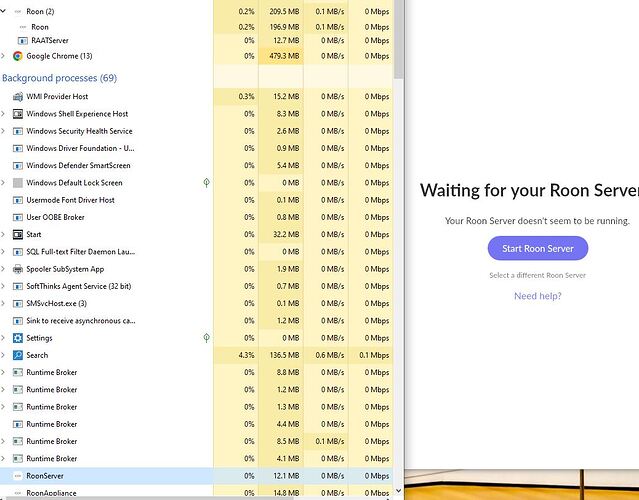

1: I attached another screen shot showing the Server at the bottom of the task manager
2: Yes, I am running the server on this computer
