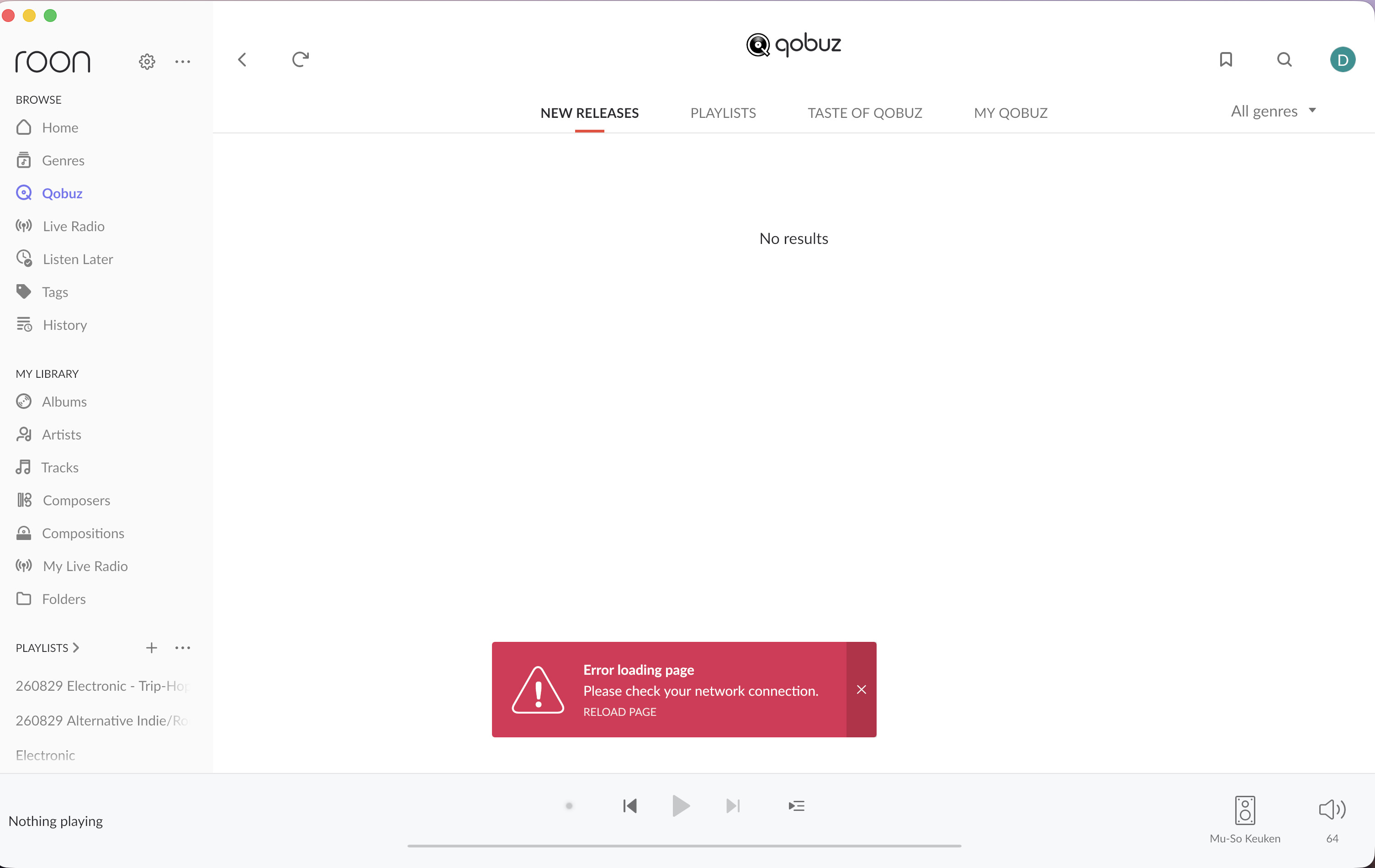

· Since the last update, I haven't been able to play tracks from Tidal or Qobuz. The Tidal login succeeds, but then Roon gets stuck on "Waiting for Tidal Login." I’ve restarted the Nucleus One several times—and even reinstalled it—but nothing helps. I had the same issue a few weeks ago, but managed to get it working again after several attempts to log in. This time, however, I can't get Tidal running in Roon at all. To try and work around this, I signed up for a Qobuz account. That login works, but Roon won't display the content. Could someone please look into this urgently? That would be greatly appreciated. Thanks in advance.

Hi @Vadim, it turned out the software wasn’t on version 2.73 (build 1694) yet. I performed the update, and now I’m experiencing the same issue I had over the weekend. Neither Tidal nor Qobuz is working. Qobuz shows the same red error, and Tidal just keeps waiting at the login screen, even though I’ve already logged in. This morning, everything worked after logging into Roon again, and both Roon and Qobuz logged in automatically. I look forward to hearing from you; thanks in advance.

Your system is working again as of 29 September, and we can see why it broke. It was neither Tidal nor Qobuz.
Your Nucleus could not reliably look up or reach our servers. Over 26, 27 and 28 September it recorded 6,607, 4,949 and 1,906 network timeouts. Among them, every attempt to sign in to your Roon account timed out: 165 attempts, 165 failures, none successful. That is exactly the spinning login you described. It also answers your question about the version, because Roon checks for and downloads updates over the same connections, so the update could not complete either.
The cause is the DNS server your Nucleus is using. It is set to an address out on the internet (89.101.251.229) rather than anything on your own network. When that server is slow or unreachable, everything in Roon that needs the internet stops while your local network keeps working normally, which is why nothing else in the house looked wrong.
