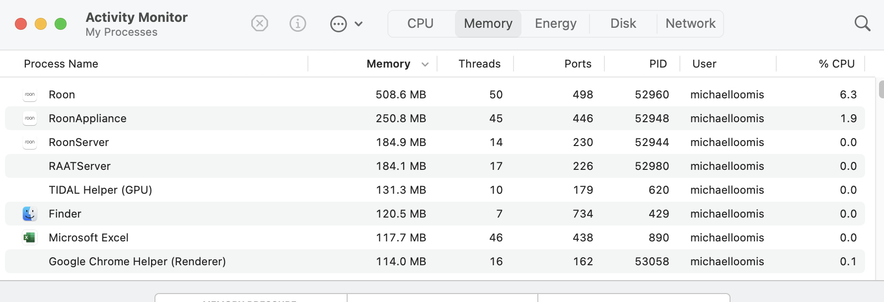

Activity monitor shows Roon - not Roon Server - running.

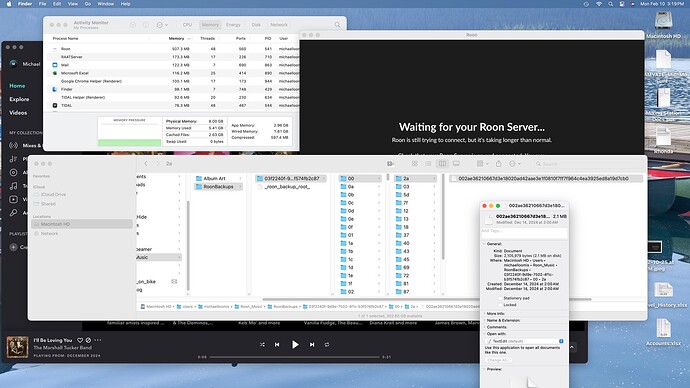

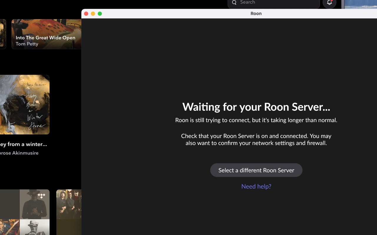

Here’s what my screen looks like immediately after startup. Tidal auto-loads and runs fine (that’s the Tidal window behind the Roon window), but Roon is stuck.

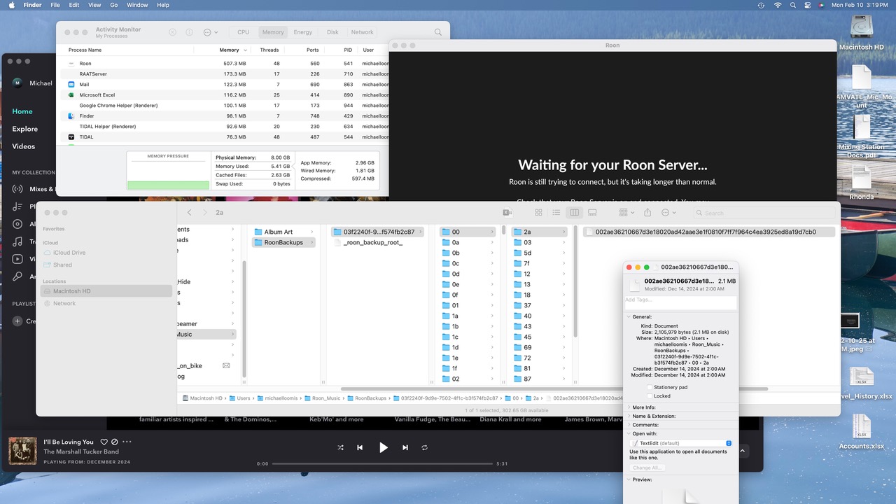

Another screen shot showing Activity Monitor (has Roon entry, NOT Roon Server. Also, various Tidal-related entries) and also showing the file structure where my Roon backups live. Tons of machine-generated nested folders that I find impossible to decipher. For example, where would my most recent backup live?

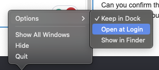

Just to make sure did you check the “Open at Login” option that you see when you right click the Roon icon?
Screenshot 2025-02-10 at 13.45.39
If that doesn’t fix the issue then can you please use the directions found here and send over a set of logs to our File Uploader?
Yes, I checked “Open at Login”. I also submitted a zip file of logs.

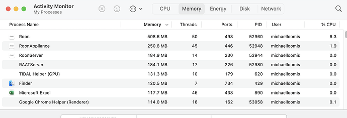

Thanks for that information. I resent a zip file of Logs (this time Roon Server Logs!). Starting the Roon Server app from Roon>Show Package Contents> path results in RoonServer and RoonAppliance showing up in Activity Monitor (see screenshot), but no windows open to be able to use Roon. Clicking the app icon at this point produces the “Waiting for your Roon Server…” window.

Thanks for the update! As a next step (per the screenshot you’ve included above)
What happens if you click the ‘select different Roon Server’ option, and then select ‘Use this mac’?
Do you see the Roon Jellyfish appear in your upper taskbar on the Mac?
We’ll be monitoring for your reply. Thank you! :+1:
Clicking “select different Roon Server” seemed to do the trick! Some details in my database were lost, but all the correct titles are in my collection. Looks like I’m back in business. Thank you!!
