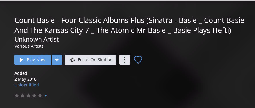

Time to try to solve this annoying problem.
My CDs, files etc are loaded into itunes, and now I’m using roon to play back.
Even though the info is “right” in itunes, roon is getting it wrong.
For example, I just loaded into iTunes a compilation of 2 CDs by Count Basie.
In iTunes, the track name, album by artist, and artist are all set.
But in Roon, it seems to take the artist name and prepend it to the album name, and set “unknown artist” instead of Count Basie.
(See attached screen shots).
It does this for many albums, so maybe there is a setting somewhere that will correct his (and not make me hand edit thousands of albums in Roon).
Help appreciated!

Hi Dylan,
It happens with single CDs as well. Maybe 1 in 10 albums shows up this way…

Just going there the artist is “unknown artist” and the album is “willie nelson - always on my mind”. That doesn’t find the album. If I manually change the artist to willie nelson and the title to “always on my mind” it shows up as the first match.
