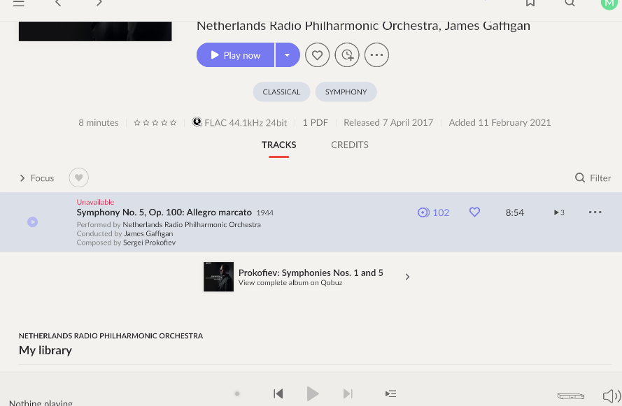

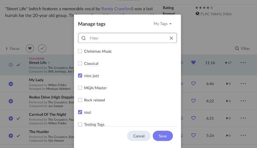

My local files are intact but when I looked at my Tags, they mostly updated fine but ANY tagged track keeps saying "unavailable". I've tracked this down and it seems like if I originally tag a track it say "unavailable" but the rest of the album is fine. If I had tagged the entire album as a tag then no issues. I've tried to disable my local storage and sign out of Qobuz, then restart Roon (restart the Mac mini) and enable storage and log back into Qobuz but the tagged tracks still say "unavailable".
I noticed the pattern after noticing a favorite tagged track was in both a tag named "Jazz" and the same track tagged in "Soul".

I just tried that. No luck. Once I restart Roon it still shows “unavailable” in either tagged location of ‘Soul’ or ‘misc jazz’
