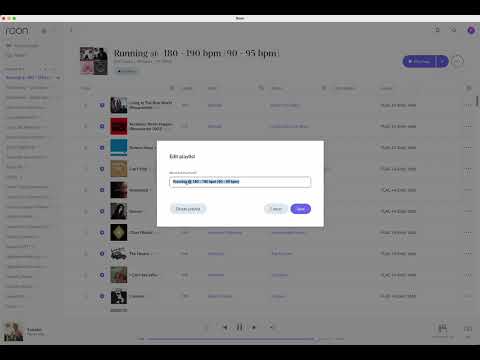

Upgrading audio quality via the "Improve Playlist" feature does not save upgrades to files with Tidal playlists. When I click the "improve playlist" button, select "Upgrade quality", and then "Save [#] improvements" it looks like it's saved the changes for a few seconds, and then all the quality upgrades revert back to the original songs and the "Improve Playlist" button returns, with the exact same upgrade recommendations. No matter how many times I try to upgrade the quality, the playlist reverts back to its original form and the same quality upgrade recommendations are suggested repeatedly.
Interestingly, I seem to have found a hack to work around this bug. If I *first* edit the title of my playlist from within Roon (any change to the title seems to work), and *then* I go through the entire "Improve playlist" audio quality upgrade flow, it will usually (though not always) save the upgraded quality songs to the playlist. For some reason forcing an edit to the playlist title first unblocks the ability to upgrade songs via the Improve Playlist feature.
Here is a video I made of the entire experience and my workaround: https://www.youtube.com/watch?v=mn0slccqqME
Roon Server is running on an M4 Mac Mini (Mac OS 15.5) that is hard wired into my network via ethernet. My router is a Unifi Dream Machine SE, a USW-48-PoE switch, and my ISP is Xfinity (Gigabit internet via coax modem). This doesn't appear to be a network issue as playlists will save with my workaround hack.
Here’s a video of the bug and my workaround:

Thanks for the response @daniel. I was testing again tonight and came across yet another bug, perhaps related to this playlist update issue (or maybe it’s an entirely new issue…)
I first tried the audio quality improvement, and not only did the original bug appear, but a new bug appeared in which hundreds of duplicate tracks were added. The playlist was effectively doubled with duplicates of almost all tracks added. This is in addition to the original bug in this thread, i.e. audio quality reversion.
In between I tried improving a different playlist (Chillout Grooves), which had just 1 suggested quality upgrade. That worked the first time (timestamp: 08/04 23:42:17).
As you can see in the video I’ve linked below (it starts at the Chillout Grooves upgrade), a playlist “Running @ 180 - 190 bpm (90 - 95 bpm)” had 51 suggestions for quality improvements and a number of duplicates to be removed.
I went back to my “Running...” playlist and tried my only known bug workaround, i.e. editing the playlist name (changed it to “Running 180-190 bpm (90-95 bpm) test edit”) before trying again to improve audio quality. That hack failed (i.e. audio quality reverted again), and also duplicate tracks were added again, too.
