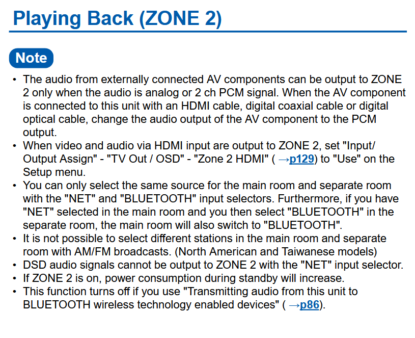

Very odd limitation, but it does describe as such in the manual I suppose:
But in any case, I don’t need to output different Roon streams to different zones. I want to be able to play Roon on Zone 2 while playing an arbitrary HDMI source on Zone 1.
