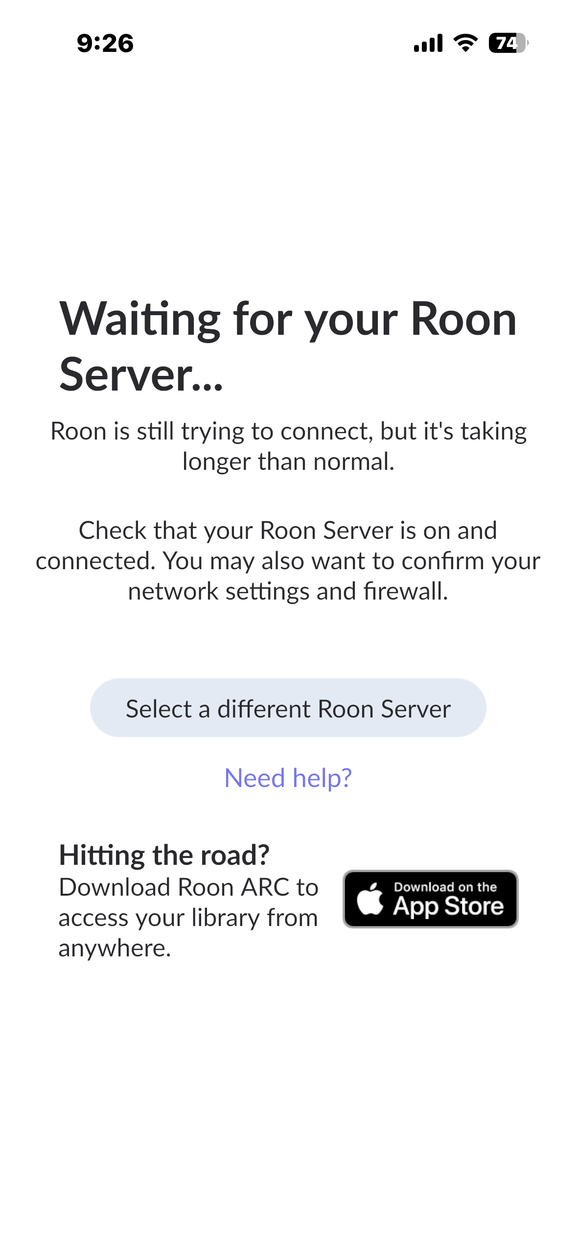

Is Roon Server running? · No, Roon Server is not running.
For Roon connectivity to work properly, both Roon Server and Roon Remote need to be turned on. · I can't turn on Roon Server, I need help.
Describe the issue Roon will not communicate with sonictransport
Describe your network setup Sonicorbiter running versión 2.7

Jose_Canas:
versión 2.7
You’ll need to have version 2.8 or higher to run Roon nowadays. To upgrade to 2.8, follow the steps mentioned here: Upgrade Sonicorbiter software for SGC & Audiostore Servers – AudioStore
noris
May 1, 2026, 9:38pm
4
Hey @Jose_Canas ,
Thanks for sharing that. Since your Sonicorbiter is on version 2.7, you will need to upgrade to version 2.8 or higher for Roon to run and communicate properly.
Please follow the upgrade steps here:
