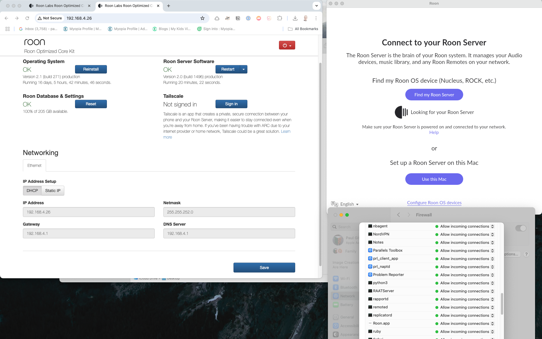

Roon was connecting from my Mac, now it isn't. I can connect to my Roon server using all other devices. When clicking 'Configure Roon OS devices' the popup shows the IP address, clicking on the IP address opens a webpage showing the Roon Optimized Core Kit settings - all are OK. I've restarted the Roon server. Roon works everywhere except on my Mac after it was updated to Sequoia 15.3
Roon server is connected direct to my Eero network adaptor, Mac connects via WIFI. Eero set up correctly verified by all other devices connecting to the same network working correctly, i.e. iphone, ipad, Sonos speakers
I have this problem also quit often. I am able to solve it by going to:
  • system settings
  • privacy and security
  • local network
  • uncheck Roon and check it again

Thank you, this solved the problem and I notice this setting isn’t captured in the Roon help guide for Macs - highlighting here as an idea to add to the help guide.
