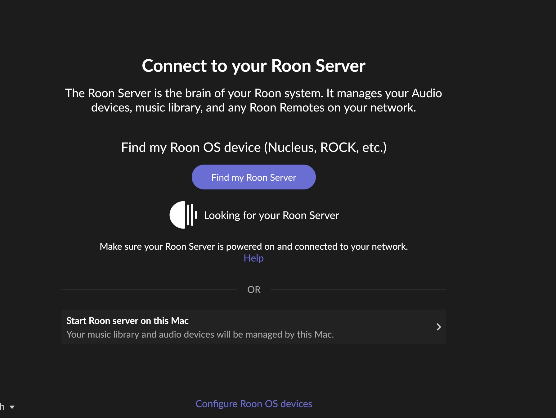

· My roon is not able to connect to my Mac server after the update in 2026/Aug/6. I ahve alrady tried everything I can do. I am long time Roon user.
· No VPN, Using my home WiFi network(No problem other apps and devices for now). Mac M1.
Hi @raitautsumi,
Thanks for reaching out. Since this is happening on your Mac M1 after the 2026/Aug/6 update, please click “Start Roon server on this Mac” and see whether that brings the server back online.
Please let us know what you see after that, and we will take it from there.

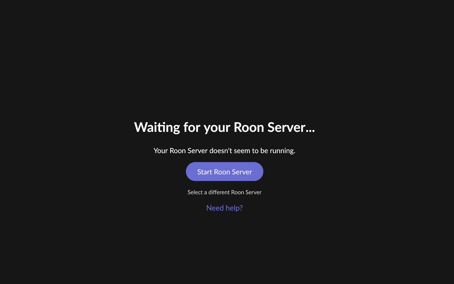

Thanks Noris,
After I clicked that button, this screen show up & nothing gonna be changed(screen never changed).
My Mac OS is Monterey 12.3.1. Is this the reason?

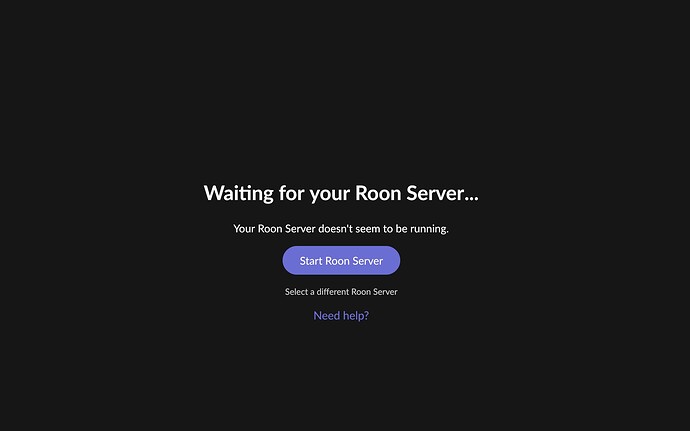

Your server is still running 2.70. Try to update it to latest build, you can download and manually re-install to be sure it get through.
Any specific reason you prefer running a 5y.o OS, while having an ability to run latest ?
Thanks vova,
I have installed your Roon download file, and replaced with mine.
But the result was the same..

Please don’t uninstall Roon or remove any Roon data. The logs indicate that an older RoonServer process is still running in the background and preventing the newly installed version from starting.
Now that build 1683 is installed, please restart the Mac. After restarting, open Roon normally and give the server a minute or two to start.
If it still cannot connect after a restart, let me know and I’ll collect the new startup diagnostics.
It’s fixed!! After my Mac restart.
