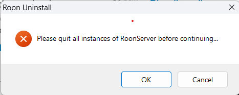

I tried removing all firewalls and privacy settings, and unable to connect. When I try to uninstall the app

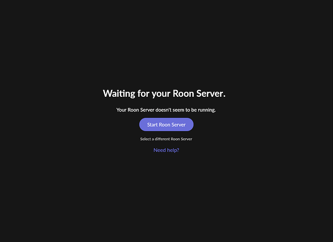

Cleared Cache - still will not connect using this PC - Windows desktop
Have you tried and clicked on “Select a different Roon Server”?
Have you tried and clicked on “Select a different Roon Server”? I don’t see this option. I am trying to use my PC as the server
Maybe you did this already though? Anyway, the message form the attempt to uninstall implies Roon Server is currently running, so maybe a firewall is blocking access:

I am unable to connect Roon to my PC - Windows 11 - I tried disabling all firewalls - I tried uninstalling Roon, but it says it is running in the backround
AMD Ryzen 5 6600H with Radeon Graphics - attlocal.net, connected by ethernet
Then you never uninstalled it. RoonServer is a separate program that gets installed when you install Roon. Look in the hidden icons section of the notification area of the Windows Taskbar, indicated by a carot like so…

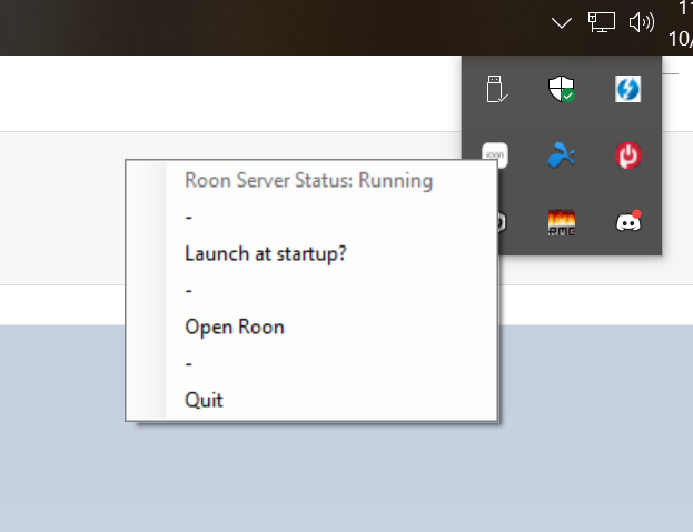

If you click that to reveal the hidden icons you should see a RoonServer icon, like so…
If you right click that icon, you should see a menu that allows you to stop the server, choose whether or not it starts at startup, etc. like so…
If you quit the RoonServer from that menu, that should allow you to re-install Roon without getting any messages that it is running.

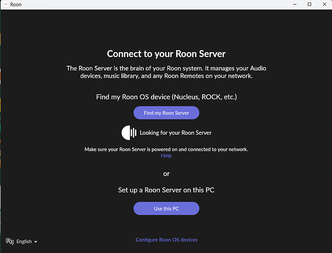

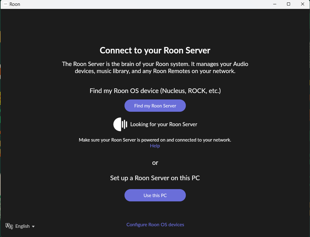

From your last screenshot I can see that you have an option “Set up a Roon Server on this PC”. Have you tried to use it ? Obviously, it means that it will be a new server .
However, if you want to reinstall Roon, please find a Roon’s icon in System Dock menu and disable Roon Server on Startup, that should allow you to safely uninstall Roon.

@Bradley_Tamkin - If, as you said earlier, you are trying to use your PC as your Roon Server, then the screenshot you posted “searching for Roon OS Server” is misleading - your Roon Server will be running on Windows, not Roon OS.
Roon OS is only relevant for Nucleus models or ROCK/NUC installations.

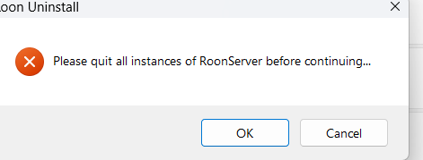

No matter what I do to try and uninstall it this message appears. I have tried in all the files and everywhere I can look
How do I make Roon Quit !!!
@alex_h gave you two methods to stop Roon Server running in his earlier post:

Have you tried to kill all Roon instances via Task manager ?
Other than that you can try to run the following command in CMD in order to kill all roon instances
taskkill /f /im roon*.exe
Let us know please if that has worked for you.

Yes I am good to go - Thanks
