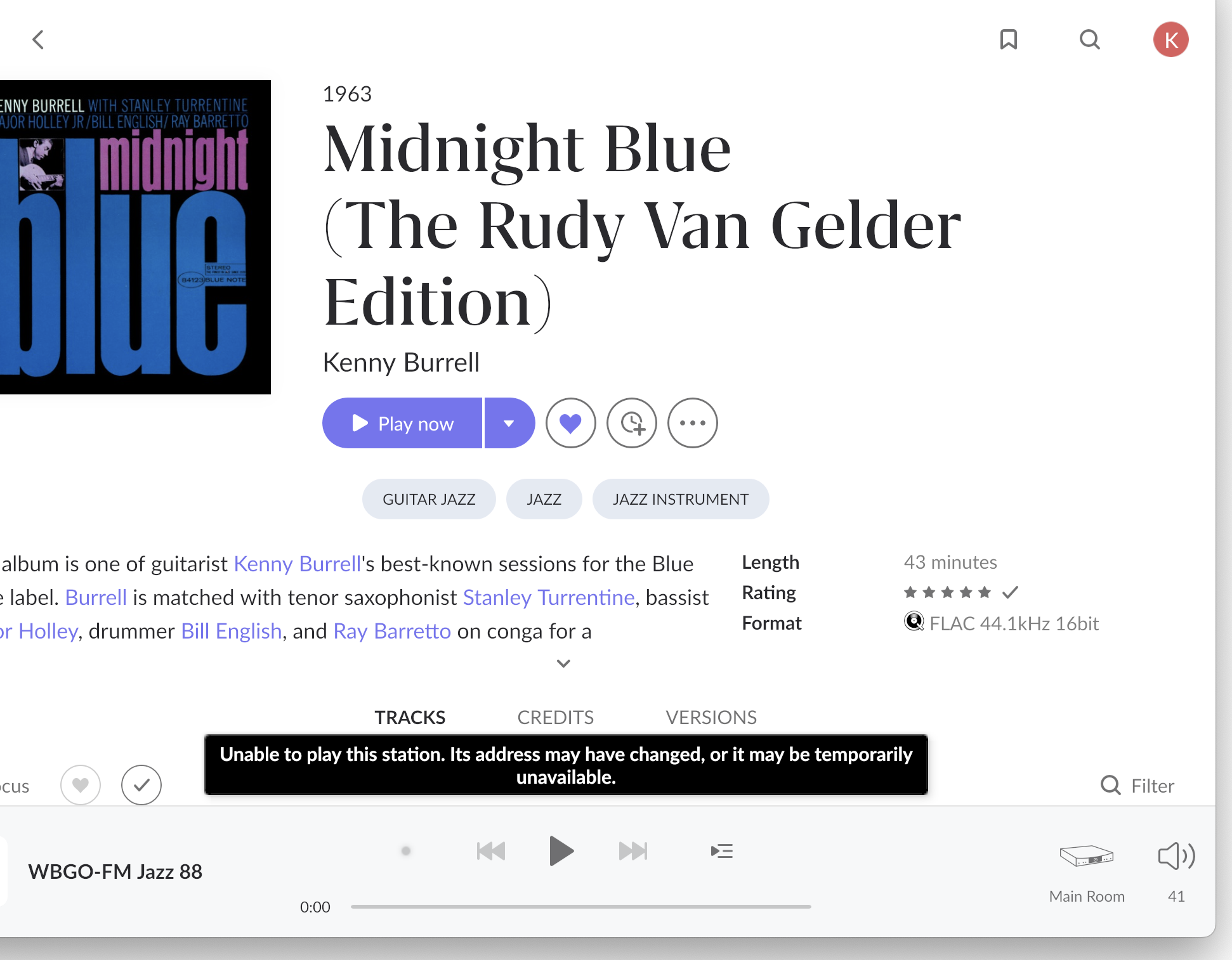

Just this week, Roon will no longer connect to WBGO.org in Newark NJ. I listen regularly and wondering if anyone on your support staff knows why.
Roon>Mac mini M1>Linn Akurate DSM/3 all connect to network via ethernet. All other music seems to be accessible.

It takes about 3 seconds to get that message.

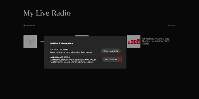

A workaround that I tested out just now is to add a custom radio station to Roon. You can use the below steps to do that.

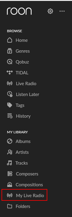

  1. Go to “My Live Radio” in Roon.

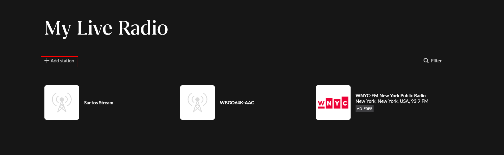

  2. Click the add station button.

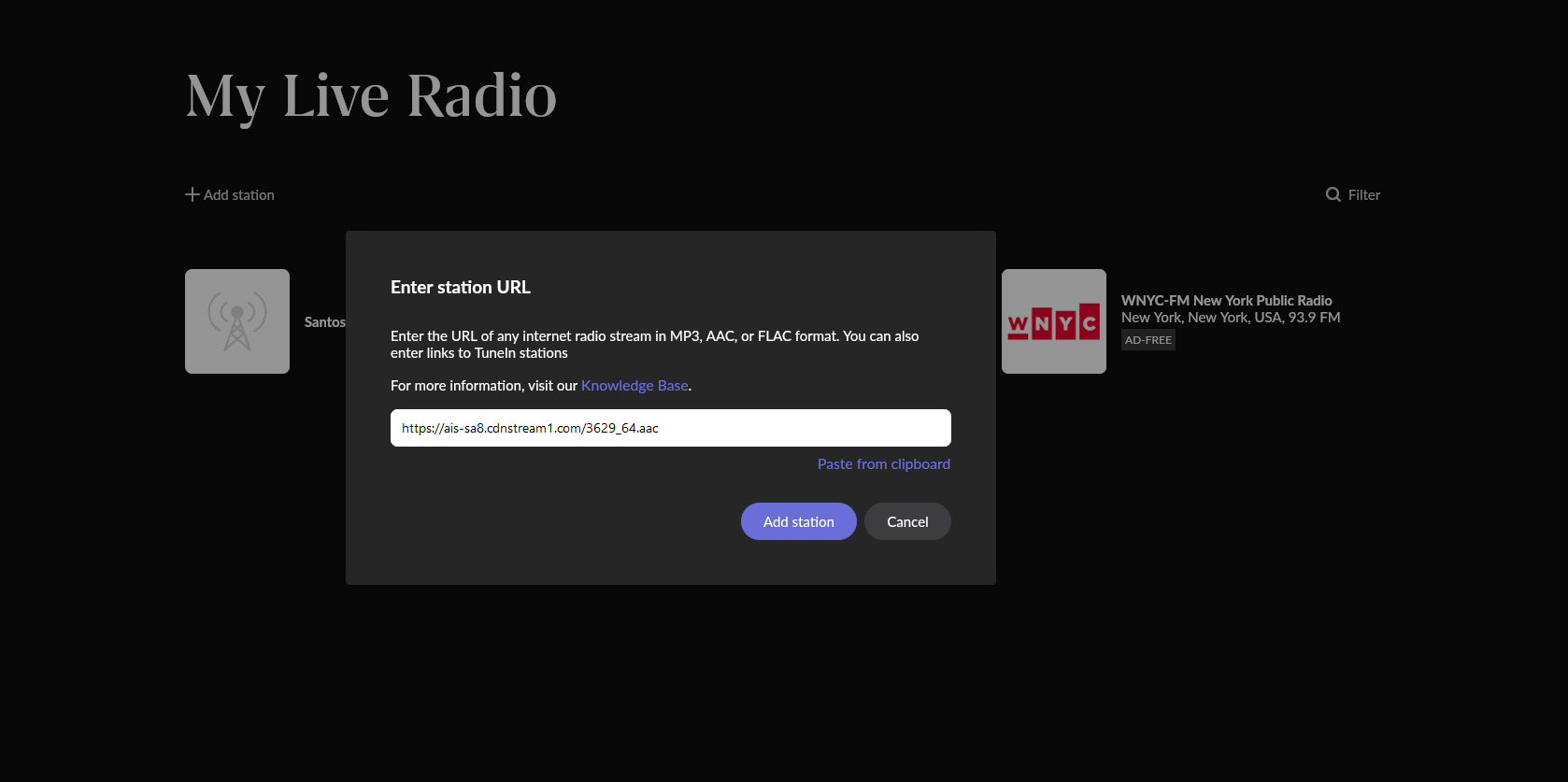

  3. Click “Add Station URL”.
  4. Choose one of the URLs that WBGO provides here. How to Listen Online | WBGO Jazz and add it as a station.
