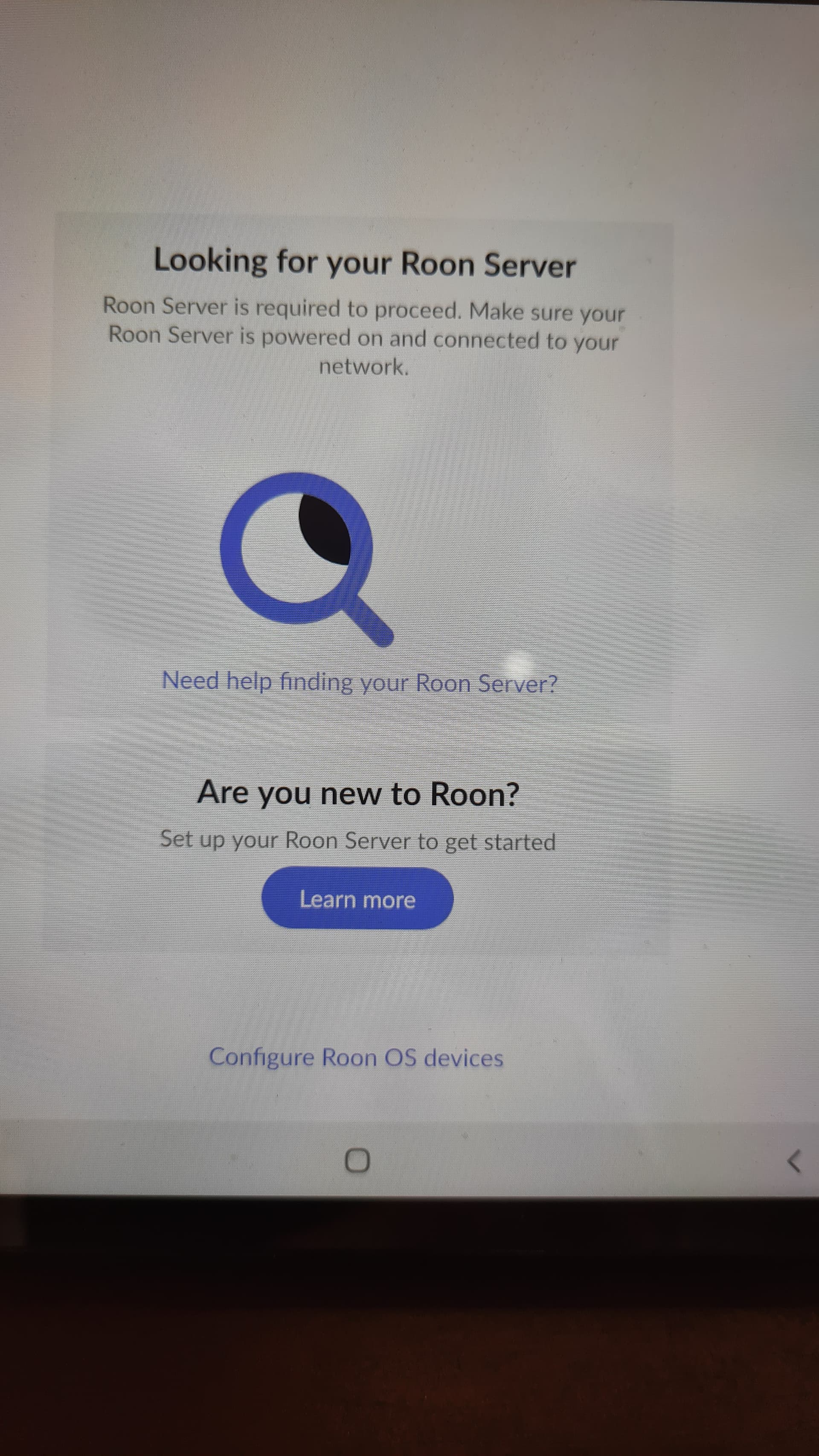

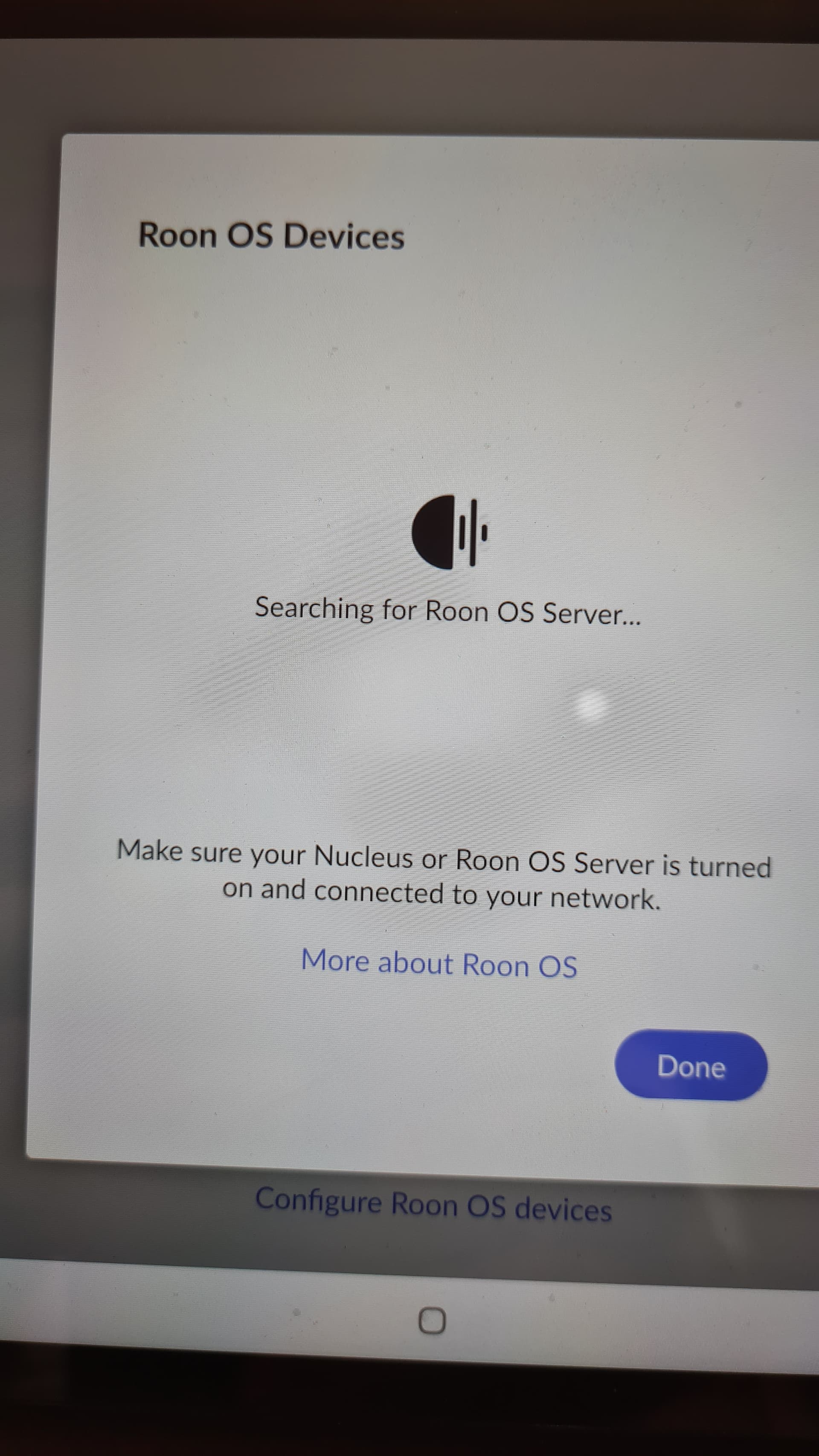

Roon unable to detect server (ref#FYPI3T)
· I'm having trouble with my Nucleus hardware
Roon not seeing server
Router to roon nucleus
When I was able to see the Nucleus it showed the ip address as 192.168…yet my pc shows 192.168…
Is this the reason now my system cannot find the Nucleus? If so how do I correct?
Thank you
Setup is router, to Bonn N8 switch, connected to Nucleus. Always been this way. I should point out that a day ago I was having an issue loging into a website, they recommended turning off my router and the turning it back on. This did the trick and allowed me acess. However the Nucleus connected first time today with no issues, only when I tried to start a song over it lost connection.
Now my pc says a different ip address?
I just tried again restarting the Nucleus again, this time it connected.
Not sure what exactly transpired, however all is now working. Can you explain what happened?
