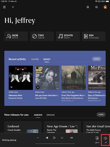

Remote volume control isn’t available on some endpoints/setups but it’s set up as follows:

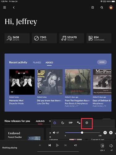

Click the volume icon in the lower right.
You may already see the volume control as pictured below. If not click the gear icon.

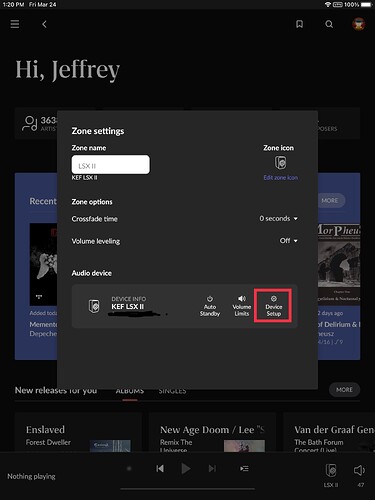

This will bring up Zone Settings and Audio Device settings. Click device setup.

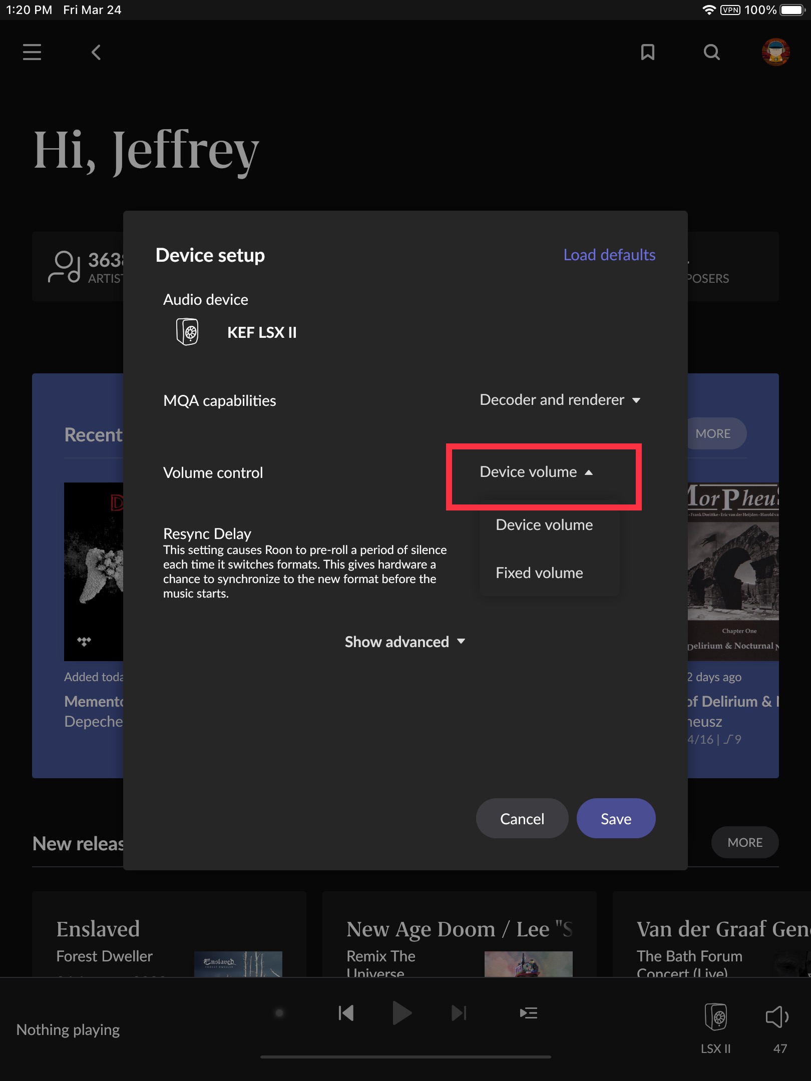

Here you’ll see the setting for Volume Control.
Click this and from the drop down select Device Volume.
As mentioned, this can be different or not available in some setups.
Here I’m using WIN 10 with an iPad.
If you’re seeing something different let us now and we’ll get you sorted.

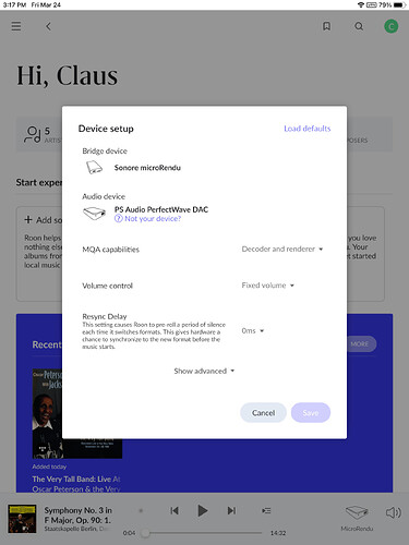

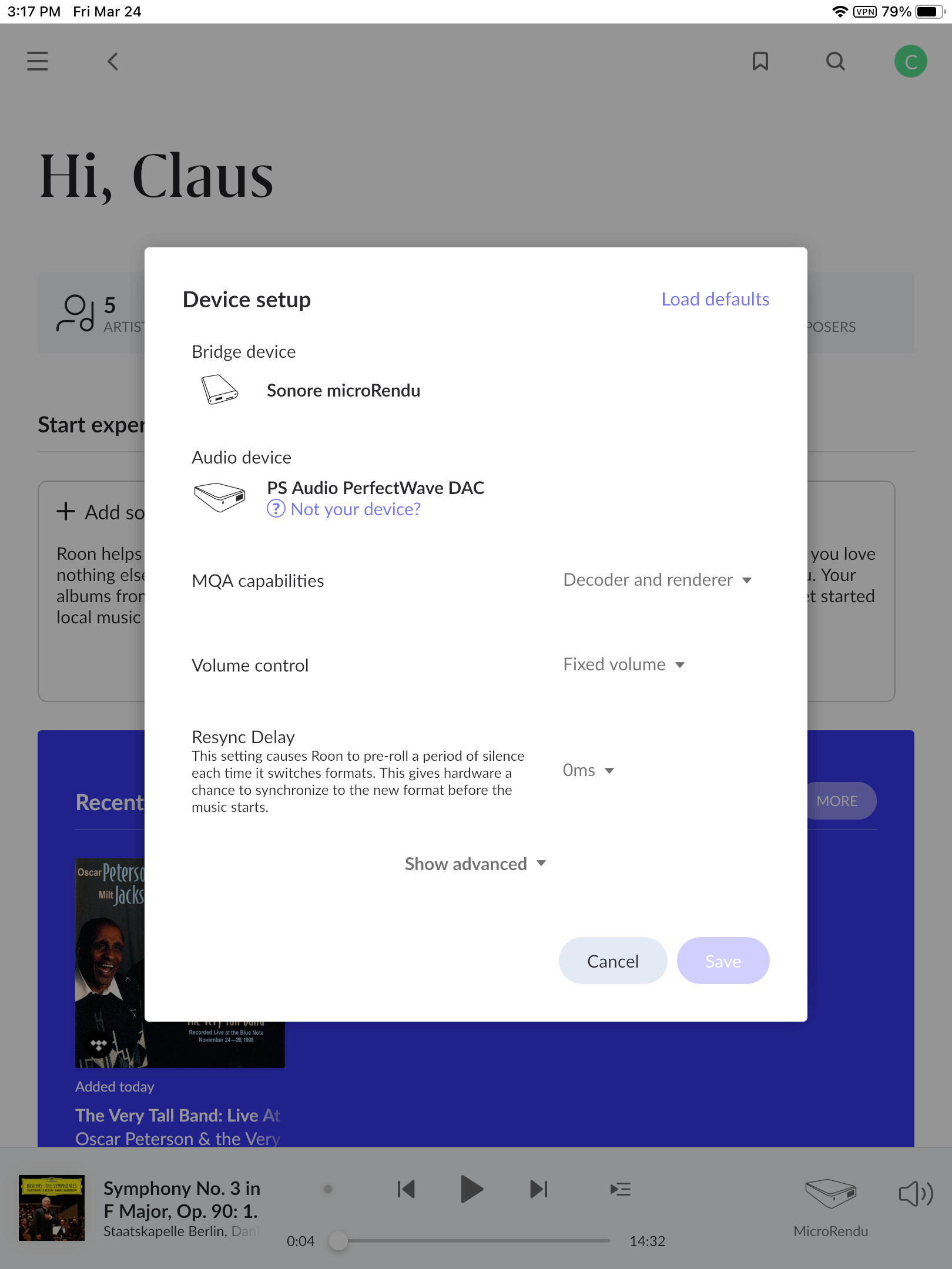

Seems it is not available on my setup (see screenshot).
But perhaps you have another idea?
You can’t click Fixed Volume and change it to Device Volume?
I’m not certain but that might be a result of that particular DAC.

When I click on Fixed volume and try to switch it, it goes “gray” and does not change, soI am stuck with fixed.
My DAC is a PS Audio Nuwave DSD, and I called the manufacturer and he had no idea whether Roon would be able to do this.
But when I used Spotify, I was able to control the volume on my remote, so I think we can rule the DAC out and just deal with ROON.

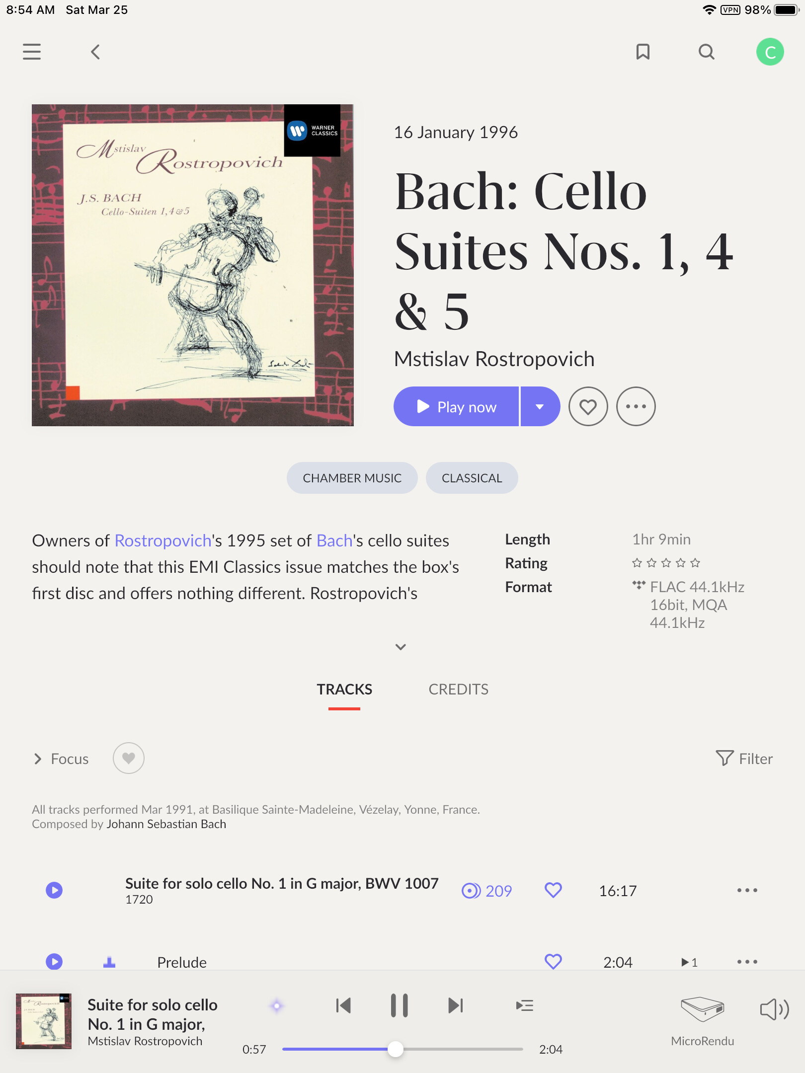

I am playing the below album and it has the following specs:“FLAC 44.1kHz 16bit, MQA 44.1”.
How is that different than playing a CD of the same recording???

The recording you have posted is using the MQA format. Originally MQA was used only for hi-resolution files but Tidal is gradually replacing 16/44 FLAC with MQA.
It’s a controversial topic: Some say MQA sounds better, some say worse, and others say the difference isn’t perceptible.
Others (such as myself) aren’t too concerned with the sound differences but have concerns about MQA’s business model etc.
Essentially though, in this case in terms of sample and bit rates, it is the same as CD.
