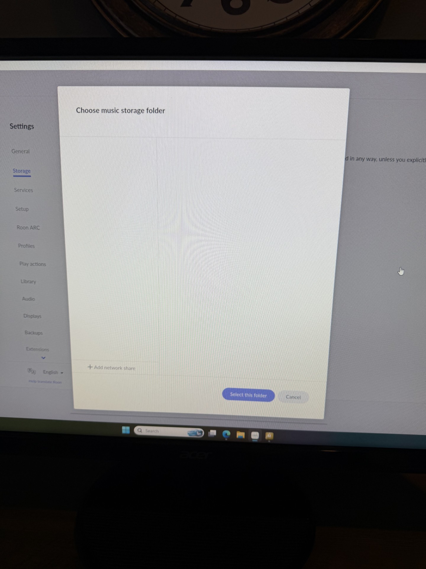

Nothing I type in for a path works. The “locally attached USB drive” is where my music files live. The path, that has always been there on my computer is: E:\Music Copy\Main Music Rips 44.1K. Any variation of this path that I tried does not work. I don’t know what an SMB is, I did not have this problem until the last Roon Update, that is when it started. Again, I had no problem loading my music files into Maestro . I am about ready to bail on Roon and rely soley on Maestro.

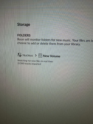

I will go with number 3. I have no faith I will ever see the E drive showing in Roon on my desktop again. My desktop is to be just a remote as is my I-pad. Roon server or whatever it is called is the Nucleus as that machine rarely has, if any, problems unlike a regular computer. I am discovering that Maestro continues to have issues that don’t seem to get corrected so I don’t know how much longer I will be with that service but I would like that app to see the WD. Hence, #3. Thank you.
Hey @doug_ward,
Option 3 is a good choice, the Nucleus is purpose-built to be the always-on Roon Server, and this gets you out of the drive-letter game entirely. Here’s the whole path from where you are now to where you want to be. Take it one step at a time and don’t skip step 1.

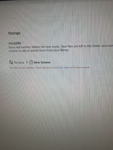

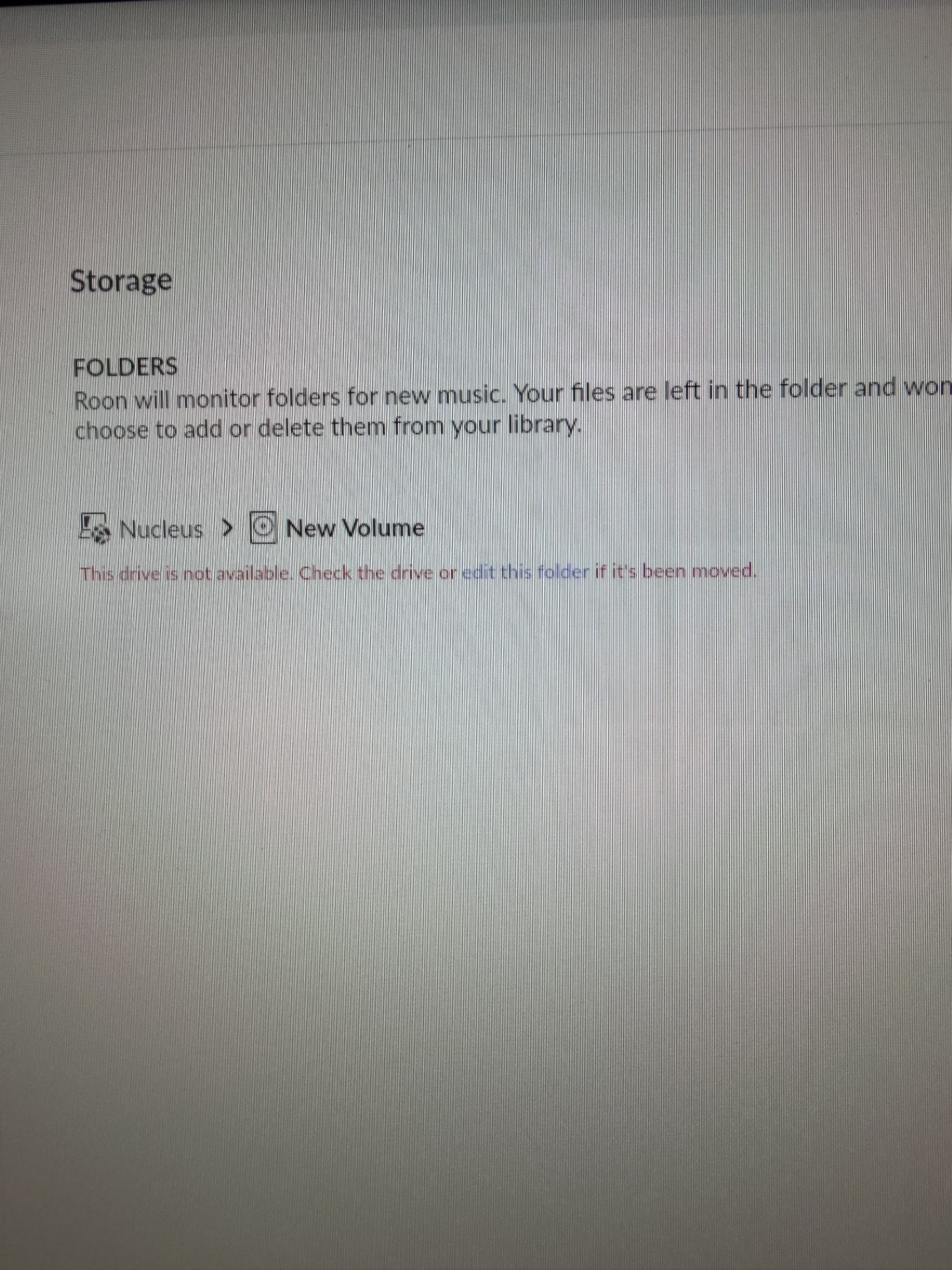

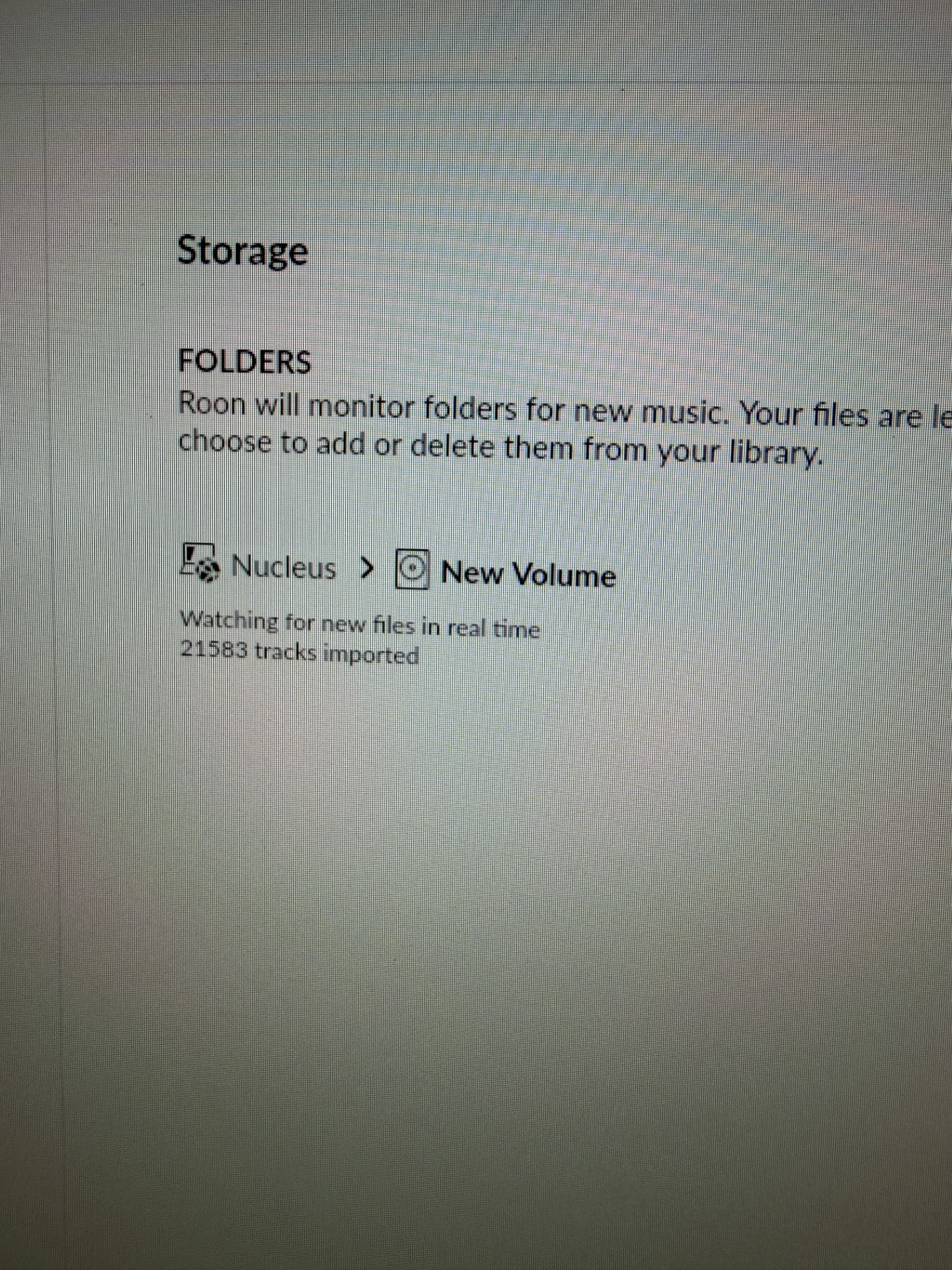

Step 4, Point Roon at the drive’s new home
After the restore, go to Settings → Storage. You’ll see your old E:\Music Copy\Main Music Rips 44.1K entry, and it’ll be flagged as unavailable, expected, since there’s no E: drive on the Nucleus.
  1. Click the next to that entry and choose Edit.
  2. Change the path to the WD as the Nucleus sees it, you’ll be able to browse to it, and it’ll look something like /storage/My Book/Music Copy/Main Music Rips 44.1K.
  3. Save.
Editing the existing entry rather than deleting it and adding a fresh one is what keeps your edits and playlists attached to your files. If for some reason Edit won’t let you browse to the drive, remove the old entry first, then add the new location, your files will still come back in, it just does more re-identification work.
Then let it work. 26,000-plus tracks takes a while to scan and analyze; the spinner in the top right tells you when it’s finished. Don’t judge anything until that stops.
