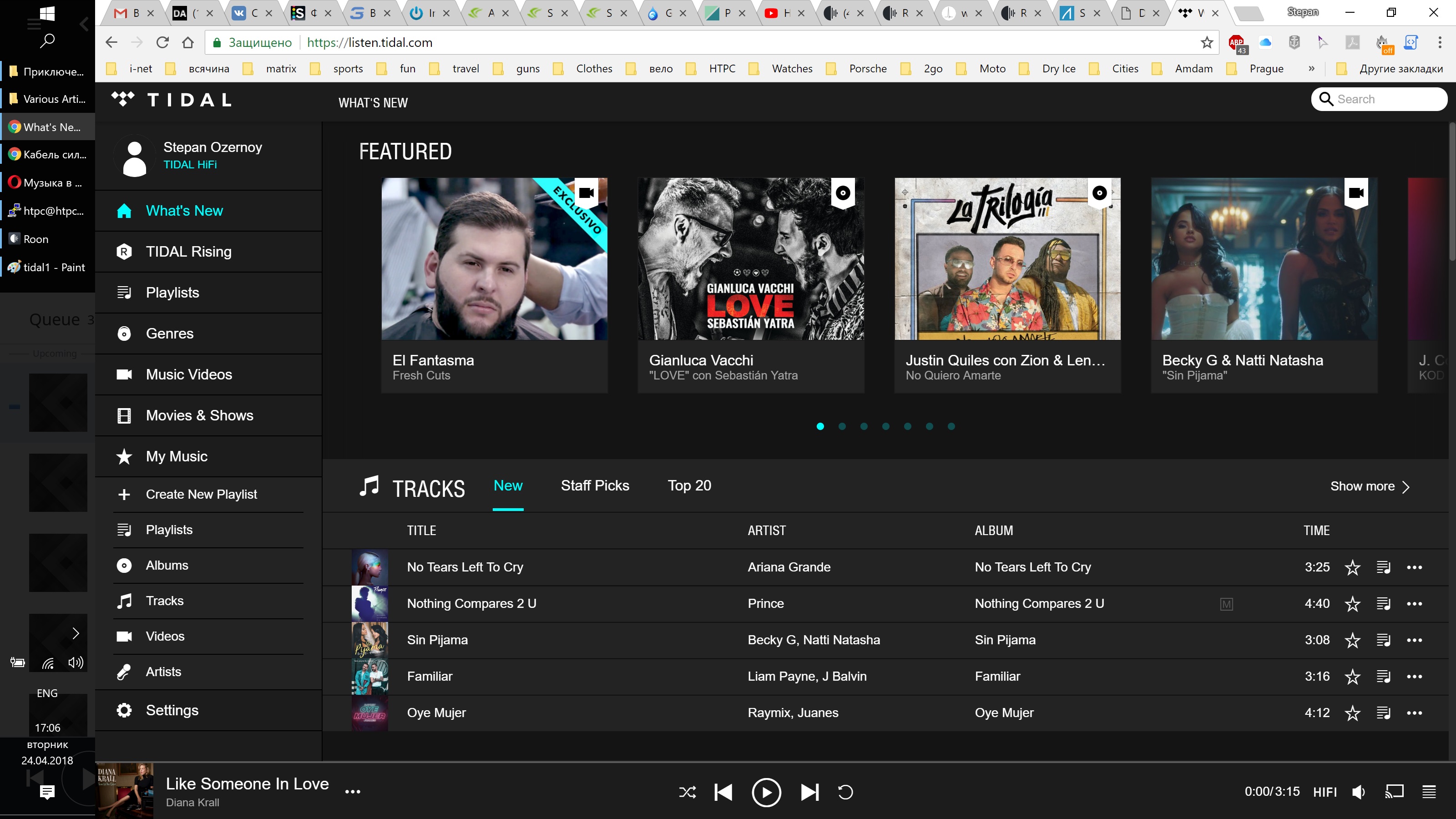

I have the same issue with Tidal, getting Network error: Please check your connection message trying to relog into my Tidal account on Roon. Tidal in Chrome works fine at the same time. Did reboot my core, cleared cache, any other suggestions?

Thanks a lot for keeping attention to my issue. I’ve tried to log in to Tidal half an hour ago - no luck again,same network error. Th thing is I’m leaving today and come back on April 30th so I’ll try to check if problem is still there only in a week - I’ll give you an update.

Well nope, same error, Tidal in browser works fine. I’ve relogged into Roon - same error, please check if you see anything in logs.

Well, sorry for a late reply, I finally sorted out my Tidal issue (well mostly, atm Roon doesn’t load albums covers while browsing Tidal, showing these only when added to my library, but that’s not that big deal for me). The reason of Tidal not working was that several IP addresses were blocked by my internet provider due to some stupid new directives of Russian government… so the cure was to set up a VPN service for Roon and run Roon traffic through it.
So, the issue was on my side, not on Roon servers one, but still thank you for help and keeping attention to it!
