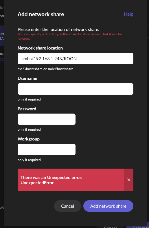

Roon won't mount network attached drive for backups. It connects to one of my network servers but not the other which it was connected and doing backups until today. When I tried to add again thenetwork share I got the message "unexpected error". Nothing was changed in the original network configuration. The share can be accessed from my Mac from menu Go to server...

Thanks for writing in to ask us about this issue. I activated diagnostics on your account and found traces of network issues. Additionally when you tried to add the drive we saw a trace saying invalid operation. Are you able to mount the drive outside of Roon? If you can please copy that network path and try adding it that way.
Thanks Daniel

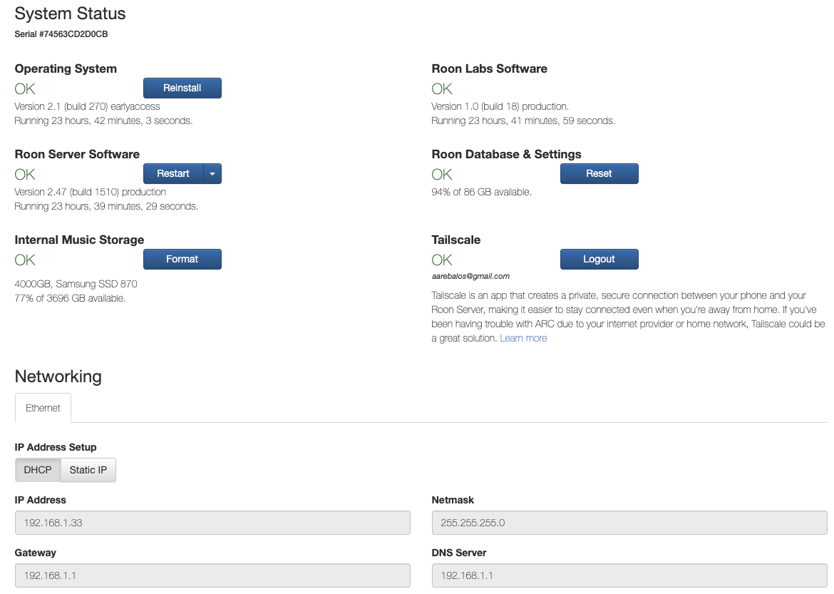

If you could, please move your server back to your Nucleus, and attempt to access Arc again. You mention using Tailscale - could you please share a screenshot of the webUI of your Nucleus? Here’s more info:

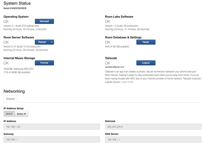

Well, looking my Nucleueone page I saw that DNS was 0.0.0.0 which is weird. I went to my Tailscale page and discvered that “Magic DNS” was allowed. I unchecked Magic DNS, and now DNS at NucleusOne is back at 192.168.1.1 and seems working.
