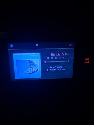

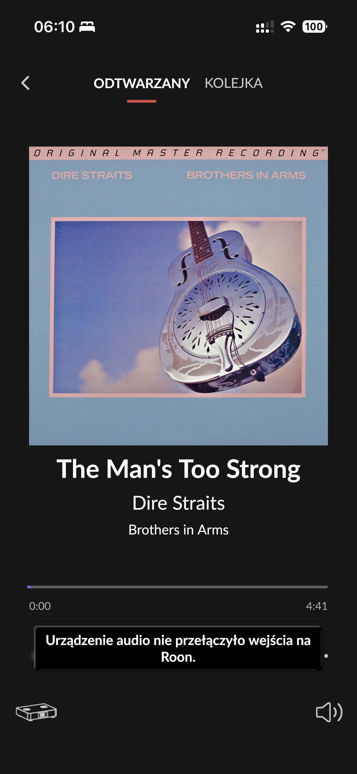

Hi. I use Roon Ready, I won’t display Signal Path because Ayon doesn’t start playing, after turning on the DSD file it will only display the cover and lock the player. I have to turn it off manually because it can’t even change the song to another one. The player seemed to freeze. I will add that Ayon directly plays DSD files via UPNP, only when using Roon this problem occurs.
