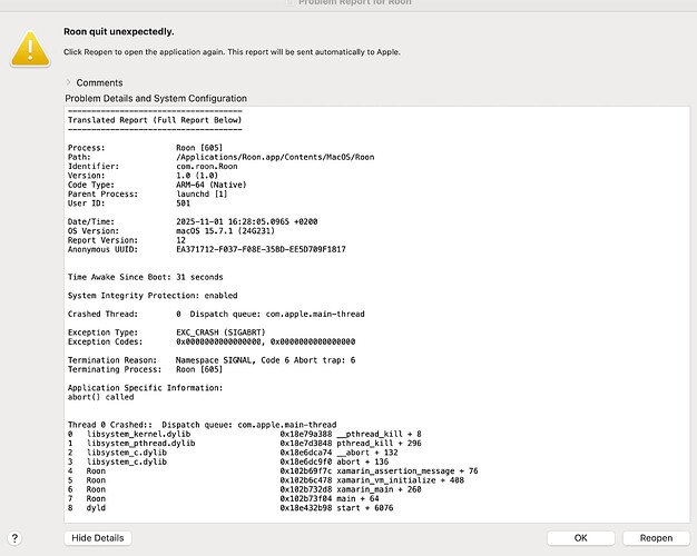

I have since my last message re-booted the server a few times and also now get this message when re-booting. This also never happened before.

Thanks for the additional information and the screenshot! Could you please bring your Roon Server back online - we’ve enable diagnostics and should be able to take a closer look into what might be going on.
