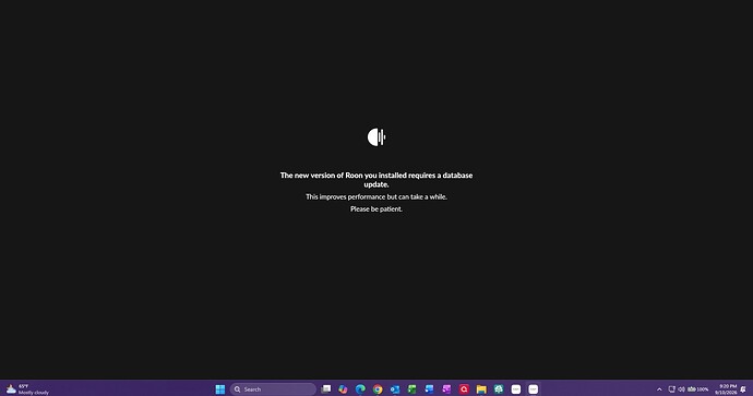

After doing this daily, on September 10 I also received a “The new version of Roon you installed requires a database update” message; after performing the update everything loaded and continued to work fine.

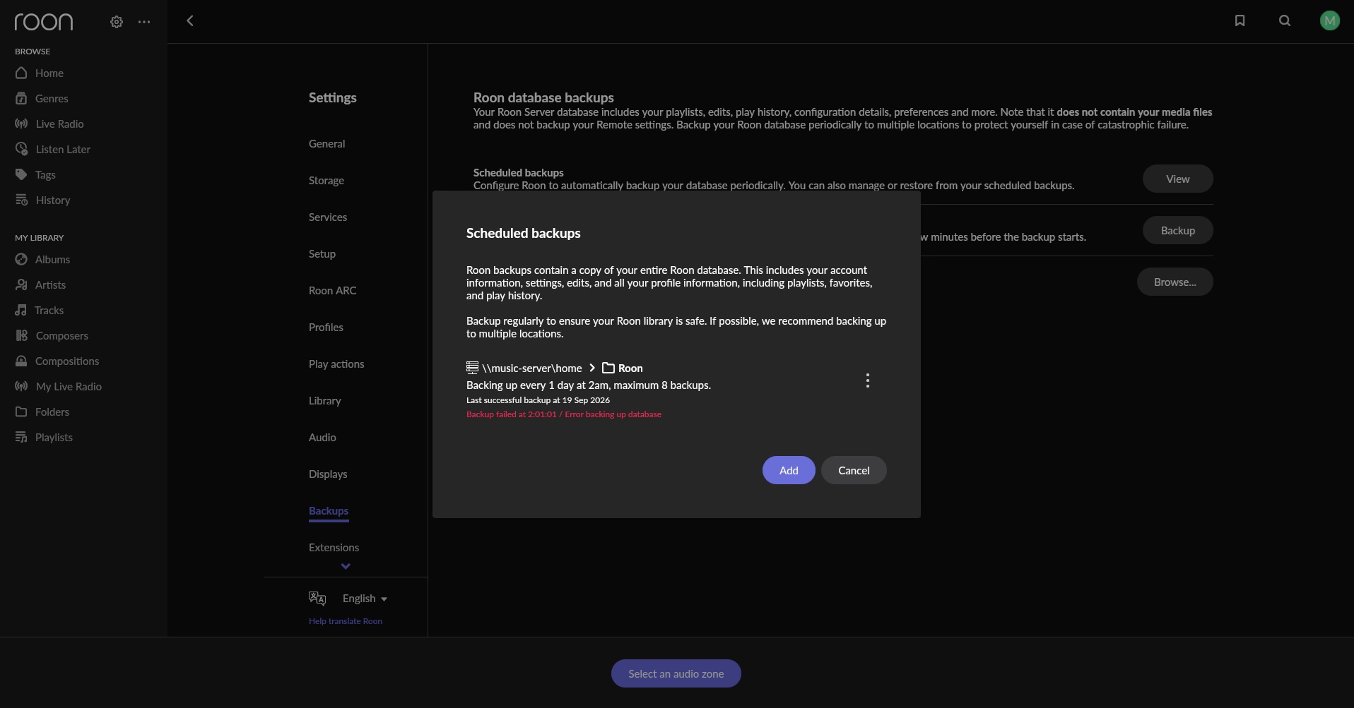

On September 12, I realized that if I had to reboot ROCK every morning, maybe there was a problem with the backups. I checked and Roon said the backup had failed, with the last good backup the one just before the Internet went down.

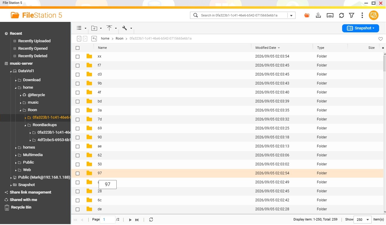

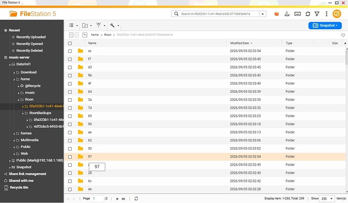

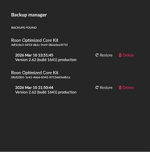

The ROCK backs up to the NAS, and I can see the backups in file manager on the NAS, with the most recent files being backed up dated September 5, the morning before losing Internet. However, when I try to restore this backup, it only finds a version from March that I used when I set up the new ASUS NUC.
I tried copying the files to a flash drive and plugging it into the NUC, but Roon still failed to recognize them as valid backup files.

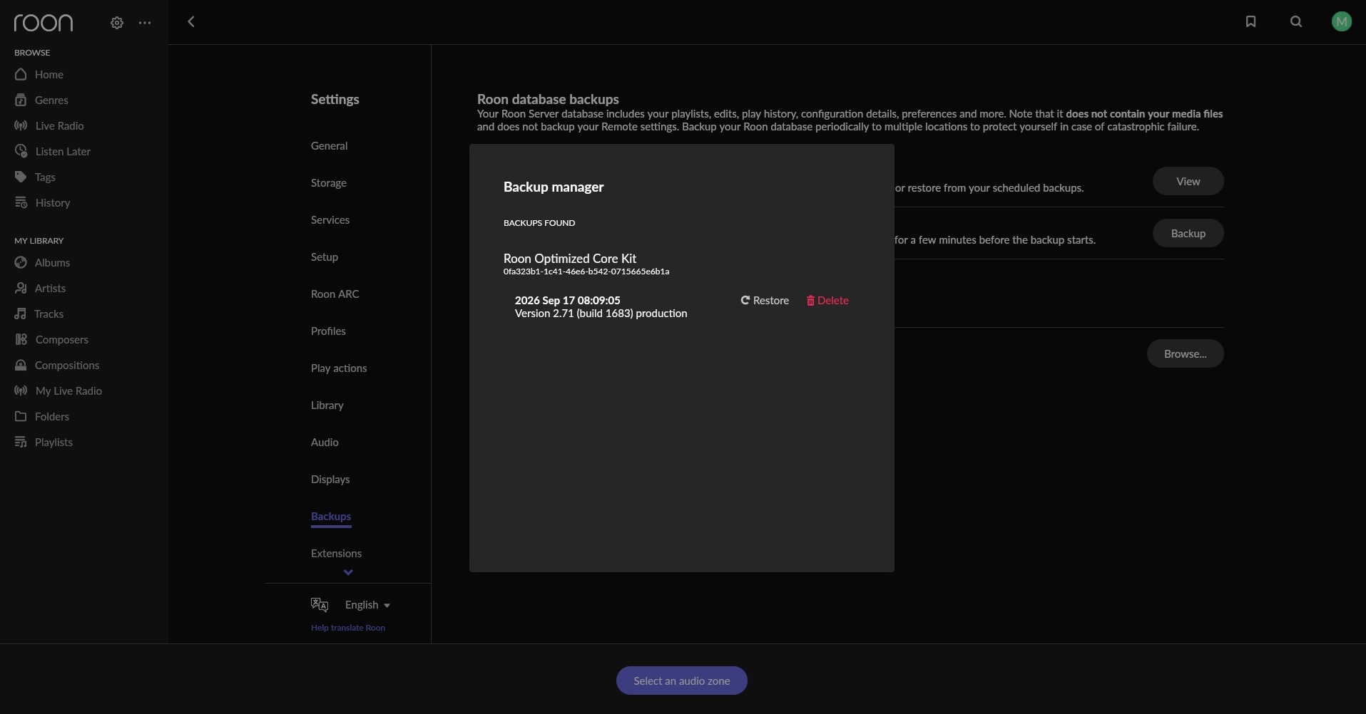

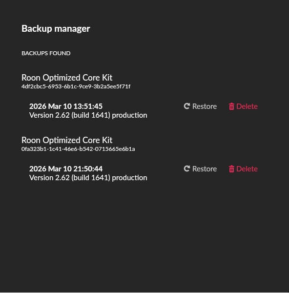

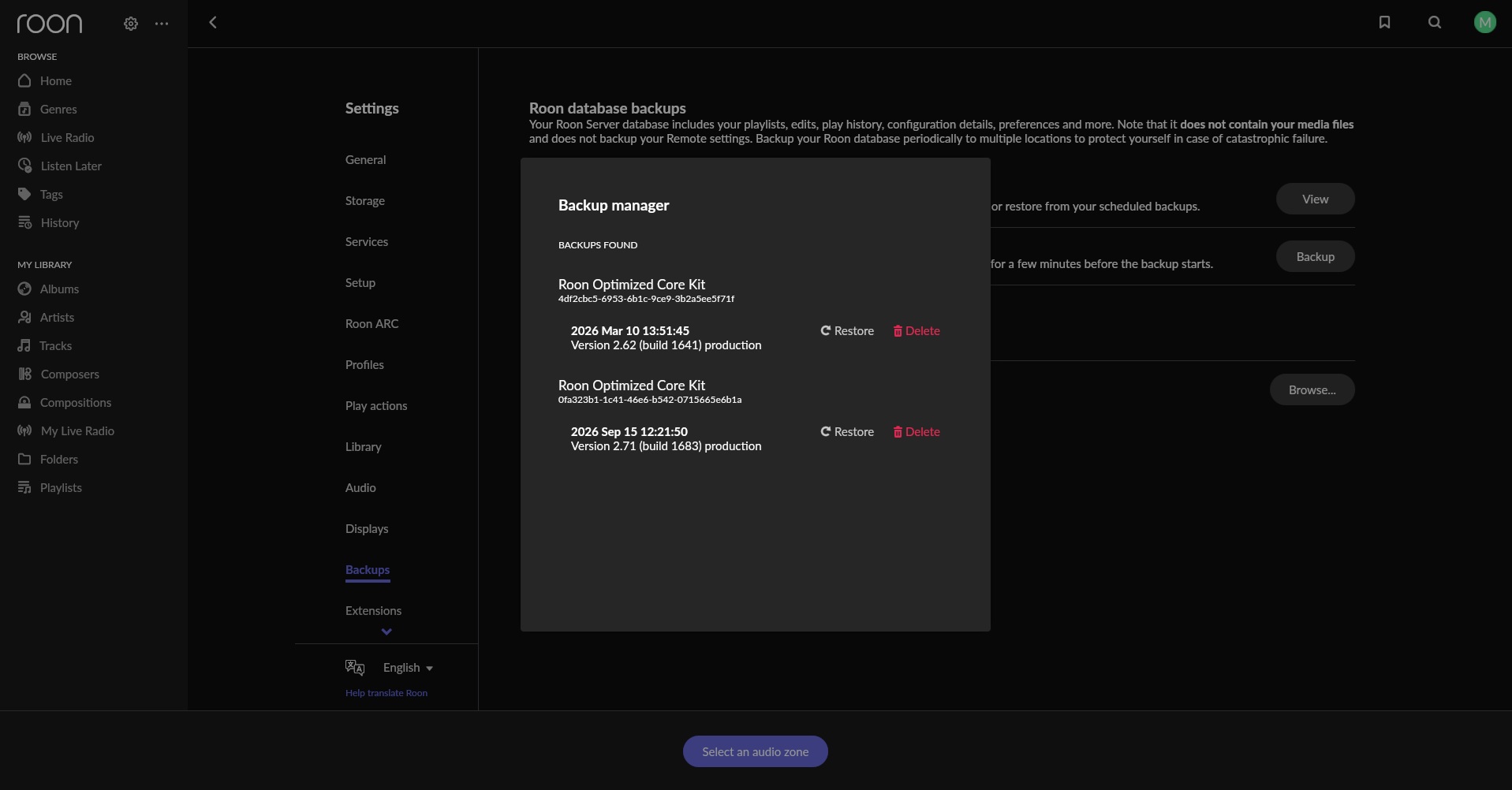

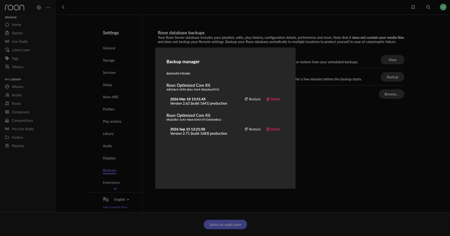

Two days ago, I restored the March 10 database with no problems. Roon identified the files that had been added subsequently. Just to be safe, I immediately did a manual backup. I didn’t try to edit the database that day, as I wanted to make sure the scheduled backup worked correctly. Yesterday morning I checked the Scheduled backups, and it stated that there had been a successful backup overnight. I spent much of yesterday editing the database. I observed some strange behavior with image files (which I will describe in a subsequent note), but otherwise everything seemed to be coming along fine.
This morning I checked again, and it showed a successful backup at 2:04am. However, the backup summary screen said the last successful backup was my manual version from two days earlier. If I try to restore a backup, Roon only finds the March 10 backup and the manual backup from two days ago. However, there is clearly a backup from this morning on the NAS.
I did another manual backup this morning, and it is also available to restore. It seems that the scheduled backups created by Roon cannot be restored for some reason. If the scheduled backs done previously had been able to be restored, I would not have lost 6 months of effort when my database had problems last week.

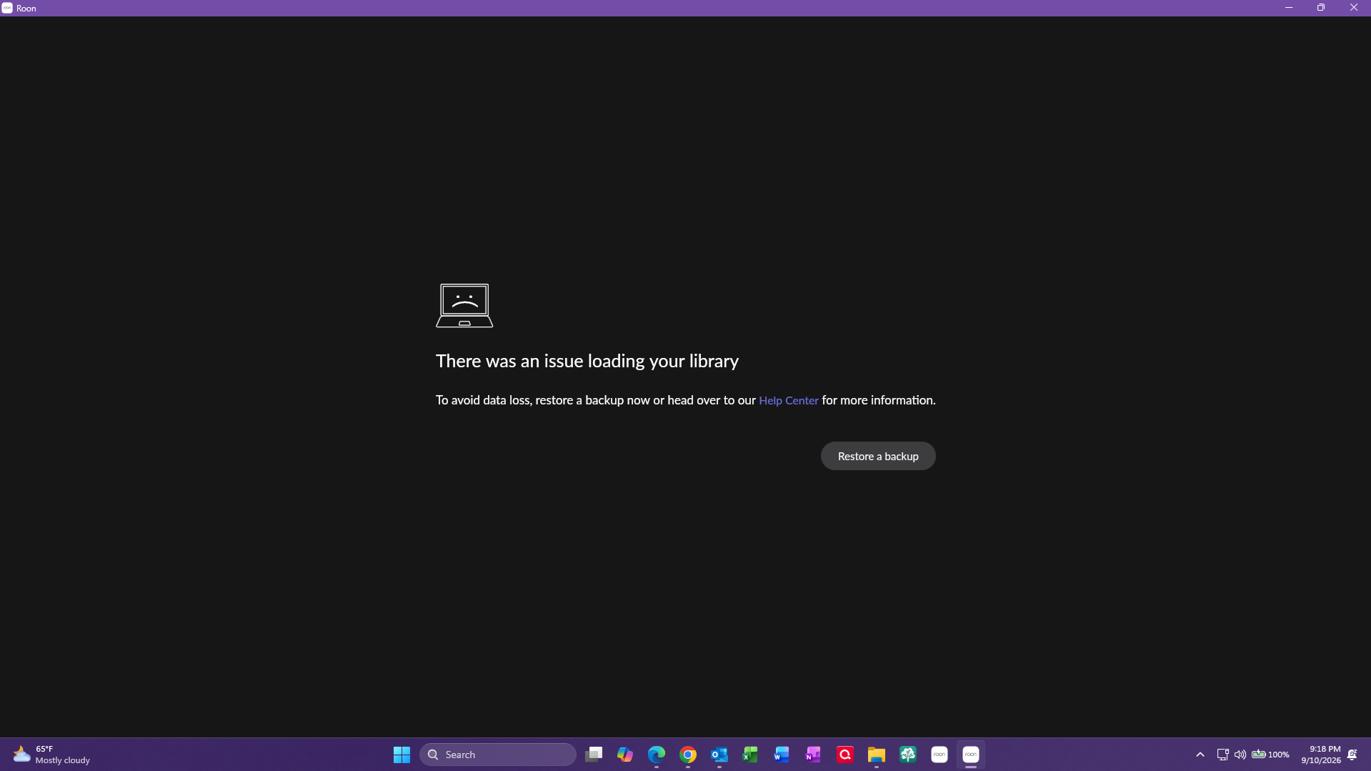

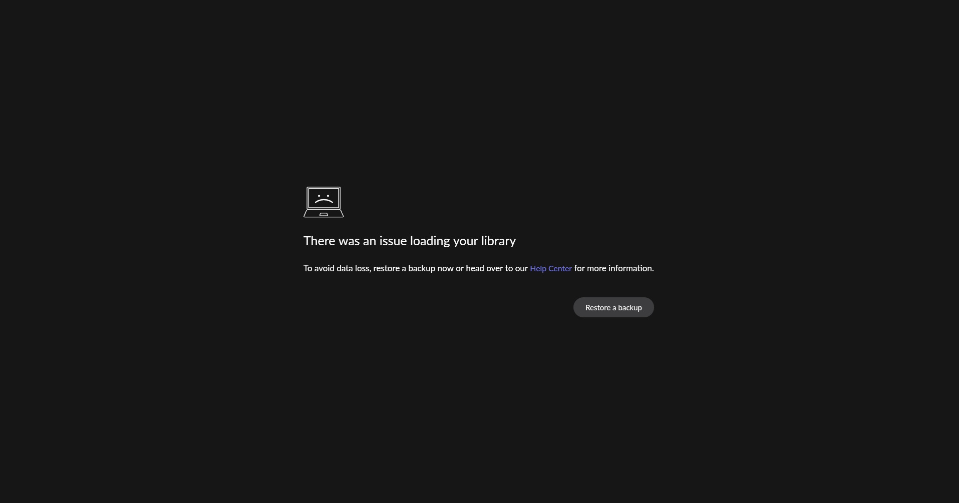

One additional bit of info. For some reason last night Roon Rock had a problem, so when I tried to use Roon the morning I received the “There was an issue loading your library” message. This time I was able get ROCK restarted via the web interface. The scheduled backups screen showed that the backup failed, stating the the last successful backup was on Sept 19. However, backup manager shows the most recent backup to my NAS to have been on Sept 15 (which is correct, assuming that Roon is always unable to perform scheduled backups).

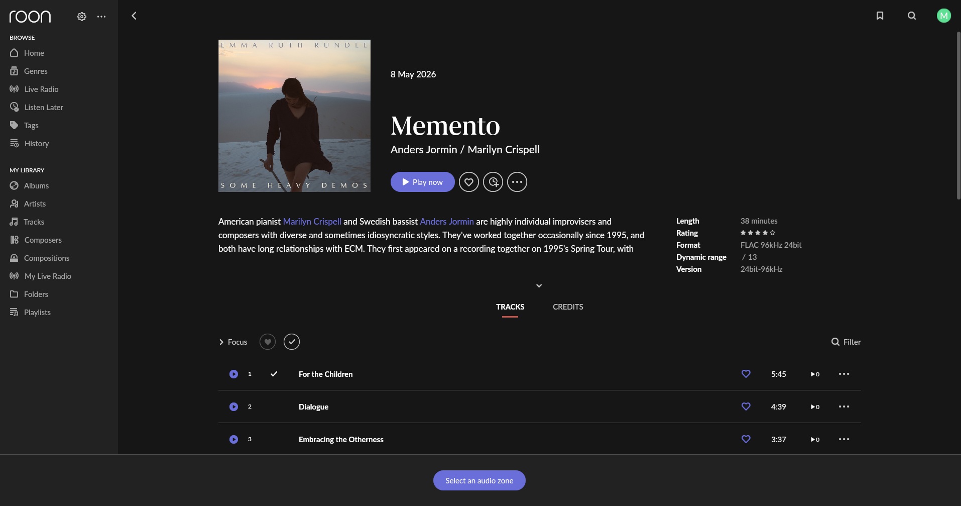

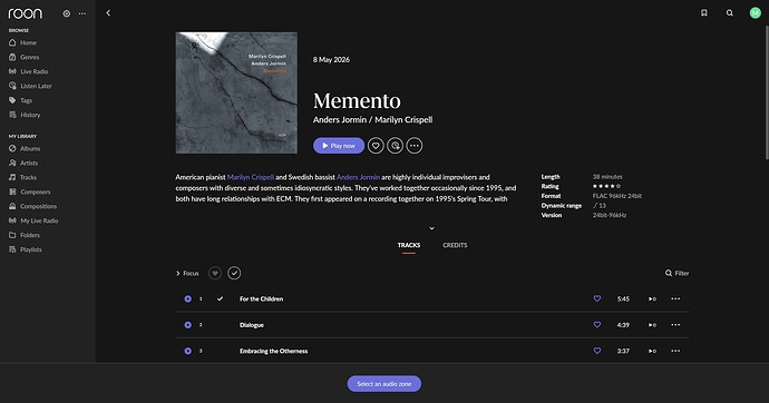

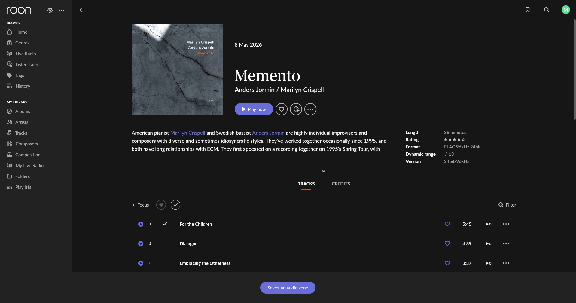

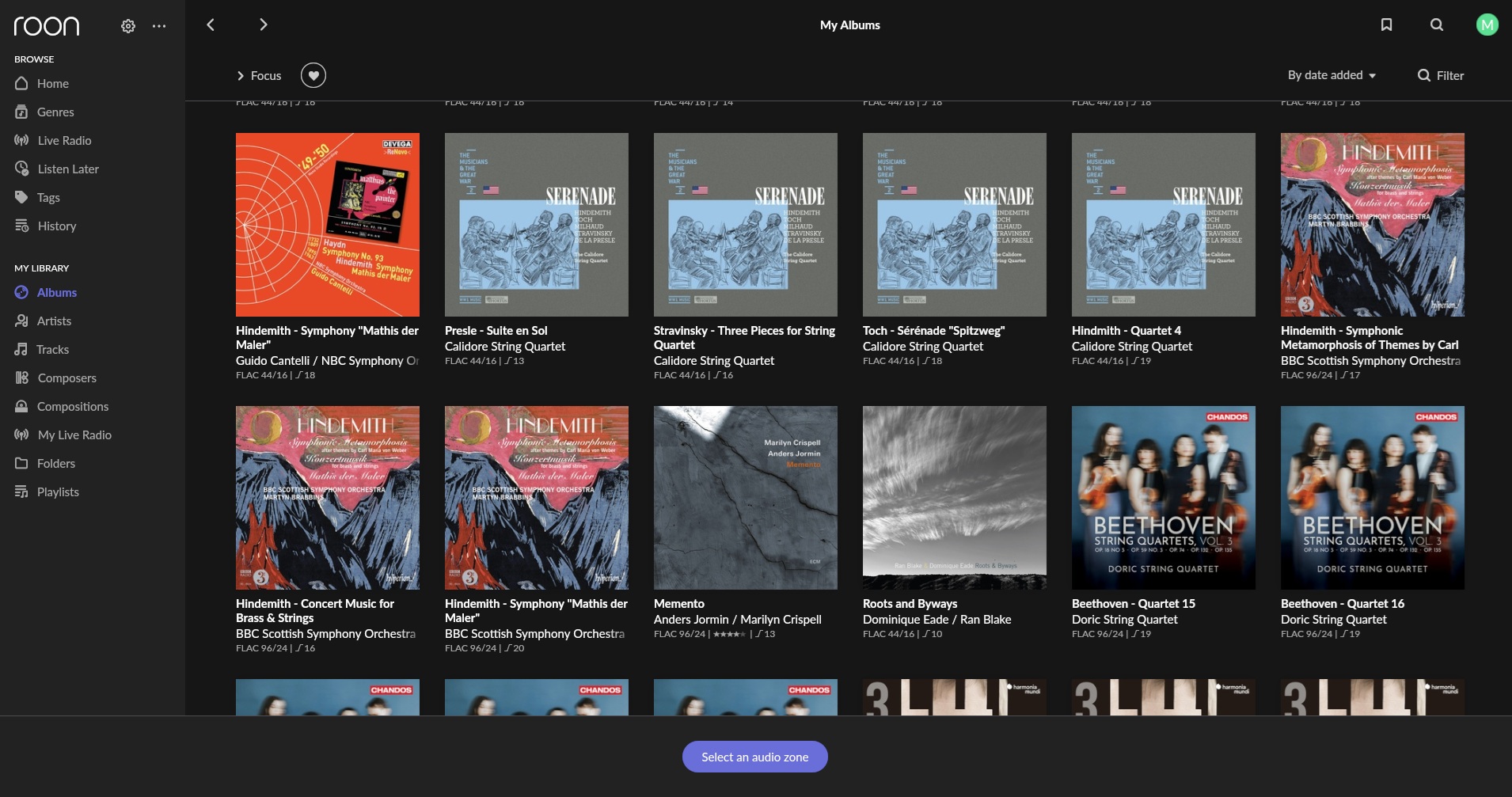

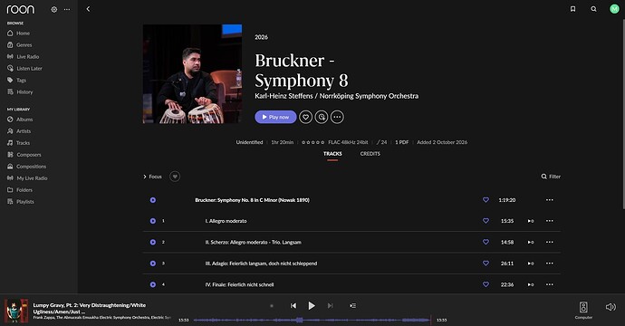

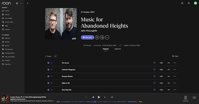

When Roon has been working over the past few weeks I have noticed bizarre behavior with album art. On perhaps 1% of the new additions, the album art shows up correctly on the main page, but when I click on the album it brings up a random album cover (images below). This goes away once I open any other album. One two occasions the main page shows a random cover, but the album page is correct. I can only fix this by downloading a new jpg of the cover.

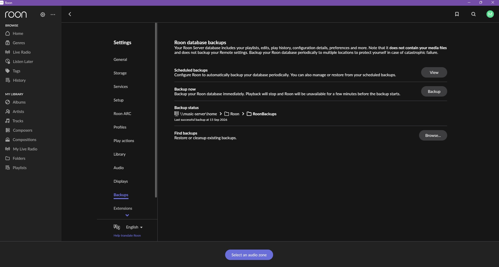

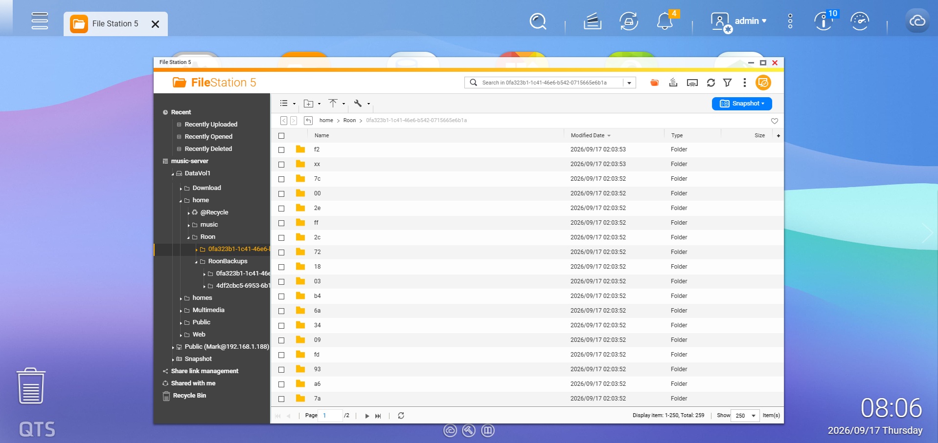

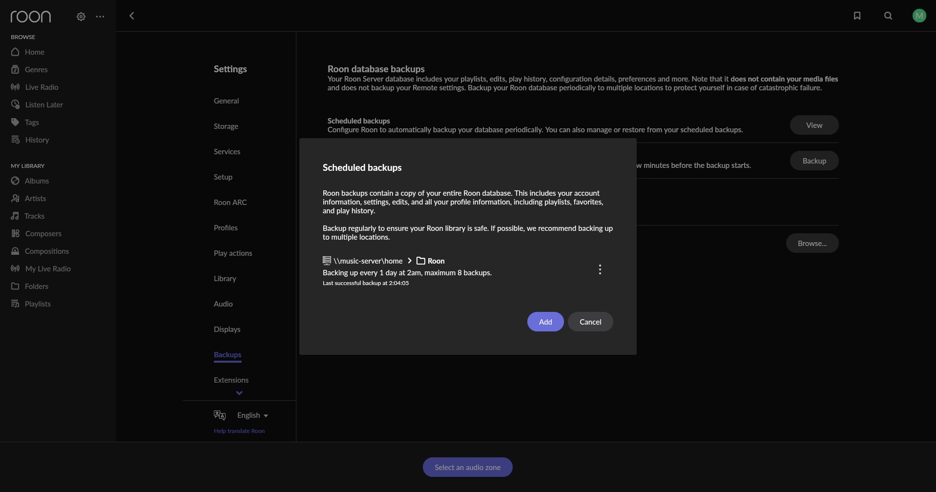

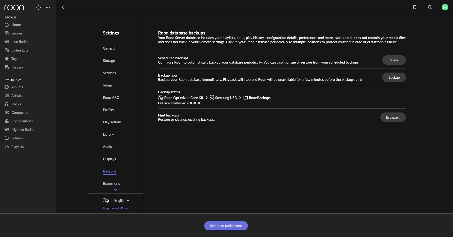

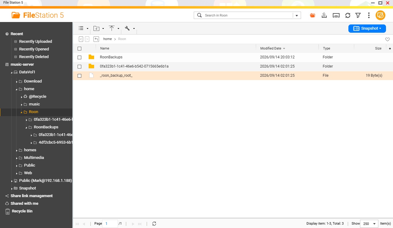

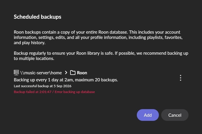

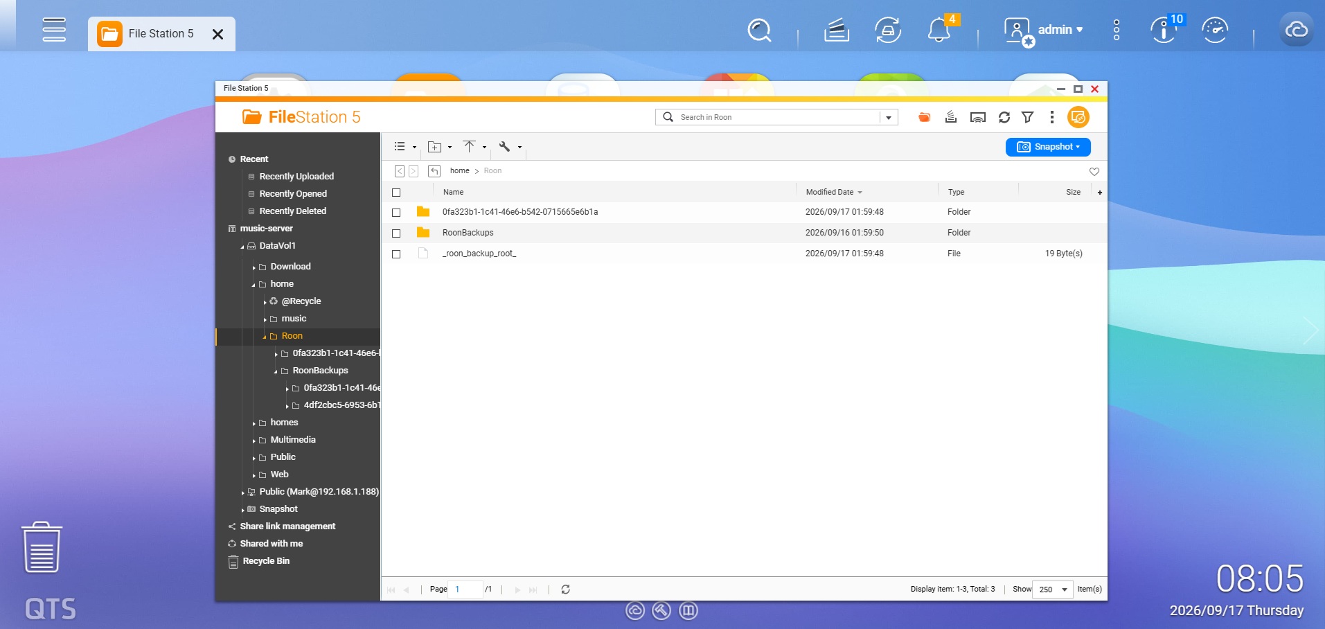

What we can see is why your scheduled backups have not been showing up. You have two backup folders on the NAS:
  • Your manual backups go to \music-server\home\Roon\RoonBackups
  • The scheduled backup writes to \music-server\home\Roon
Those are different locations, and the restore screen only lists backups from the folder you point it at. When you browse to RoonBackups, this morning’s scheduled backup is not there, because it went to the folder above it. The backup ran, it just landed somewhere you were not looking.
Please check this: go to Settings > Backups. You should see more than one scheduled backup location listed. If so, please send us a screenshot of that page.

Automatic backups are switched back on. That is not something going wrong: restoring your 15 September database also restored the backup settings as they were on 15 September, and the schedule came back with them.

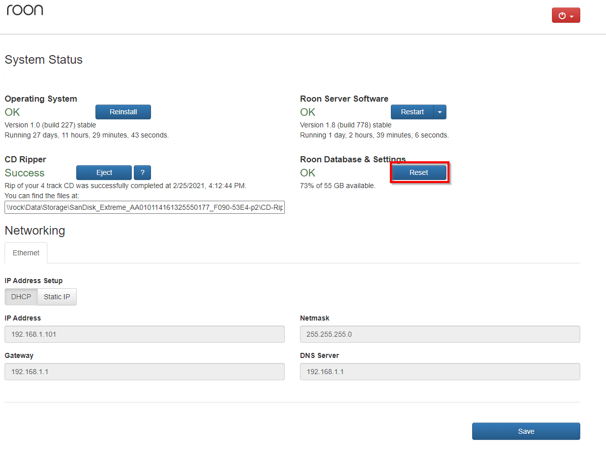

I suspect there may have been some remenant let over from the previous database. Can you please try to reset the Roon Database + Settings in the RoonOS WebUI and restore from a backup?
Please, let us know how that procedure goes.
Noris
Thanks for the help - resetting the database seemed like the perfect solution. I was able to listen to music after resetting and loading the backup. Yesterday I decided to edit recent additions and add missing artist photos. Everything seemed to go well, although I still had two instances of Roon showing random artist photos instead of the album covers (eg - the 2 albums at the right of the 1st row). Unfortunately, when I got up this morning the system had crashed again.
