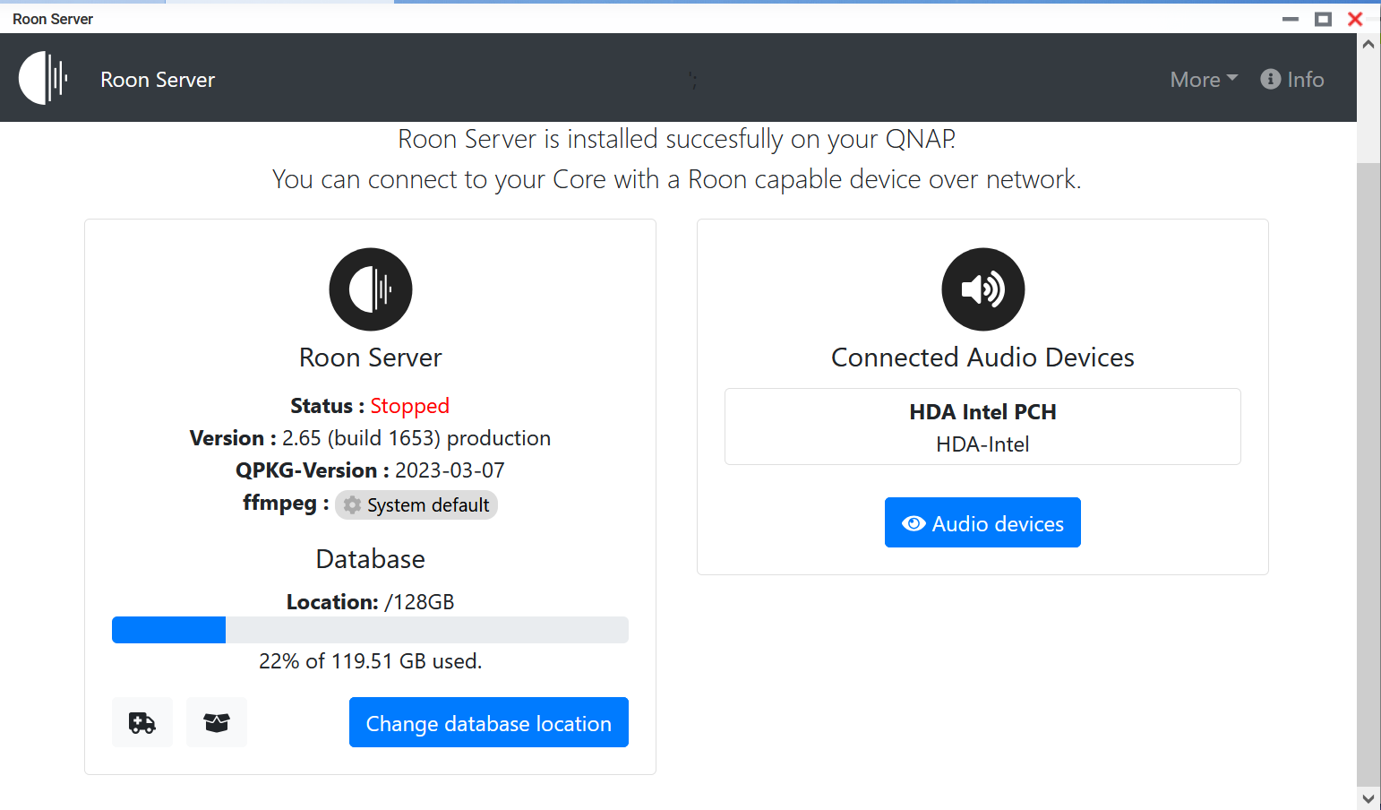

· Roon on QNAP NAS, now cannot connect at all. NAS web UI for the Roon App says stopped and Roon will not start at all. I have tried downloading and installing the latest Roon App, restarting the NAS. Still status is Stopped.
· UK BY supplied router, Various 1Gbps Netgear routers, Unifi WAPs. My QNAP NAS has internet access and Roon server is stopped so even local (same switch) access doesn't work.

The Roon Server package no longer works, please switch to the official Docker image to run Roon Server on your NAS. See also:

Have you tried setting up the docker? Its not as complicated as it looks at first glance.
The new version is a huge improvement.
It’s unfortunate but it would also be unfair for all non-QNAP users to suffer just because QNAP hasn’t updated their system libraries in 10 years.
In any case, as @Moonshiner says, setting up the Docker isn’t really as complicated as it looks at first.
