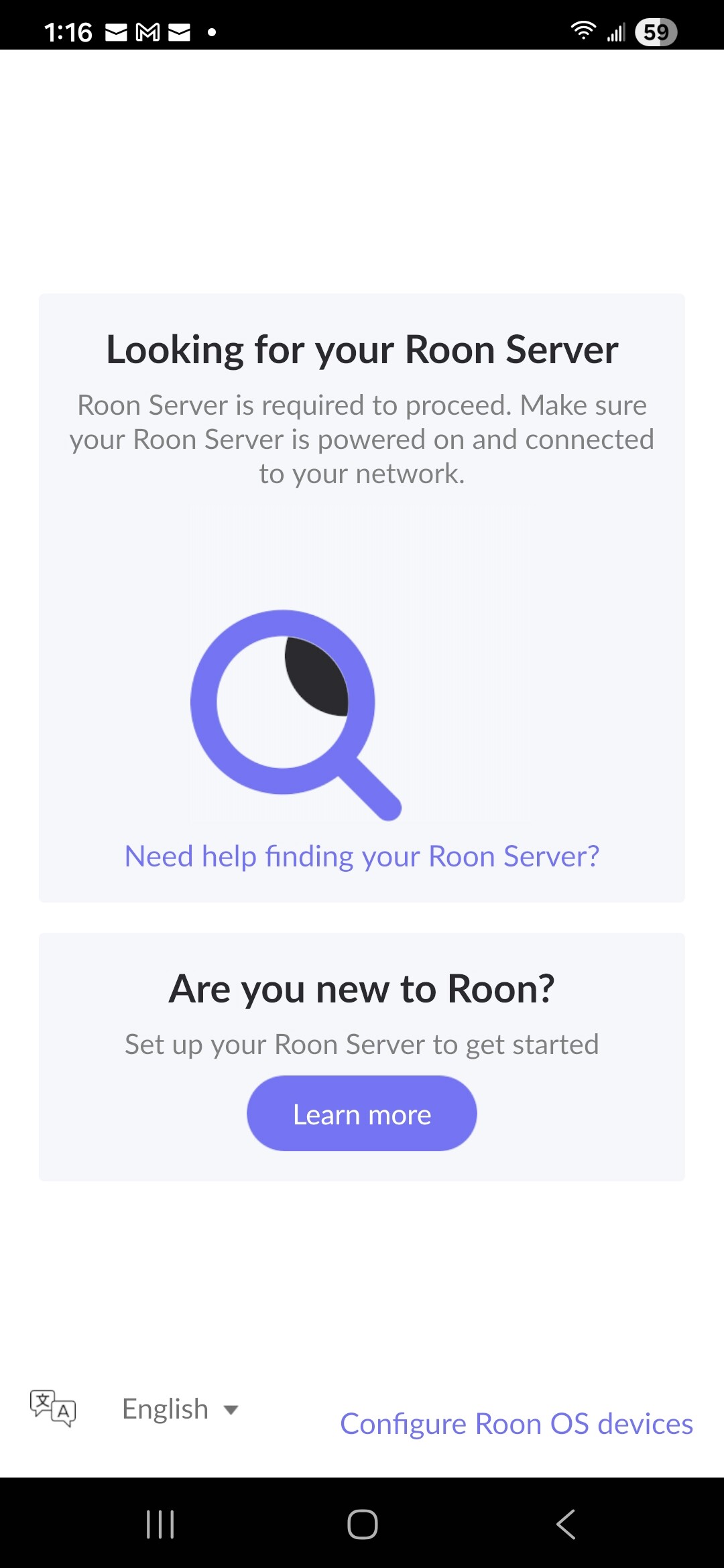

  1. After that, try reconnecting to your Roon Server again from your Remote(Galaxy phone).
  2. If the web page opens but Roon still won’t come back normally, please try reinstalling the OS from the ROCK web interface.
  3. Please send us a screenshot of exactly what you see on your mobile device when you try to connect.

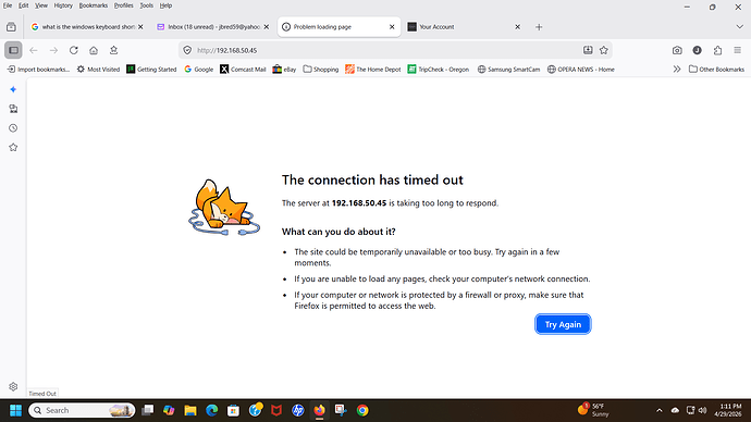

I’ve been traveling, just now had a chance to try this. The browser won’t connect, just times out.
What’s the next step?
Hey @John_Bredeson,
Thanks for the update! This is telling, and points to a break in the overall network connection between your router and Nucleus.
If you access your router settings and review the list of active devices connected to your network, do you see your Nucleus?
If you can, I’d test out using both a different Ethernet cable and a different Ethernet port on your router.
If that doesn’t help, while keeping your Nucleus connected to your router and powered on, see if you can connect the Nucleus to a monitor via HDMI. Share a screenshot of what you find when doing this.

Hi, no the Roon is not attached to my router. I’ve tried all those connection tips you’ve given and none work. I mentioned this earlier, but when I attach a monitor to the unit, there is no signal to read. Thus I have no screenshot I can send. I think I must be at the point of reinstalling or restoring software.
Hello @John_Bredeson
Thanks for the report, and I’m sorry to hear you’ve hit some hardware issues with your Nucleus. The best next step here is to get in touch with our RMA department directly, as they’re in charge of all hardware-related Nucleus issues. To do so, open the Typeform link below and select ‘Other’ followed by 'This issue is related to a physical component".
