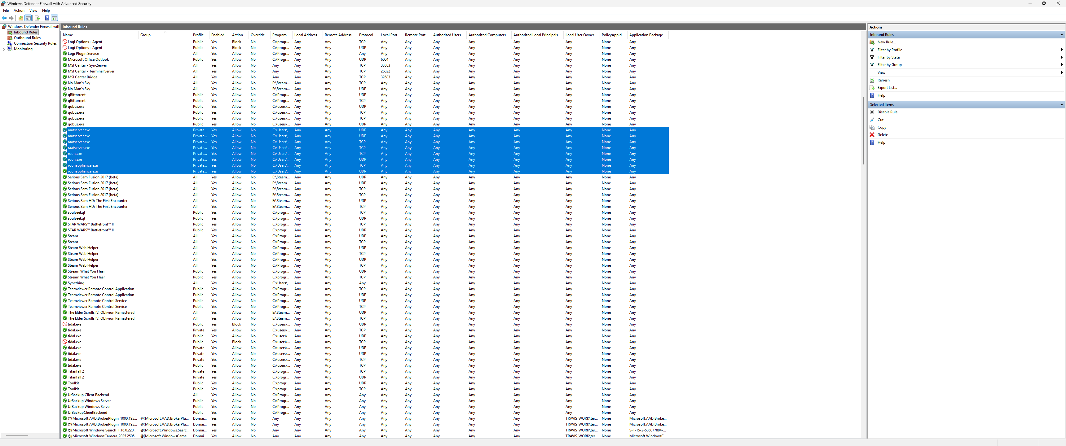

Looked at my computers firewall. RoonServer.exe and RAATServer.exe are explicitly allowed connections on all internal UDP. No specific rules are setup to block them. I also took the extra step to delete the allow rules, uninstall roon, and then create the exception rules again when prompted by Roon setup.
I disabled both windows firewalls and the same issue happened.
I also changed the audio playback to system output in Roon and the same issue occurred.
Again all other programs that play audio have no problem doing so. Even MusicBee in WASAPI exclusive mode has no issues. Its only since the Roon update in my previous ticket that I cannot play anything on Roon.
@Travis_Ernewein,
Thanks for sharing the details from your firewall settings and for running those additional tests.
Looking closely at the screenshot you provided, there is a very strong clue as to why the UDP loopback connection is still failing.
In the Profile column for raatserver.exe, roon.exe, and roonappliance.exe, the allowed connection is strictly set to Private.
If your Windows network profile recently switched from Private to Public (which can happen after a router reboot, driver update, or Windows update), Windows Defender will completely ignore those exceptions and block Roon’s internal UDP traffic, leading exactly to the clock sync failures we are seeing across all audio devices, including System Output.
