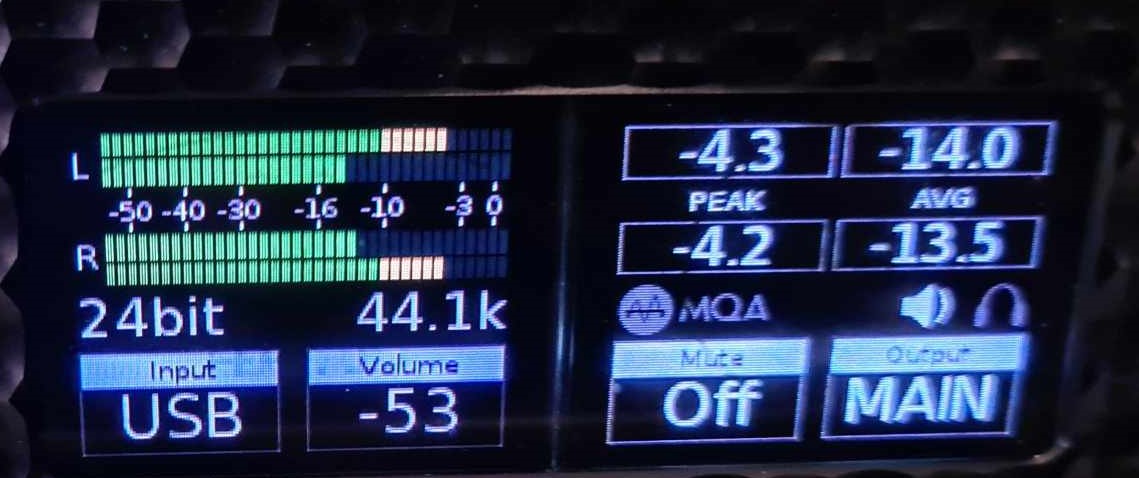

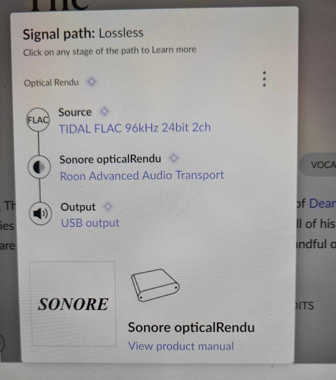

Roon did an update on 12/13/24, I updated about a week or more later. My system is a Roon Nucleus, to a Sonore opticalModule to a Sonore opticalRendu to a Mytek Brooklyn Dac+. I am using Tidal. Now when steaming music through the Sonore System I am only getting an output to the Dac+ of 44kHz even if the song is of a high resolution. I found If I remove the Sonore system from the chain the Dac+ plays all resolutions as it should, 44, 96, 192... I have been in contact with a Sonore techs, they had me do a Sonore diagnostic test and now feel it is an issue with Roon. I have a copy of the Sonore diagnostic exam (3 pages). How should I proceed?
Bonn N8 swithch, Roon Nucleus, Sonore opticalModule, Sonore opticalRendu, Mytek Brooklyn Dac+

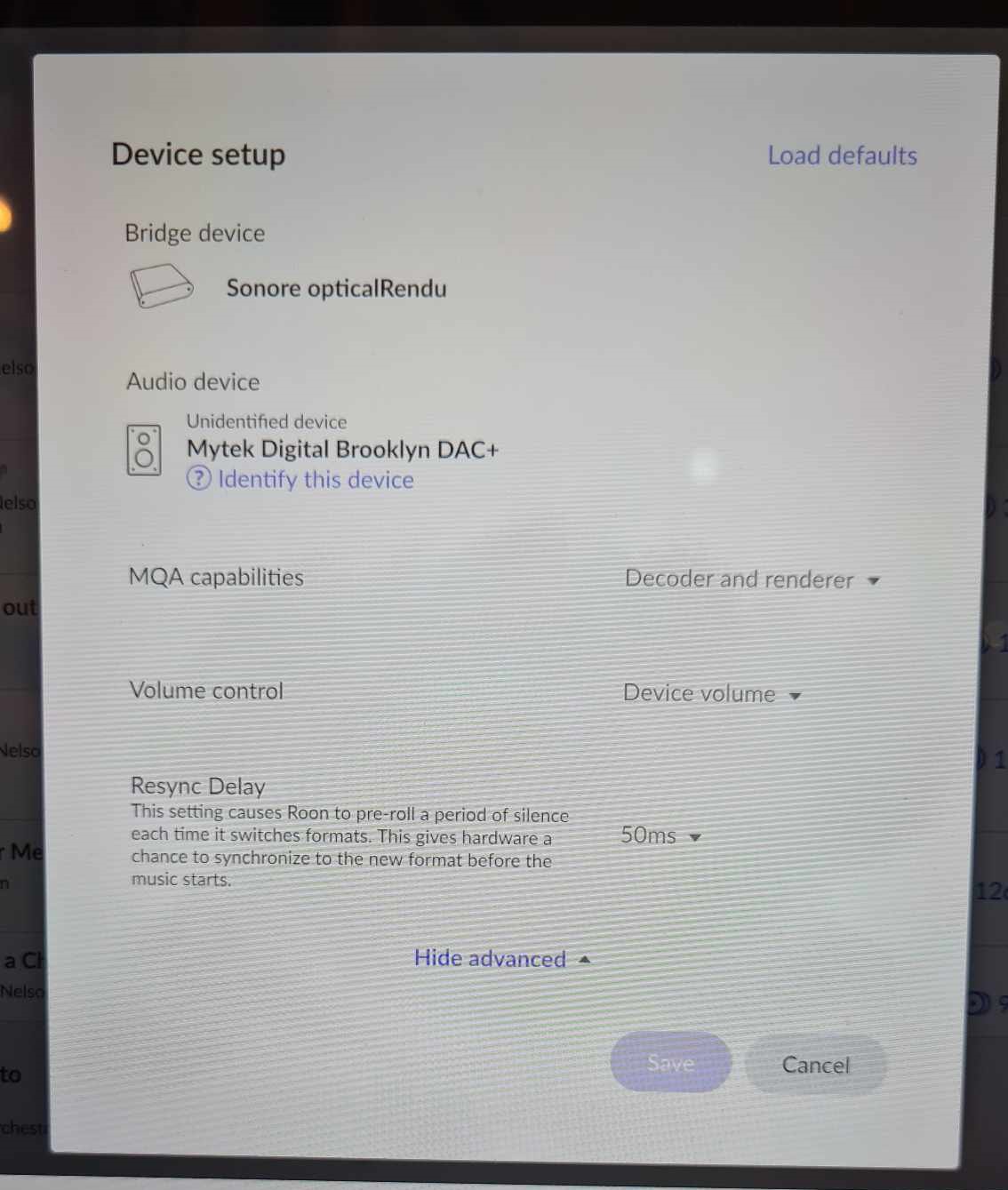

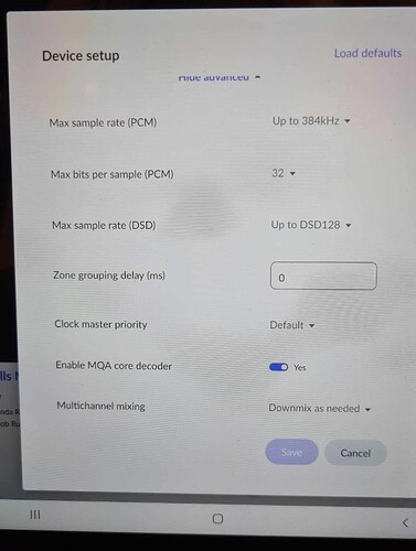

Hi @David_Benson,
Thanks for writing in to ask us about this issue. Looking at the signal path you posted we can see that as far as Roon knows it is outputting 96/24. There is no signal processing going on inside of Roon and looking at the Roon device settings you’ve shown no downsampling is going on either. In addition I noticed this in your post.
This says to me that some setting in the Sonore is causing this. I don’t see how this could be an issue with Roon. Are you sure you don’t have some sort of downsampling enabled in the settings of the Sonore?

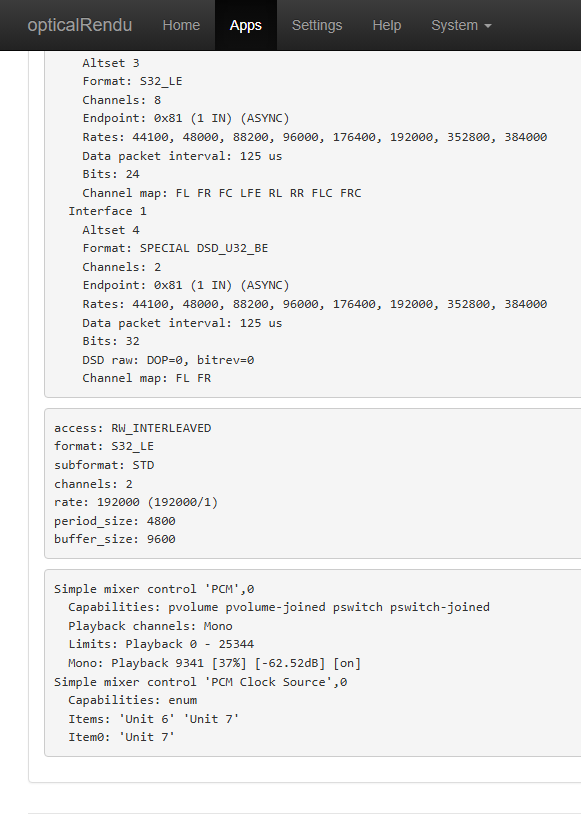

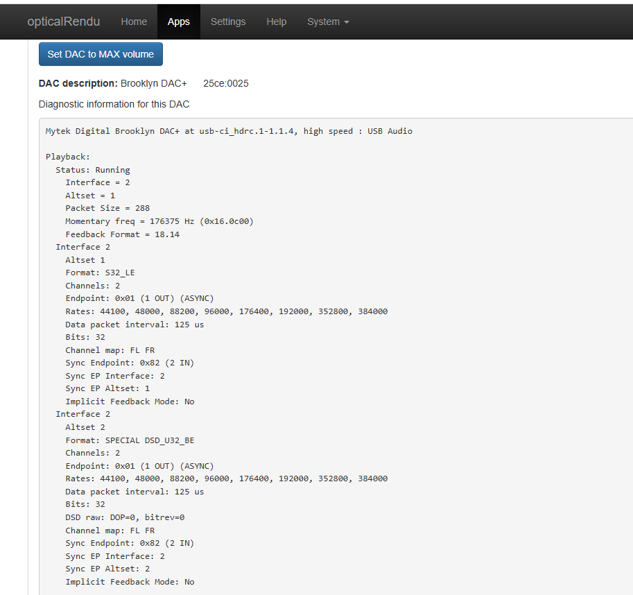

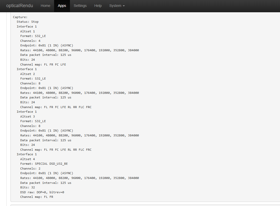

They suggested I try this,
On the Rendu go to Settings and DLNA/MPD and press save. On a phone or tablet install an app named mConnect. Give it your Tidal account number information and select the Rendu as the audio playback device (renderer). Play something through the system with a known sample rate.
I assume they are considering it could be an issue with Tidal. I will give this try and let you know how it turns out. Although to me it seems if it were Tidal causing the issue with my Mytek Dac+ only playing in 44kHz, why the when I eliminate the Sonore System from the chain my Mytek plays all resolutions from Tidal.

Hi Daniel,
I don’t know if this will help or show anything it is a Roon reagy diagnostic from Sonore…

02/02/2023 00:45:25 - ------------------------------------------------------------
02/02/2023 00:45:25 - aplay -l
[0000000] 0.005 TRACE [info] initializing info dictionary
[0000001] 0.005 TRACE [info] inserting raat_version -> 1.1.41
[0000002] 0.005 TRACE [info] inserting protocol_version -> 3
[0000003] 0.018 TRACE [output/alsa] initializing output uniqueid=hw:0,0
[0000004] 0.018 TRACE [output/alsa] preferred buffer duration=0.050000s
[0000005] 0.018 TRACE [output/alsa] force_max_volume=0
[0000006] 0.018 TRACE [output/alsa] resync delay=0.100000s
[0000007] 0.018 TRACE [ALSA] max pcm rate=1411200
[0000008] 0.018 TRACE [output/alsa] max dsd rate=1024
[0000009] 0.018 TRACE [output/alsa] dsd_mode=dop
[0000010] 0.018 TRACE [output/alsa] getting hardware info
[0000011] 0.020 TRACE pcm card id DAC
[0000012] 0.020 TRACE pcm card name Brooklyn DAC+
[0000013] 0.020 TRACE pcm card longname Mytek Digital Brooklyn DAC+ at usb-ci_hdrc.1-1.1.4, high speed
[0000014] 0.020 TRACE pcm card mixername USB Mixer
[0000015] 0.020 TRACE pcm card components USB25ce:0025
[0000016] 0.020 TRACE pcm card driver USB-Audio
[0000017] 0.021 TRACE pcm card usb id 25ce:0025
[0000018] 0.021 TRACE [output/alsa] probing formats
[0000019] 0.022 TRACE [alsa] [hw:0,0] probing formats
[0000020] 0.022 TRACE [alsa] [hw:0,0]     device supports channels range 2-2
[0000021] 0.022 TRACE [alsa] [hw:0,0] supports PCM format 44100/16/1
[0000022] 0.023 TRACE [alsa] [hw:0,0] supports PCM format 44100/24/1
[0000023] 0.023 TRACE [alsa] [hw:0,0] supports PCM format 44100/32/1
[0000024] 0.023 TRACE [alsa] [hw:0,0] supports PCM format 48000/16/1
[0000025] 0.023 TRACE [alsa] [hw:0,0] supports PCM format 48000/24/1
[0000026] 0.023 TRACE [alsa] [hw:0,0] supports PCM format 48000/32/1
[0000027] 0.023 TRACE [alsa] [hw:0,0] supports PCM format 88200/16/1
[0000028] 0.023 TRACE [alsa] [hw:0,0] supports PCM format 88200/24/1
[0000029] 0.024 TRACE [alsa] [hw:0,0] supports PCM format 88200/32/1
[0000030] 0.024 TRACE [alsa] [hw:0,0] supports PCM format 96000/16/1
[0000031] 0.024 TRACE [alsa] [hw:0,0] supports PCM format 96000/24/1
[0000032] 0.024 TRACE [alsa] [hw:0,0] supports PCM format 96000/32/1
[0000033] 0.024 TRACE [alsa] [hw:0,0] supports PCM format 176400/16/1
[0000034] 0.024 TRACE [alsa] [hw:0,0] supports PCM format 176400/24/1
[0000035] 0.024 TRACE [alsa] [hw:0,0] supports DSD format 2822400/1/1 (Encapsulated)
[0000036] 0.025 TRACE [alsa] [hw:0,0] supports PCM format 176400/32/1
[0000037] 0.025 TRACE [alsa] [hw:0,0] supports PCM format 192000/16/1
[0000038] 0.025 TRACE [alsa] [hw:0,0] supports PCM format 192000/24/1
[0000039] 0.025 TRACE [alsa] [hw:0,0] supports PCM format 192000/32/1
[0000040] 0.025 TRACE [alsa] [hw:0,0] supports PCM format 352800/16/1
[0000041] 0.025 TRACE [alsa] [hw:0,0] supports PCM format 352800/24/1
[0000042] 0.025 TRACE [alsa] [hw:0,0] supports DSD format 5644800/1/1 (Encapsulated)
[0000043] 0.025 TRACE [alsa] [hw:0,0] supports PCM format 352800/32/1
[0000044] 0.025 TRACE [alsa] [hw:0,0] supports PCM format 384000/16/1
[0000045] 0.026 TRACE [alsa] [hw:0,0] supports PCM format 384000/24/1
[0000046] 0.026 TRACE [alsa] [hw:0,0] supports PCM format 384000/32/1
[0000047] 0.026 TRACE [alsa] [hw:0,0] supports PCM format 44100/16/2
[0000048] 0.026 TRACE [alsa] [hw:0,0] supports PCM format 44100/24/2
[0000049] 0.026 TRACE [alsa] [hw:0,0] supports PCM format 44100/32/2
[0000050] 0.027 TRACE [alsa] [hw:0,0] supports PCM format 48000/16/2
[0000051] 0.027 TRACE [alsa] [hw:0,0] supports PCM format 48000/24/2
[0000052] 0.027 TRACE [alsa] [hw:0,0] supports PCM format 48000/32/2
[0000053] 0.027 TRACE [alsa] [hw:0,0] supports PCM format 88200/16/2
[0000054] 0.027 TRACE [alsa] [hw:0,0] supports PCM format 88200/24/2
[0000055] 0.027 TRACE [alsa] [hw:0,0] supports PCM format 88200/32/2
[0000056] 0.027 TRACE [alsa] [hw:0,0] supports PCM format 96000/16/2
[0000057] 0.028 TRACE [alsa] [hw:0,0] supports PCM format 96000/24/2
[0000058] 0.028 TRACE [alsa] [hw:0,0] supports PCM format 96000/32/2
[0000059] 0.028 TRACE [alsa] [hw:0,0] supports PCM format 176400/16/2
[0000060] 0.028 TRACE [alsa] [hw:0,0] supports PCM format 176400/24/2
[0000061] 0.028 TRACE [alsa] [hw:0,0] supports DSD format 2822400/1/2 (Encapsulated)
[0000062] 0.028 TRACE [alsa] [hw:0,0] supports PCM format 176400/32/2
[0000063] 0.028 TRACE [alsa] [hw:0,0] supports PCM format 192000/16/2
[0000064] 0.028 TRACE [alsa] [hw:0,0] supports PCM format 192000/24/2
[0000065] 0.029 TRACE [alsa] [hw:0,0] supports PCM format 192000/32/2
[0000066] 0.029 TRACE [alsa] [hw:0,0] supports PCM format 352800/16/2
[0000067] 0.029 TRACE [alsa] [hw:0,0] supports PCM format 352800/24/2
[0000068] 0.029 TRACE [alsa] [hw:0,0] supports DSD format 5644800/1/2 (Encapsulated)
[0000069] 0.029 TRACE [alsa] [hw:0,0] supports PCM format 352800/32/2
[0000070] 0.029 TRACE [alsa] [hw:0,0] supports PCM format 384000/16/2
[0000071] 0.029 TRACE [alsa] [hw:0,0] supports PCM format 384000/24/2
[0000072] 0.029 TRACE [alsa] [hw:0,0] supports PCM format 384000/32/2
[0000073] 0.045 TRACE [output/alsa] initialized
[0000074] 0.045 INFO [volume/alsa] initializing
[0000075] 0.045 TRACE [volume/alsa] [hw:0] Settings
[0000076] 0.045 TRACE [volume/alsa] [hw:0]     mixer index:    0
[0000077] 0.055 TRACE [volume/alsa] searching for volume control element
[0000078] 0.055 TRACE [volume/alsa]     card has element 0, PCM
[0000079] 0.055 TRACE [volume/alsa]         (using this mixer element)
[0000080] 0.055 TRACE [volume/alsa]     card has element 0, PCM Clock Source
[0000081] 0.055 TRACE [volume/alsa]         (skipping: element doesn't support playback volume)
[0000082] 0.055 TRACE [volume/alsa] searching for mute element
[0000083] 0.055 TRACE [volume/alsa]     card has element 0, PCM
[0000084] 0.055 TRACE [volume/alsa]         (using this mixer element)
[0000085] 0.055 TRACE [volume/alsa]     card has element 0, PCM Clock Source
[0000086] 0.055 TRACE [volume/alsa]         (skipping: element doesn't support playback switch)
[0000087] 0.056 TRACE [volume/alsa] read values: min=0.000000, max=100.000000, value=100.000000, mute=0
[0000088] 0.056 TRACE [volume/alsa] initialized min_volume=0 max_volume=0 volume=0 mute=0
[0000089] 0.058 TRACE [watch/alsa] initializing watch device=hw:0 exit_on_lost=1
[0000090] 0.061 TRACE [watch/alsa] initialized
[0000091] 0.061 TRACE [info] inserting unique_id -> a72abb62-3859-4547-9e50-94ed1d52473b
[0000092] 0.062 TRACE [info] inserting vendor -> Sonore
[0000093] 0.062 TRACE [info] inserting vendor_model -> Sonore opticalRendu
[0000094] 0.062 TRACE [info] inserting serial -> 028745
[0000095] 0.062 TRACE [info] inserting config_url -> http://__SELF__/
[0000096] 0.062 TRACE [info] inserting model -> opticalRendu
[0000097] 0.062 TRACE [info] inserting version -> 2.9
[0000098] 0.062 INFO [server] listening on port 34269
[0000099] 0.066 TRACE [discovery] starting
[0000100] 0.069 INFO [discovery] [iface:127.0.0.1] multicast recv socket is bound to 0.0.0.0:9003
[0000101] 0.069 INFO [discovery] [iface:127.0.0.1] multicast send socket is bound to 0.0.0.0:34173
[0000102] 0.069 INFO [discovery] [iface:192.168.254.148] multicast recv socket is bound to 0.0.0.0:9003
[0000103] 0.070 INFO [discovery] [iface:192.168.254.148] multicast send socket is bound to 0.0.0.0:49338
[0000104] 0.077 INFO [discovery] unicast socket is bound to 0.0.0.0:9003
[0000105] 0.077 TRACE [device] announcing DiscoveryMessage[type=QUERY, transactionid=58BDD527-B80F-C0A7-BE62-F1C419ECD547, Data={ "unique_id": "a72abb62-3859-4547-9e50-94ed1d52473b", "raat_version": "1.1.41", "vendor": "Sonore", "protocol_version": "3", "config_url": "http://__SELF__/", "model": "opticalRendu", "version": "2.9", "vendor_model": "Sonore opticalRendu", "serial": "028745", "service_id": "5e2042ad-9bc5-4508-be92-ff68f19bdc93", "tcp_port": "34269",  } ]
[0000106] 0.146 TRACE [server] [192.168.254.155:33020] accepted connection
[0000107] 0.171 TRACE [session] [192.168.254.155:33020] created: 0x12a4758 (0x12ce098)
[0000108] 0.187 TRACE [server] new script with name=raat.dat:base.lua module=base keypair=(null) signature=(null)
[0000109] 0.188 DEBUG [discovery] broadcast op is complete
[0000110] 0.188 TRACE [session] [192.168.254.155:33020] pre-loading lua module base
[0000111] 0.196 TRACE [server] [192.168.254.155:33020] SENT[LL] [1] {"status": "Success"}
[0000112] 0.210 TRACE [server] new script with name=raat.dat:dkjson.lua module=dkjson keypair=(null) signature=(null)
[0000113] 0.211 TRACE [session] [192.168.254.155:33020] pre-loading lua module dkjson
[0000114] 0.225 TRACE [server] [192.168.254.155:33020] SENT[LL] [1] {"status": "Success"}
[0000115] 0.227 TRACE [server] new script with name=raat.dat:protocol.lua module=protocol keypair=(null) signature=(null)
[0000116] 0.227 TRACE [session] [192.168.254.155:33020] pre-loading lua module protocol
[0000117] 0.229 TRACE [server] [192.168.254.155:33020] SENT[LL] [1] {"status": "Success"}
[0000118] 0.250 TRACE [server] new script with name=raat.dat:roon_tcp.lua module=(null) keypair=(null) signature=(null)
[0000119] 0.251 TRACE [session] [192.168.254.155:33020] executing lua script
[0000120] 0.276 TRACE [lua@0x12a4944] [192.168.254.155:33020]  [roon] clock socket listening on udp 0.0.0.0:42450
[0000121] 0.276 TRACE [lua@0x12a4944] [192.168.254.155:33020]  [roon] audio socket listening on tcp 0.0.0.0:37997
[0000122] 0.276 TRACE [lua@0x12a4944] [192.168.254.155:33020]  [roon] output info {"config": {"signal_path": [{"quality": "lossless", "type": "output", "method": "usb"}], "type": "alsa", "buffer_duration": 0.050000000000000003, "device": "hw:0,0", "dsd_mode": "dop"}, "alsa_device": {"name": "Brooklyn DAC+", "id": "DAC", "mixername": "USB Mixer", "longname": "Mytek Digital Brooklyn DAC+ at usb-ci_hdrc.1-1.1.4, high speed", "components": "DAC", "driver": "USB-Audio", "usbid": "25ce:0025"}}
[0000123] 0.276 TRACE [lua@0x12a4944] [192.168.254.155:33020]  [roon] volume info {"config": {"type": "alsa", "device": "hw:0", "optional": true, "index": 0}}
[0000124] 0.277 TRACE [server] [192.168.254.155:33020] SENT[LL] [1] {"status": "Success"}
[0000125] 0.278 TRACE [lua@0x12a4944] [192.168.254.155:33020]  GOT [2] {"request":"info"}
[0000126] 0.286 TRACE [lua@0x12a4944] [192.168.254.155:33020]  SENT [2] {"flags":{"has_write_chmap":true},"source_selection":{"info":[],"is_supported":false},"volume":{"info":{"config":{"type":"alsa","index":0,"device":"hw:0","optional":true}},"is_supported":true},"info":{"unique_id":"a72abb62-3859-4547-9e50-94ed1d52473b"},"status":"Success","output":{"info":{"alsa_device":{"longname":"Mytek Digital Brooklyn DAC+ at usb-ci_hdrc.1-1.1.4, high speed","usbid":"25ce:0025","mixername":"USB Mixer","id":"DAC","name":"Brooklyn DAC+","driver":"USB-Audio","components":"DAC"},"config":{"type":"alsa","device":"hw:0,0","buffer_duration":0.05,"dsd_mode":"dop","signal_path":[{"type":"output","method":"usb","quality":"lossless"}]}},"supported_formats":"44100/24/1|2,48000/16/1|2,352800/24/1|2,176400/24/1|2,48000/32/1|2,88200/16/1|2,384000/32/1|2,192000/24/1|2,48000/24/1|2,96000/32/1|2,192000/16/1|2,384000/24/1|2,5644800/1/1|2,384000/16/1|2,352800/32/1|2,176400/16/1|2,44100/32/1|2,192000/32/1|2,44100/16/1|2,2822400/1/1|2,352800/16/1|2,96000/16/1|2
[0000127] 0.287 TRACE [lua@0x12a4944] [192.168.254.155:33020]  GOT [3] {"request":"set_client_type","client_type":"Roon"}
[0000128] 0.288 TRACE [lua@0x12a4944] [192.168.254.155:33020]  SENT [3] {"status":"Success"}
[0000129] 0.289 TRACE [lua@0x12a4944] [192.168.254.155:33020]  GOT [4] {"request":"subscribe_transport"}
[0000130] 0.289 TRACE [lua@0x12a4944] [192.168.254.155:33020]  GOT [5] {"request":"subscribe_controls","controller_id":"e6d4ea49-2d84-4167-a030-1574289ebcc6"}
[0000131] 0.292 TRACE [lua@0x12a4944] [192.168.254.155:33020]  SENT [5] {"status":"Success","action":"Changed","controls":{"volume":{"type":"number","value":100,"info":{"config":{"type":"alsa","index":0,"device":"hw:0","optional":true}},"max":100.0,"step":1.0,"min":0.0,"mute":false}}}
[0000132] 464.548 TRACE [server] [127.0.0.1:48756] accepted connection
[0000133] 464.555 TRACE [session] [127.0.0.1:48756] created: 0x12bbf18 (0x1350bf8)
[0000134] 464.607 TRACE [server] [192.168.254.148:39926] accepted connection
[0000135] 464.613 TRACE [session] [192.168.254.148:39926] created: 0x12b5e48 (0x12b63e0)
[0000136] 464.636 TRACE [server] [127.0.0.1:48756] read: eof
[0000137] 464.636 TRACE [server] [127.0.0.1:48756] destroying client
[0000138] 464.636 TRACE [session] [127.0.0.1:48756] destroying session
**** List of PLAYBACK Hardware Devices ****
card 0: DAC [Brooklyn DAC+], device 0: USB Audio [USB Audio]
  Subdevices: 1/1
  Subdevice #0: subdevice #0
  Subdevices: 1/1
Hi @David_Benson,
Thanks for the follow-up. An easy test here would be to temporarily bypass the sonore devices, and connect your DAC and see if the same downsampling takes place. And vice versa, if you play to a different DAC or endpoint using the sonore devices, do you see the same issue?
I’d also confirm all your devices are ethernet-connected to your primary router.
If it’s only Tidal content, I would also review your Roon Settings>Services>Tidal>Playback quality setting to confirm there’s no downsampling occurring. :+1:
Hello Benjamin,
Yes all of my devices are ethernet connected to my router. Tidal is set to Max. When the Sonore system is taken out of the loop he Mytek dac performs as it should and plays all resolutions.
Hello Benjamin,
Update, A local distributor of Sonore lent me another Sonore unit. When swaped with my Sonore opticalRendu the Mytek performed as it should and played all resolutions. It was determined that somehow the software in my sd card of my Sonore opticalRendu had become fauilty. Sonore provided me with new software which solved the issue.
I would to thnak you and Roon support with assitisng me in finding the issue.
Regards,
David.
Thanks for the update @David_Benson! I’m happy to hear you were able to sort it out. Happy listening! :notes: :drum:
