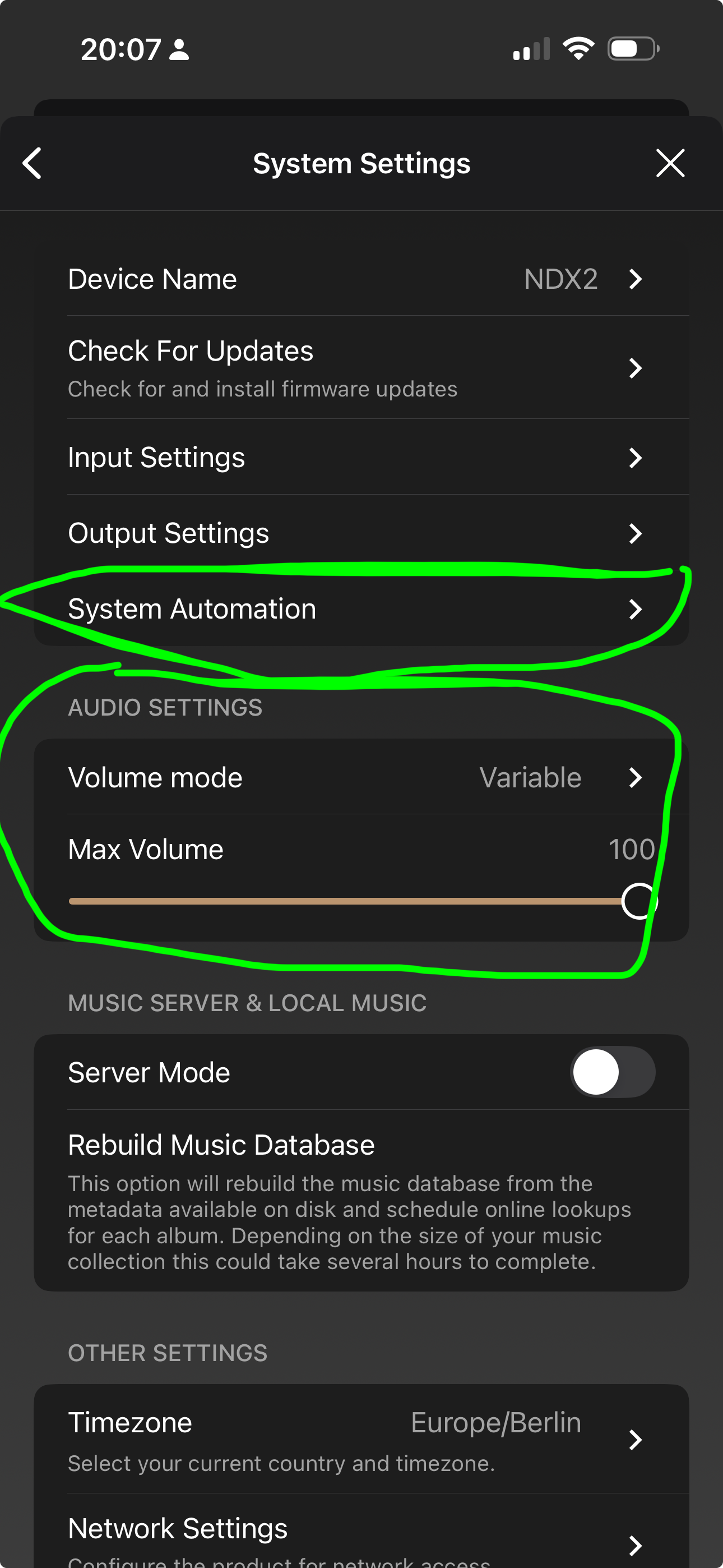

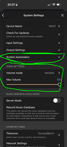

You need to do two or three things. First, stop the music on the NDX-2 to prevent any volume mishaps. Then:
  1. In the Focal & Naim app, go to Settings > System Settings.
  2. Disable System Automation in case you have it enabled (unlikely unless you have Naim amps). When System Automation is disabled, the Audio Settings are visible below it. Change the Volume Mode from Fixed to Variable.

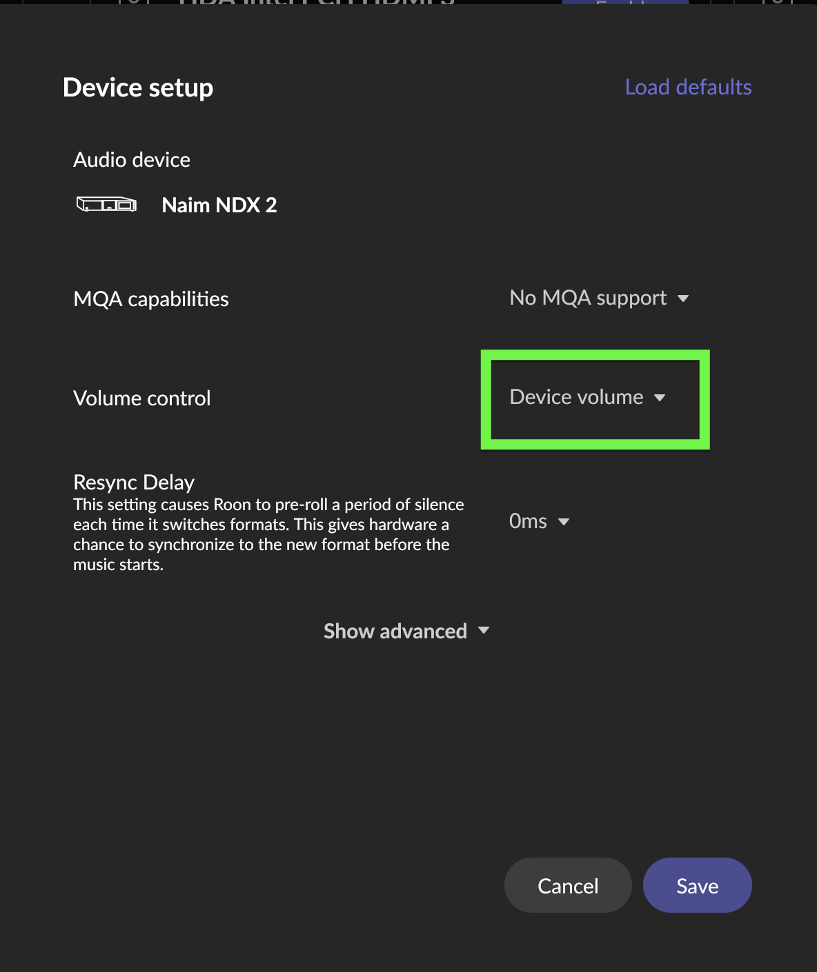

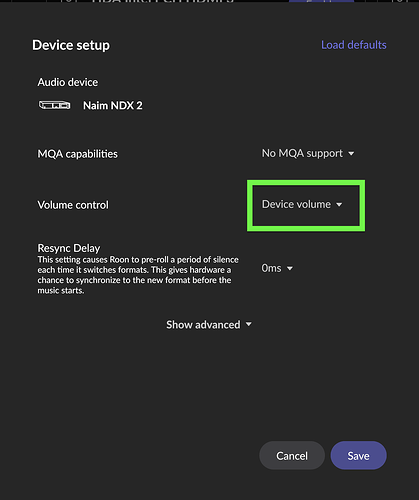

  3. In Roon, go to Settings > Audio > Roon Ready > NDX-2, click the gearwheel to open settings, click Device Setup, set Volume Control to Device Volume

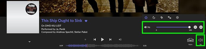

  4. There is now a variable volume control in Roon:
Note: Make sure to turn volume to zero before turning on any music, then slowly increase. The NDX-2 remote and the slider in Roon should be synced, if you use the remote buttons the slider should move, and you will also see the same numeric value in the Roon volume slider and the NDX-2 display.
Hi Suedkiez - Thanks for your continued support on this. Referring to your ‘step by step’, the ‘Audio Settings’ choice only appears if you select the one of the analogue outputs in the ‘Output Settings’ box. When I switch back to the digital output, the Audio Settings box disappears and the volume shows as fixed in Roon.
