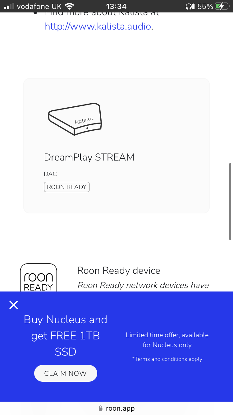

It IS Roon Ready - but it is NOT a Roon Core, which is what supports adding storage options.

Whilst I can understand your frustration, Roon Ready is clearly defined, and doesn’t claim to do what you had hoped.
However, if your music is on a USB drive, simply connect this to your core, and add this as a storage location.
