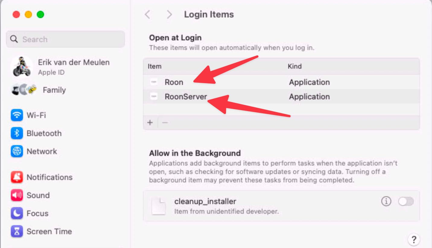

I am a little confused. I run Roon on a dedicated headless MacMini.
From what I have understood, there is no longer a dedicated server and client program, but only ‘Roon’.
So I have installed a recent version from the Roon website onto my MacMini and added ‘Roon’ to my ‘Open at login’ list.
Now when I startup my MacMini and do a screenshare, I see the normal Roon interface on my MacMini. That seems normal. Now, when I click on the little Roon-image on the top menu bar, it has an option ‘Launch at Startup?’. If I select that, the item ‘RoonServer’ instantly appears in my ‘Open at login’ list!
This leaves me with two different Roon instances there:
Which seems odd to me. What am I missing here? Thanks for any suggestion!

same here, I just killed “Roon” from Startup Items. 1,6 GB less consumption of Ram. Im running my m2- Roon Server headless as well, if you don’t need to see the GUI on the Server you can just stop this instance running. Don’t know if its intended like this…
