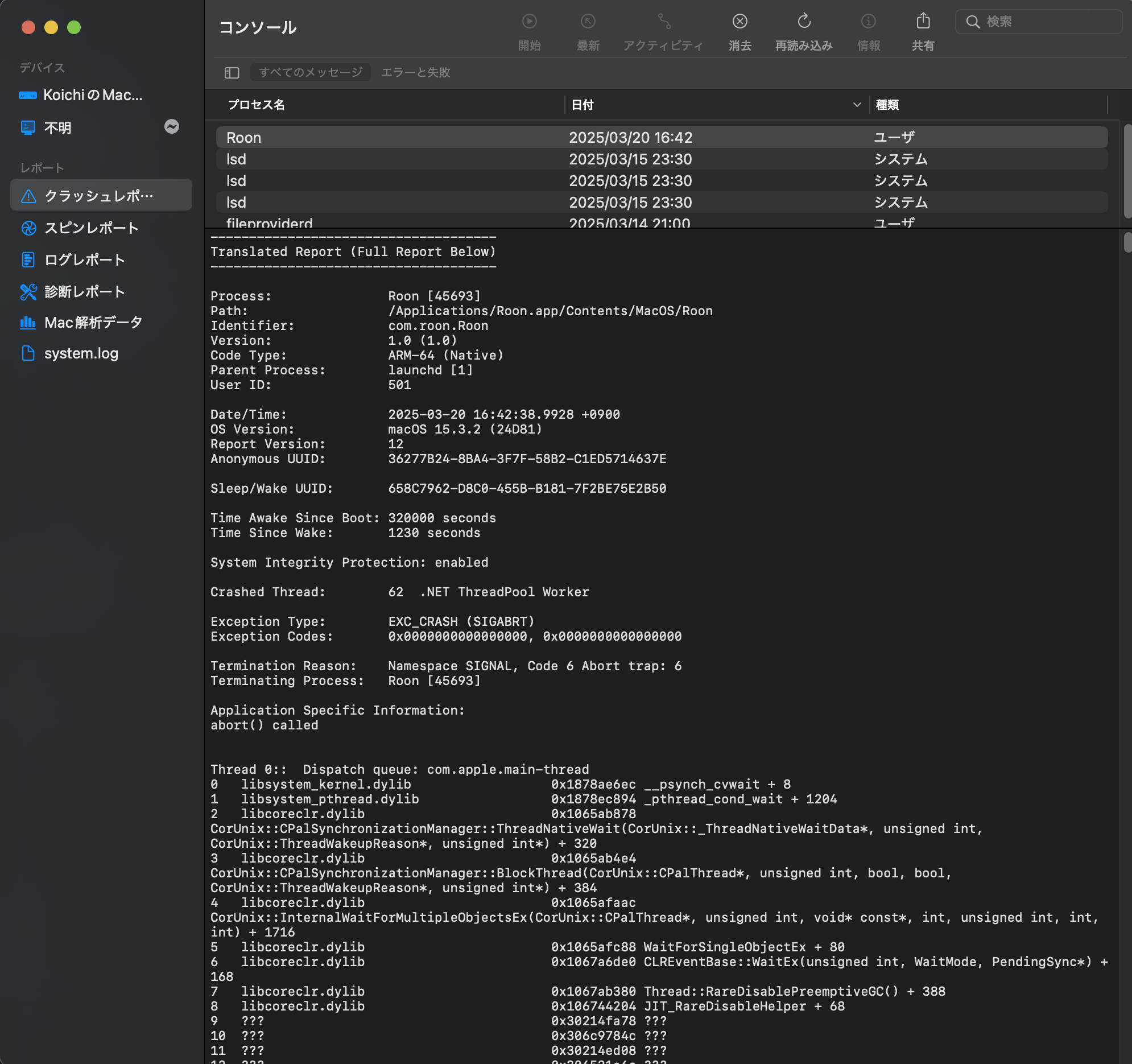

Roon Will not start, freezes or crashes (ref#MT1AGN)
After updating to macOS 15.3.2, Roon.app launches but immediately quits.
Reinstalling does not resolve the issue.
Roon Server (Linux) is running on a separate machine.
There are no issues in the following environments:
- Windows 11 2.47 (build 1510)
- macOS 14.6.1 2.47 (build 1510)
I have attached the crash report.
Please provide a solution.
Translated Report (Full Report Below)
Process: Roon [45693]
Path: /Applications/Roon.app/Contents/MacOS/Roon
Identifier: com.roon.Roon
Version: 1.0 (1.0)
Code Type: ARM-64 (Native)
Parent Process: launchd [1]
User ID: 501
Date/Time: 2025-03-20 16:42:38.9928 +0900
OS Version: macOS 15.3.2 (24D81)
Report Version: 12
Anonymous UUID: 36277B24-8BA4-3F7F-58B2-C1ED5714637E
Sleep/Wake UUID: 658C7962-D8C0-455B-B181-7F2BE75E2B50
Time Awake Since Boot: 320000 seconds
Time Since Wake: 1230 seconds
System Integrity Protection: enabled
Crashed Thread: 62 .NET ThreadPool Worker
Exception Type: EXC_CRASH (SIGABRT)
Exception Codes: 0x0000000000000000, 0x0000000000000000
Termination Reason: Namespace SIGNAL, Code 6 Abort trap: 6
Terminating Process: Roon [45693]
Application Specific Information:
abort() called
Thread 0:: Dispatch queue: com.apple.main-thread
0 libsystem_kernel.dylib 0x1878ae6ec __psynch_cvwait + 8

Client:
Mac mini (M4Pro) -> CalDigit TS4 -> 2.5GbE NIC -> Network Hub
Roon Server:
GentooPlayer(Linux) on Minisforum UM870SLIM -> 2.5GbE NIC -> Network Hub
Network Hub:
Planex FX2G-05EM
Router:
TP-Link Archer BE550/A
Hi @koichi.tsutsumi,
Welcome to the Roon community! I’m sorry that a problem brought you here for the first time.
I activated diagnostics on the Mac running 15.3.2, but it looks like they weren’t able to go through. Can you please follow the directions found here to manually send us a set of logs? You can upload them to our File Uploader. Once you’ve uploaded the logs, let us know, and we’ll take a look.
In the meantime, can you try reinstalling the Roon client on your Mac and see if that makes a difference?
Looking forward to your update!
Thank you for your response.
I got a hint from the logs and was able to resolve the issue.
I always have a Docker Desktop app called “OrbStack” running.
When I stopped it and launched Roon.app, the crashes stopped.
Once it successfully launched, Roon.app no longer crashed even with OrbStack running.
OrbStack automatically mounts directories via NFS.
OrbStack:/OrbStack on /Users/tutumi/OrbStack (nfs, nodev, nosuid, noatime, mounted by tutumi)
I’m not sure if this is relevant, but I’m sharing it for your information.
Also, I have uploaded the log from the last crash as Roon_log.06.txt.
This ticket has been resolved.
Thank you very much.
