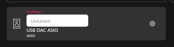

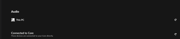

Since most recent update, my roon app for windows pc client (windows 11 btw) has been struggling to properly detect my smsl m500 dac, it shows:
1
or sometimes doesnt show anything:
Checked some old posts about firewall being the issue, tried disabling in windows pc and roon ubuntu machine, not changes. I have to close and open the app a couple of times for it to finally detect the device and thankfully play audio, or have to close and open again.
Never had any problem at all, first time having some issues.

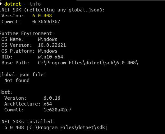

In other post I read having a different version than .NET 6.0 for the current version of roon app for windows can provoke problems, but I have that version too:
