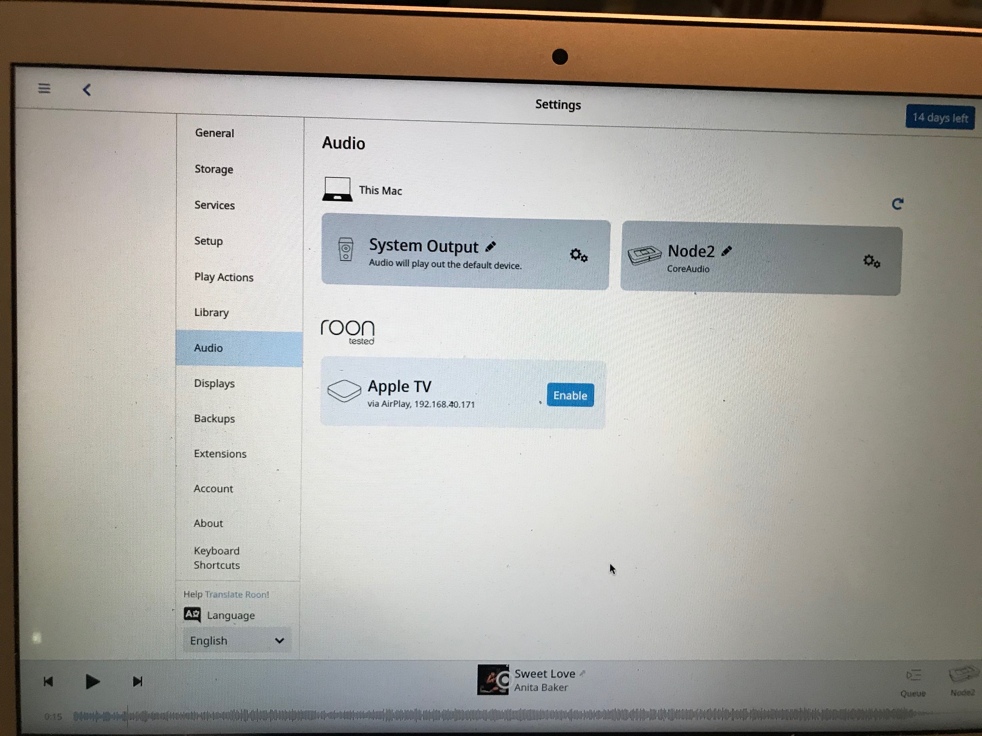

I cannot figure out how to get audio to output to my Node2 device. Works fine using the BluOs app. The Node 2 shows up under settings in Roon but it only allows the sound to be output to the MacBook Air. I don’t see an option to change this.

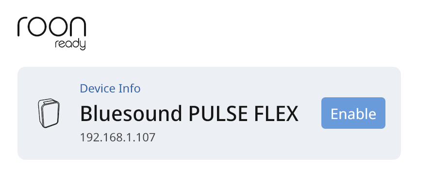

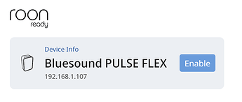

Under Settings > Audio make sure the Bluesound Node is enable.
Then make sure you select the zone.

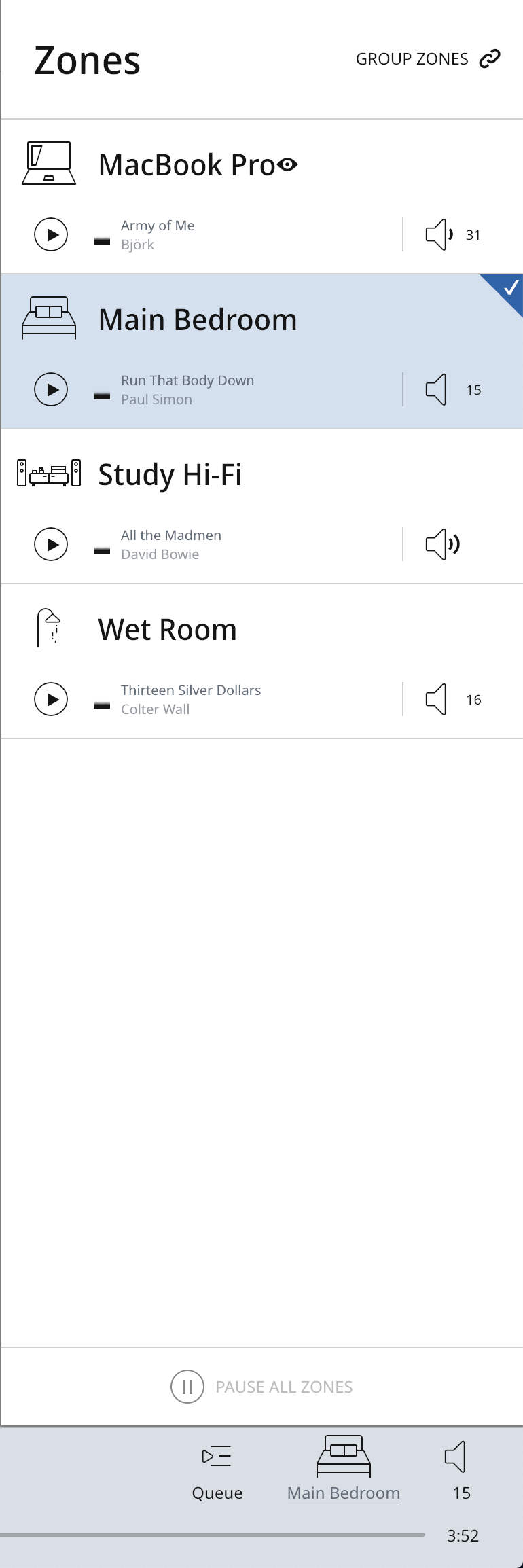

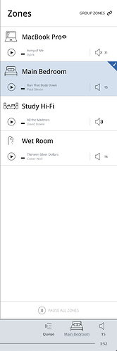

This is what I see under the audio screen in settings
How do I change the output to Node2?
According the that screenshot music is playing on the Node. Perhaps you could explain your setup and what is connected to the Node.

Somethings not right with your set up. The Node 2 should not show up connected to the Mac your adding an output from the mac not the Bluesound… It should be under its own section. I have a feeling this is network related and it’s blocking discovery What is Roon core running on, is it wired or wireless? Check the IP address of your core and check the IP address of the Node 2 using Bluesound app. Are they in the same range. The first 3 sets of numbers should be the same eg 192.168.1 the 4th will be different for each device. If they 3rd is different then you mesh system is running different networks for wireless and wired or perhaps for each mesh node.
