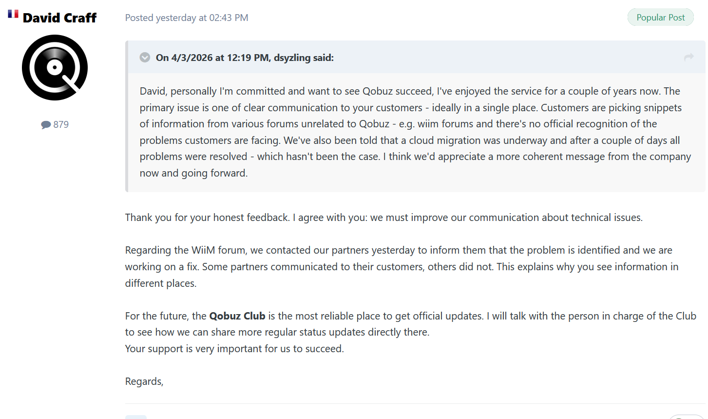

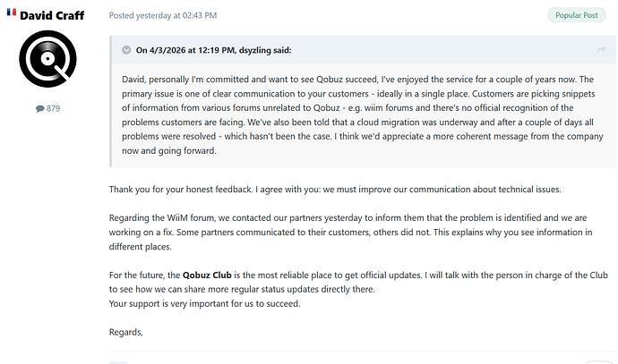

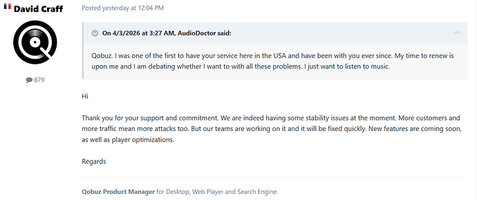

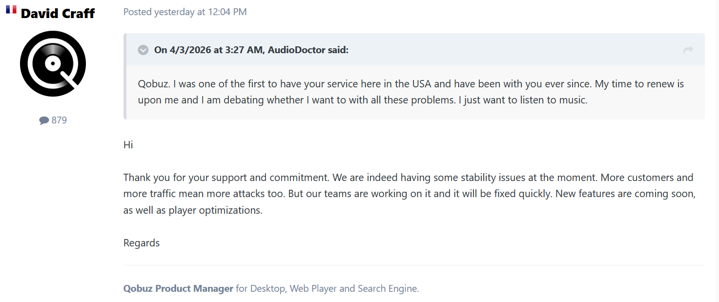

In the Qobuz thread on audiophile style is david craff active from qobuz, he replyed on some questions yesterday. may be useful info;
