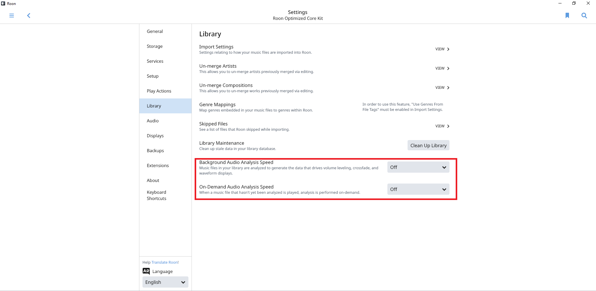

In logs, I’m noticing Roon is performing a lot of background activity regarding importing and analysis and this can take up a lot of processing power.
Can you please try to disable background and on-demand audio analysis, let all of your imports finish and verify if the issue is still the same after?
Done. (Note that background analysis was already in the ‘off’ position.). I will report back after observing things.
