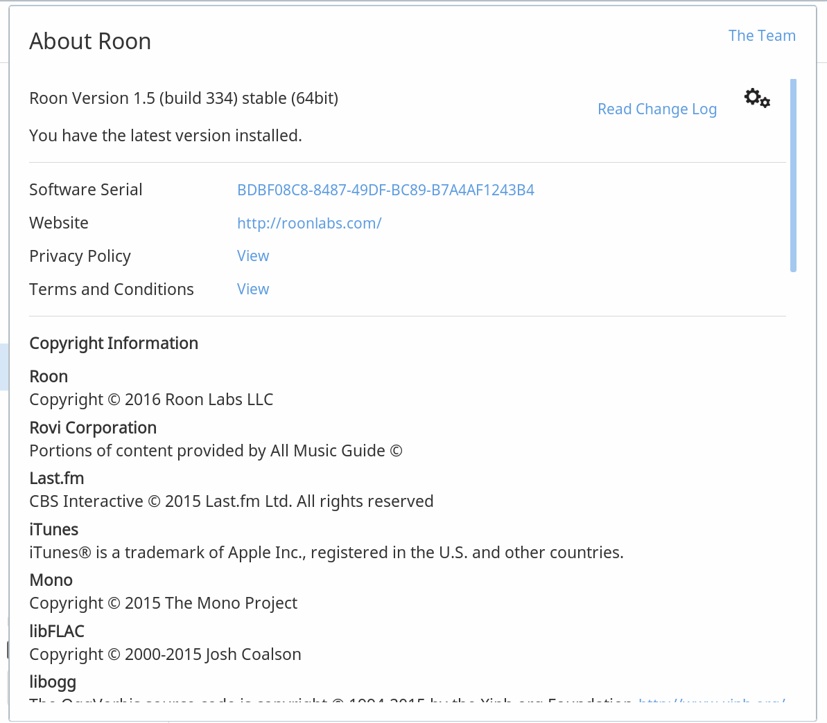

I am having difficulty getting my new Chord DAVE DAC to work with Roon. Prior to the DAVE, I was using HQPlayer together with Roon and an Auralic Vega DAC. I have disabled HQPlayer in Roon. I have installed the Chord ASIO driver, which Roon appears to recognize (see attachment).

Do you see the Sotm as a network endpoint? It should be acting as the Roon Endpoint with the Chord being connected to it and that is what you want to enable. You chopped the screen pic before we could see.
The section you are referencing is for devices directly connected to the Core computer. The device initialization is failing because the computer is expecting it to be plugged into a USB port on the computer.
I would start by simplifying the path and remove the tx-usbultra and just have the DAVE plugged into the Sotm.
Is this what you need to see? There is nothing showing as networked.
