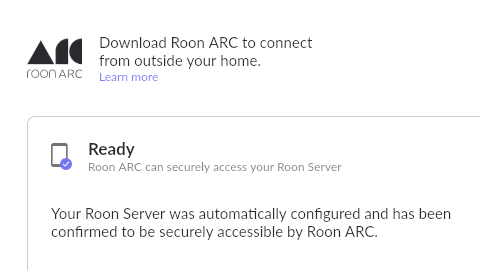

ARC Status
· ARC is *Ready*

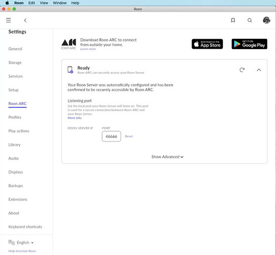

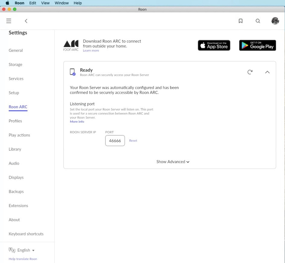

Open Roon Remote, and go to Settings > Roon ARC. You’ll see a text entry box, called PORT, where you can change the number. It’s probably set to 55000 or a similar number. Try a different number in the range 49152–65535.
OK thanks
Right now it’s on 55000
I’ve changed and seems to work at least while at home, I’ll tray it on the road

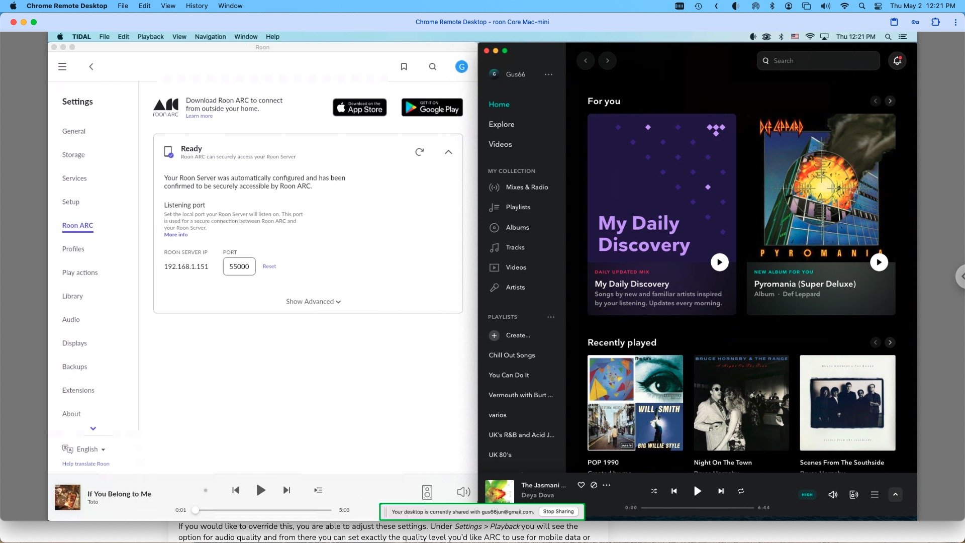

In Roon Remote under Settings > Roon ARC, check that you see this, i.e., Roon ARC can securely access your Roon Server.
PS. I removed your email address from the image.

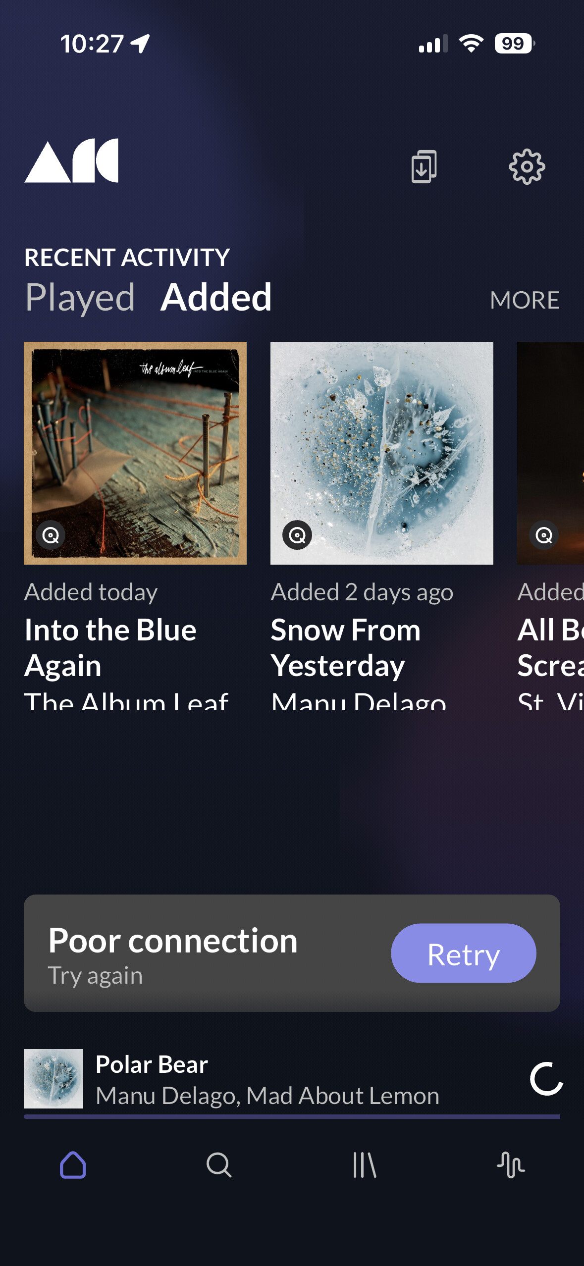

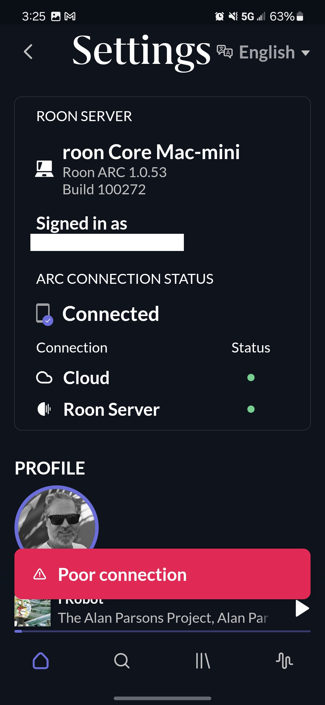

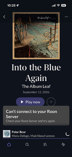

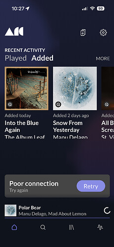

Today after listening via ARC for 30 mins I had a temporary break (to have a coffee) and when I tried to start playback there were connectivity oroblems even thought wifi & mobile signals were good to excellent. Playback using plexamp worked perfectly. See screen shots for errors…
EDIT; Forcing closing & restarting the iPhone didn’t resolve the issue.
That was the same kinds of messages I was getting

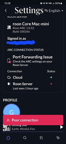

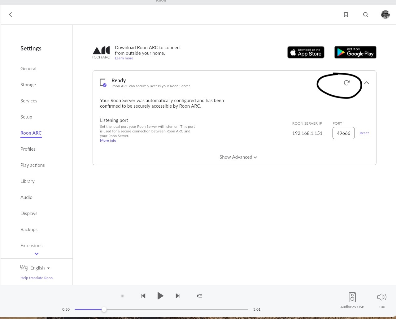

Finally, I went out to test it and it worked for one leg of my drive and after 2hr disconnected, roonARC never came back to work
Only till I get home and refresh the roonARC settings
This was as soon as I left home in the morning
This one when I tried to reconnect
This one after refreshing the roonARC settings back at home
At this time I guess the issue is that port forwarding in the roonARC settings has to be refreshed every now and then

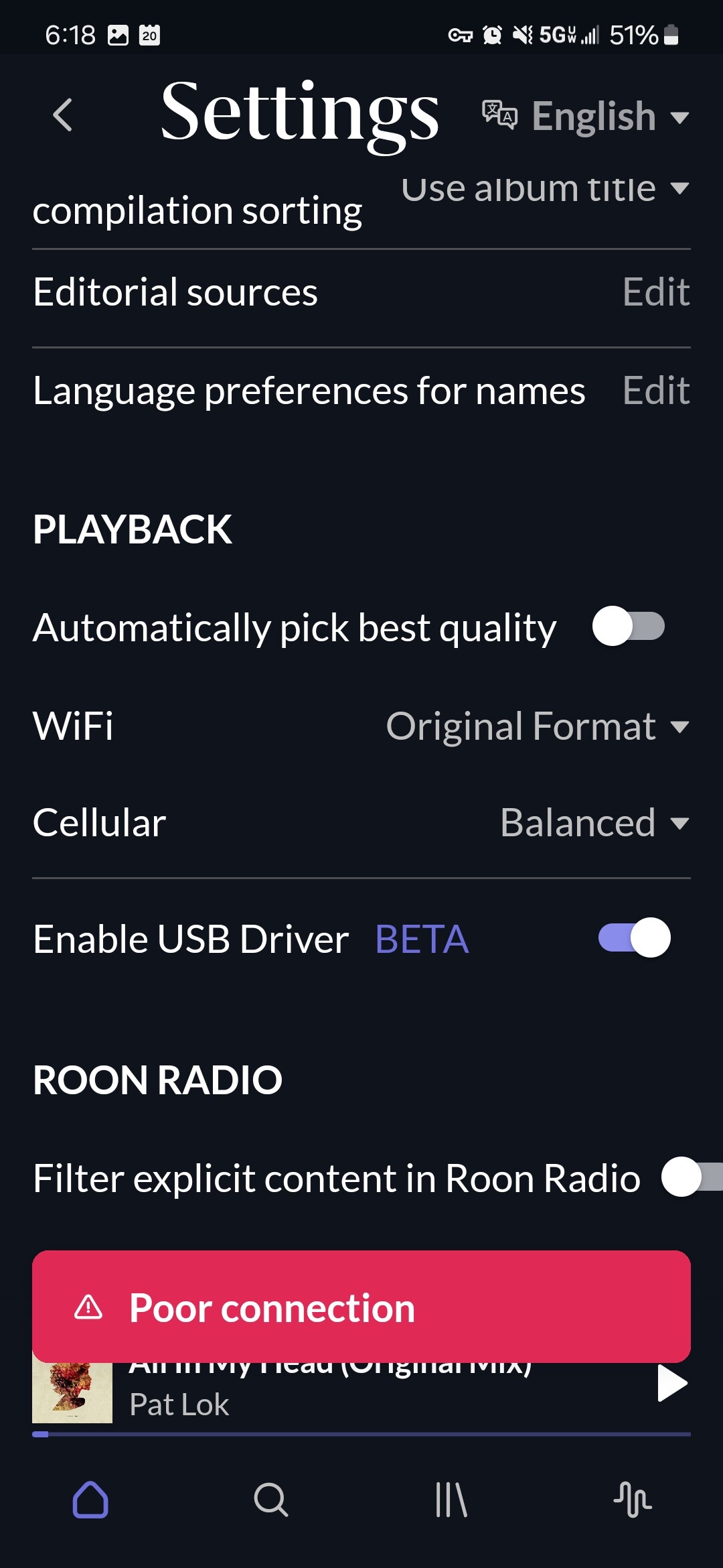

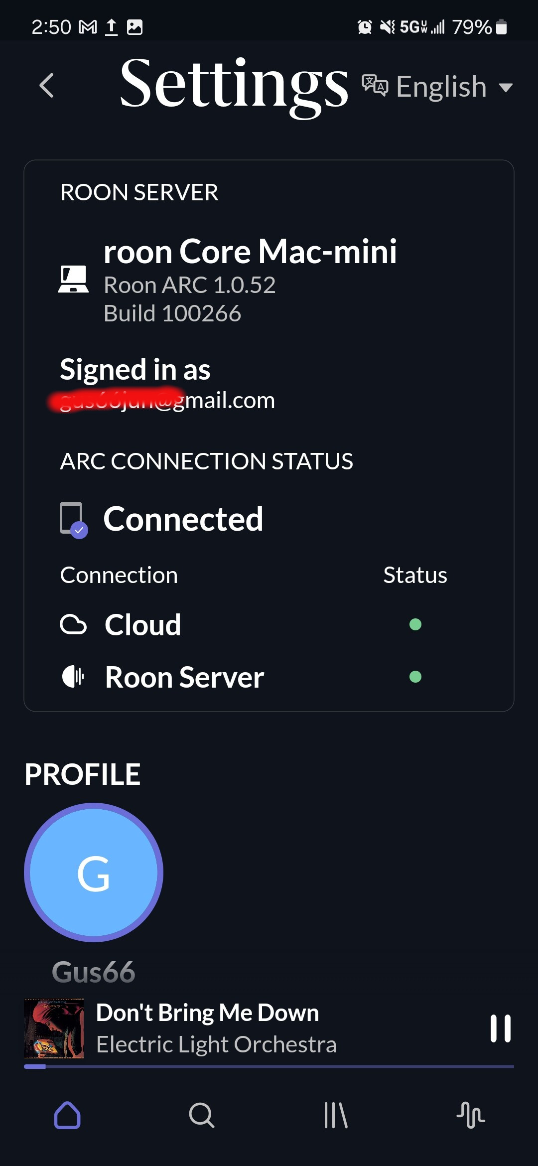

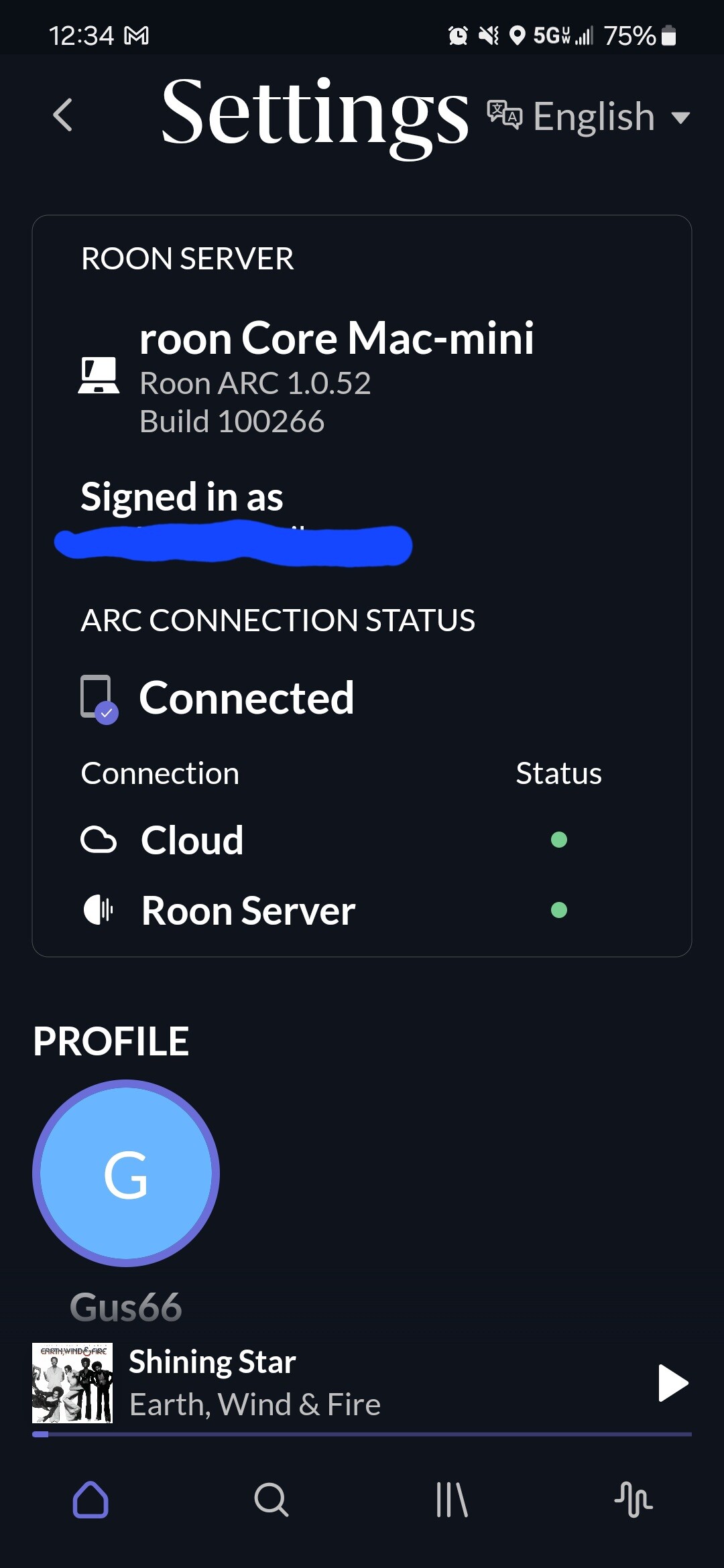

I’m only able to listen to one song each time I open roonARC (regardless WiFi or DATA) it looks like it only plays what is in “buffer” or something

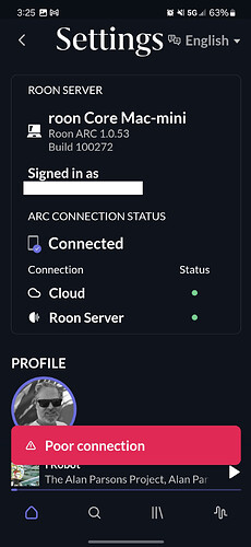

roonARC is READY (see attachment)
Connection to roon server shows working
After playing one song it gives me the same message as from the beginning (see attachment)
This capture is while I was on 5G but I get the same message over WiFi

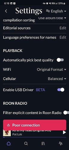

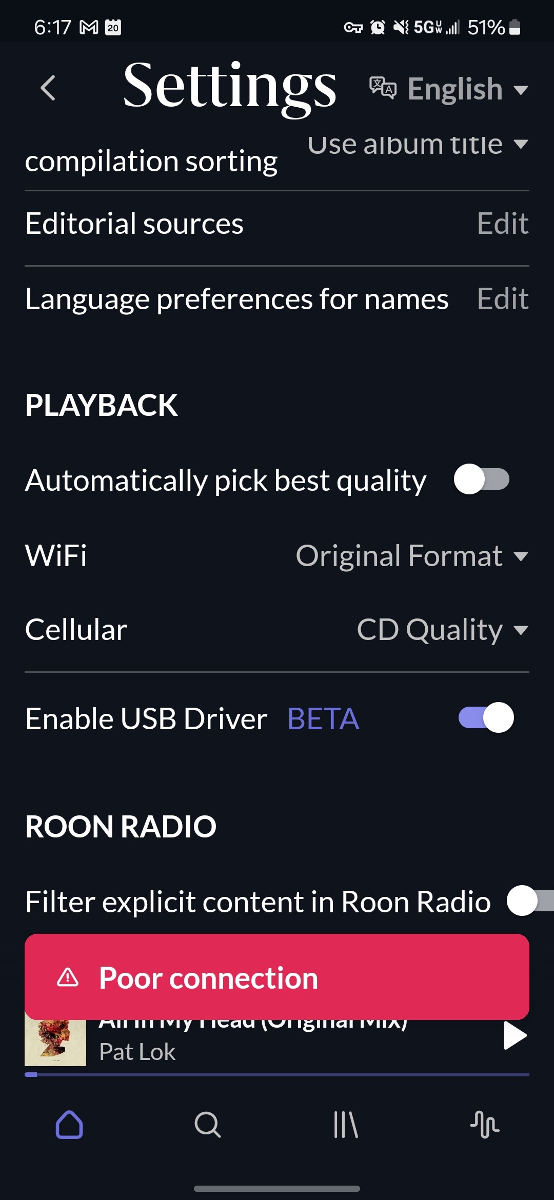

And while I was finishing this post I was playing with settings on roonARC and all of a sudden, it started working in 5G
So with all excitement after listening 4 songs in a row, I said to myself I GOT IT!!!

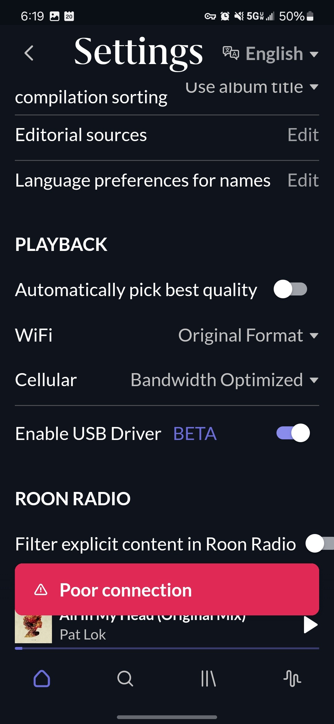

NOT So fast (roonARC answered) while I continued playing with different settings changing “Automatically pick best quality” on and off and when off changing settings for wifi and Cellular and also changing WiFi and 5G but in the end, it was just a stroke of good luck and it returned to be as unreliable as ever

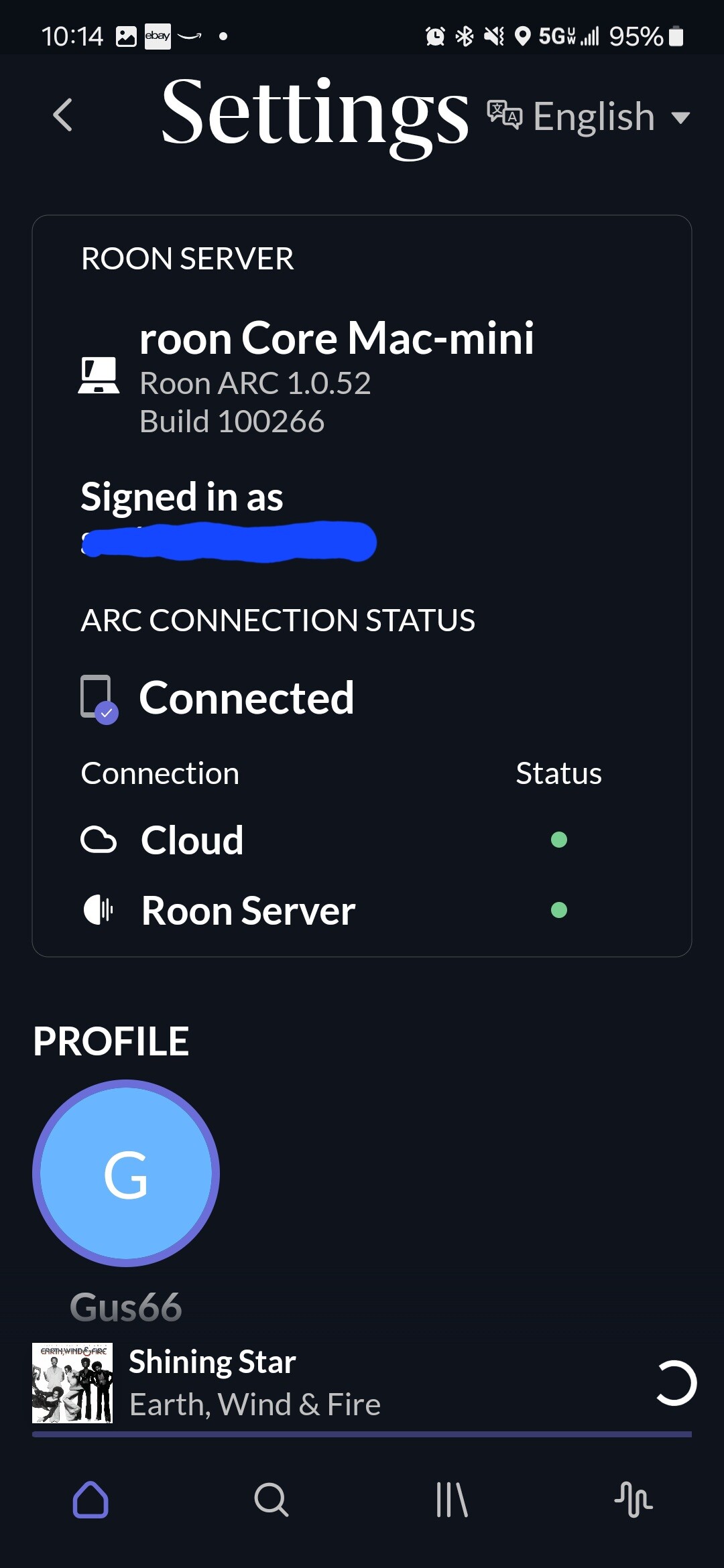

Well! I followed instructions and installed Tailscale and it was as if nothing changed I didn’t get too far, I was able to play 2 tracks and when I tried to play the third I got the usual message
As you can see I tried several settings on my roonARC app but nothing
