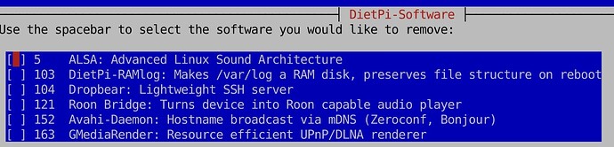

No, not Samba, but it might be a dependancy for GMediaRenderer:
I used to have that on my Pi3B+'s as well, but recently removed it.
(I occasionally use JPLAY for playback)
They are all om Trixie btw, and up to date, 10.6.2
