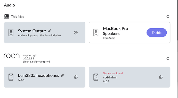

The Raspberry Pi came up in Settings>Audio as a device.
Attached is an image of that page.
However, its zones are mysterious. I don’t recognize them,
and can’t use them. I can select the ‘headphone’ as an output that
roon shows as playing, but don’t know where it goes.
So we still have some work to do.
I did not find anything in the router pages about multicasting.
Here is the view of the ‘Audio Page’

card 0: sndrpihifiberry [snd_rpi_hifiberry_dacplus
The specific DAC will be different, but you should see something that you recognize. If not try a different USB cable and/or make sure that your external DAC is powered on. If Linux can’t see your DAC, Roon can’t either.
David, that was very useful advice. the command showed nothing related to hifiberry. It did show the 2 mystery audio zones that had showed up in the reinstall of Roon. One was the raspbery pi hdmi port and the other it’s audio 3.5 jack. That inspired me to attach the Pi to my other DAC and bingo, it came right up in the aplay -l list. My Roon can play through that and the path Roon displays shows that it is going through RAAT on the Pi – so the RoonBridge on the Pi is working well. The problem must be either the HiFiBerry hardware or some software it’s missing on the Linux. There is a HiFiBerry support page about this: https://www.hifiberry.com/hifiberry-dac-software/ – which recommends adding these lines to /etc/modules:
snd_soc_bcm2708_i2s
bcm2708_dmaengine
snd_soc_pcm5102a
snd_soc_hifiberry_dac
However, after reboot, that didn’t fix the HiFiBerry not being seen problem. Unless some can contribute some insight about that, this topic can be closed. Thanks to all.

chmod u+rx ./check-system.dac
./check-system.dac
We’ll keep this thread open until we can confirm that RoonBridge isn’t misbehaving during device announcements, but the evidence points to a driver loading issue at the Pi → Berry USB stage, rather than the network path between RoonServer and RoonBridge.
We’ll watch for a response! Please upload a fresh set of RoonBridge logs at your convenience, as well: Log Uploader
