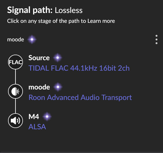

  2. When the issue occurs, what does Roon’s Signal Path show? Can you share a screenshot? Does the same behavior happen if you plug the Motu into the Windows 11 PC and output to it via Roon?
2:
εικόνα
Another user here in community says that roon send signal to chanells 3+4.
Windows don’t do this.
