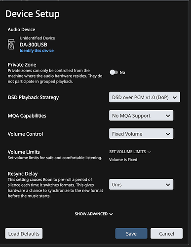

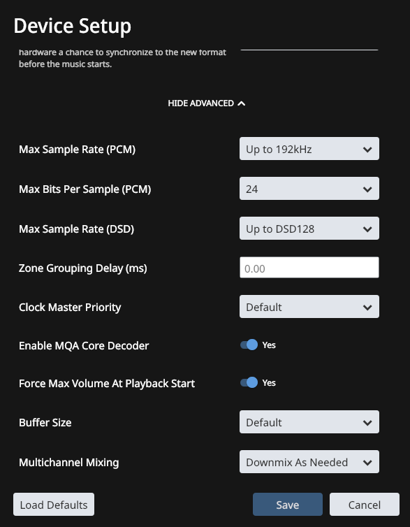

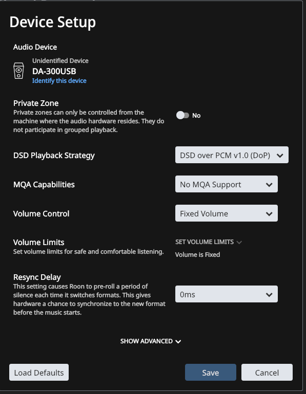

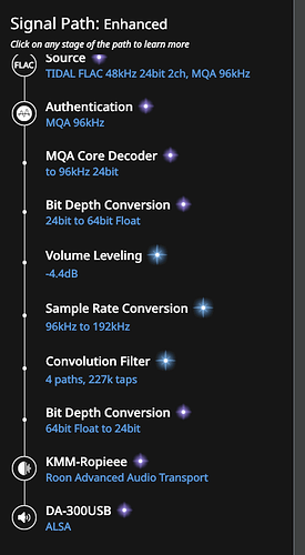

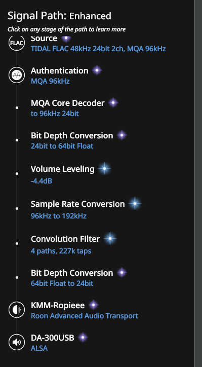

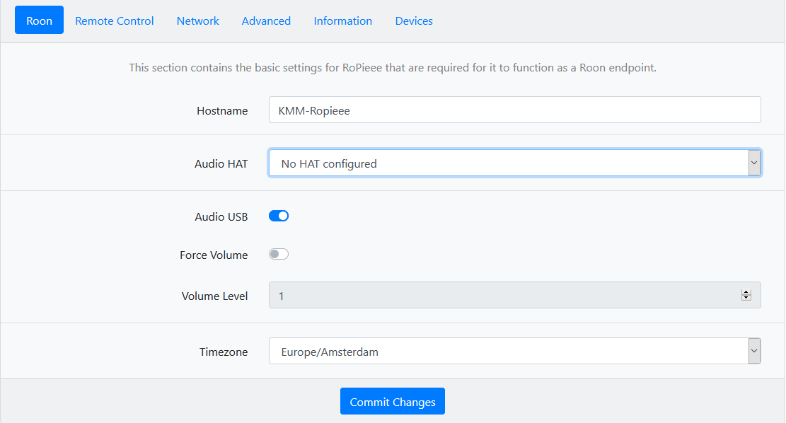

Here are my settings if that is of any help. Roon core to Raspberry 4GB, then via USB to Denon DA 300.
Up-sampling set to 192 kHz which equals the max. the Denon will accept via USB. No issues whatsoever.
